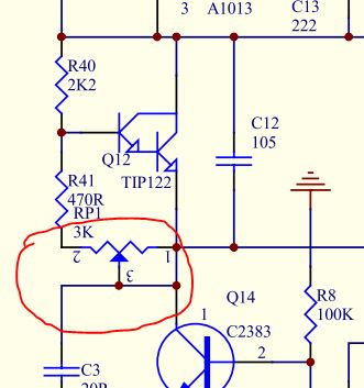

The final step is the bias setting... You want just a few milliamps of current in the output stages with no signal coming in. This prevents increasing distortion at lower levels, called a "Crossover Notch". Sadly there is no spec for this so we're going to keep it very conservative...
No inputs, no speaker, volume at zero...
Connect your meter across one of the 0R33 resistors (R44 or R45).
Dc voltage scale on your meter.
Now turn on the amplifier and get a voltage reading... it should be in the area of 25 millivolts.
Now check everything to be sure it's running nice and cool. Then let the amp idle for an hour or so and recheck your reading... it should be stable.
If all that is ok, you're done.
If you are getting less than 20 or more than 30 millivolts, you will need to adjust RP1 for 25mv. then repeat the set and check a couple of times to be sure it's remaining stable.

Ok, given that the amp is now out of protection, we can stop worrying about D16 and it's buddies. That was just a check to see if it thought it was pulling in the relay or not.
For the measurement on R44 or R45 ... this is not a to ground reading. It is a reading taken directly across the resistor itself. What we are doing is checking current by reading voltage.
For example...
If we have a 10 ohm resistor with 6 volts across it. Ohm's law tells us that I = E / R == 6 / 10 == .66 amps is flowing.
Conversely in an adjustment scenario if we want 0.6 amps we can calculate that we should see E = I x R == 0.6 x 10 == 6 volts.
So, in this case we want some small current flowing something in the order of 8 to 10 milliamps we can calculate E = I x R == 0.010 x 0.33 == 33millivolts across that resistor.
To be a bit conservative without the service manual to guide us we go for 20 to 30 with an ideal about 25 millivolts... read directly across the resistor leads. We sell it a bit short, because we don't actually know the design parameters.
If you are outside this range there is a trimpot on the board, RP1, that should let you adjust it.

I measured across each resistor R44 and R45. It kept slowly rising (same reading on both transistors) and when it hit 100 mV i turned the amp off.
Should I still try to adjust with the trimpot? Or should I check something else before I adjust?
At 100 mv a0r33 resistor is passing : .1 / .33 == .30 amps ... that's 300ma way over our goal of 10 ma.

Try cleaning the trimmer with a bit of rubbing alcohol, spin it end to end a few times and then let it dry... then try it again.
When you put in the new outputs did you use heat sink grease?
Are you sure the new outputs are correctly mounted on the heatsink?
Check the new parts you put in... are they hot?
How about the drivers right before them in the circuit?
What is the DC offset doing, is it drifting too?
Some parts to check ...
D7, D8, D9 and D10 ... make sure they are still diodes
Q7 and Q14 ... make sure they're not heating and not shorted.
Q12 ... Monitor the voltage from it's collector to emitter and see if it's creeping up and be sure it's not heating.
Check the voltages across r26 and r27 ... they should be stable and pretty much equal.
Tests like this should really be done on reduced voltage rather than risk frying it again... I don't suppose you have a variac or dimbulb tester, do you?

I did not adjust the pot, yet. Since the reading is 4 times the expected value, I figured that something else must be wrong.
This is a sealed multiturn trimpot, with a little screw on top. I don't think I can apply alcohol to the inside (tried this before on other sealed pots with little hole in it. didn't work)
