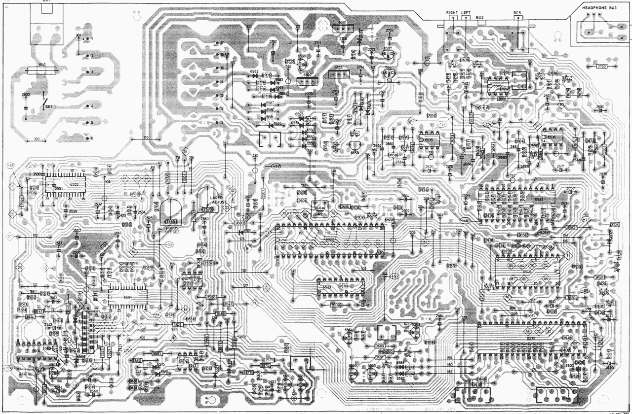

A manual is pretty much essential tbh. You might get lucky trawling all the Philips models of that era because that main PCB is almost certainly from a standard player.
If you can still get it to spin up and read the TOC or play even for a second or two then that's enough to look at the RF on a scope and make a judgement call on amplitude and quality.
One of the pots will probably be laser current, the other perhaps some offset adjustment related to the servos.
*edit*
Thanks ahiukka! that is in fact the player I was looking for! A CD482 was pretty close as well but had a different DAC TDA1543 I think.
I was also looking at the data sheet for the TDA8808 to see where I should attempt to grab a signal from if I can get the player to read a disc again.
Pin9: FOCstart Pin16: FElag Pin18: LM which has the "monitor photodiode" Pin17: is LO which goes to what looks to be the CCS driving the laser diode.
