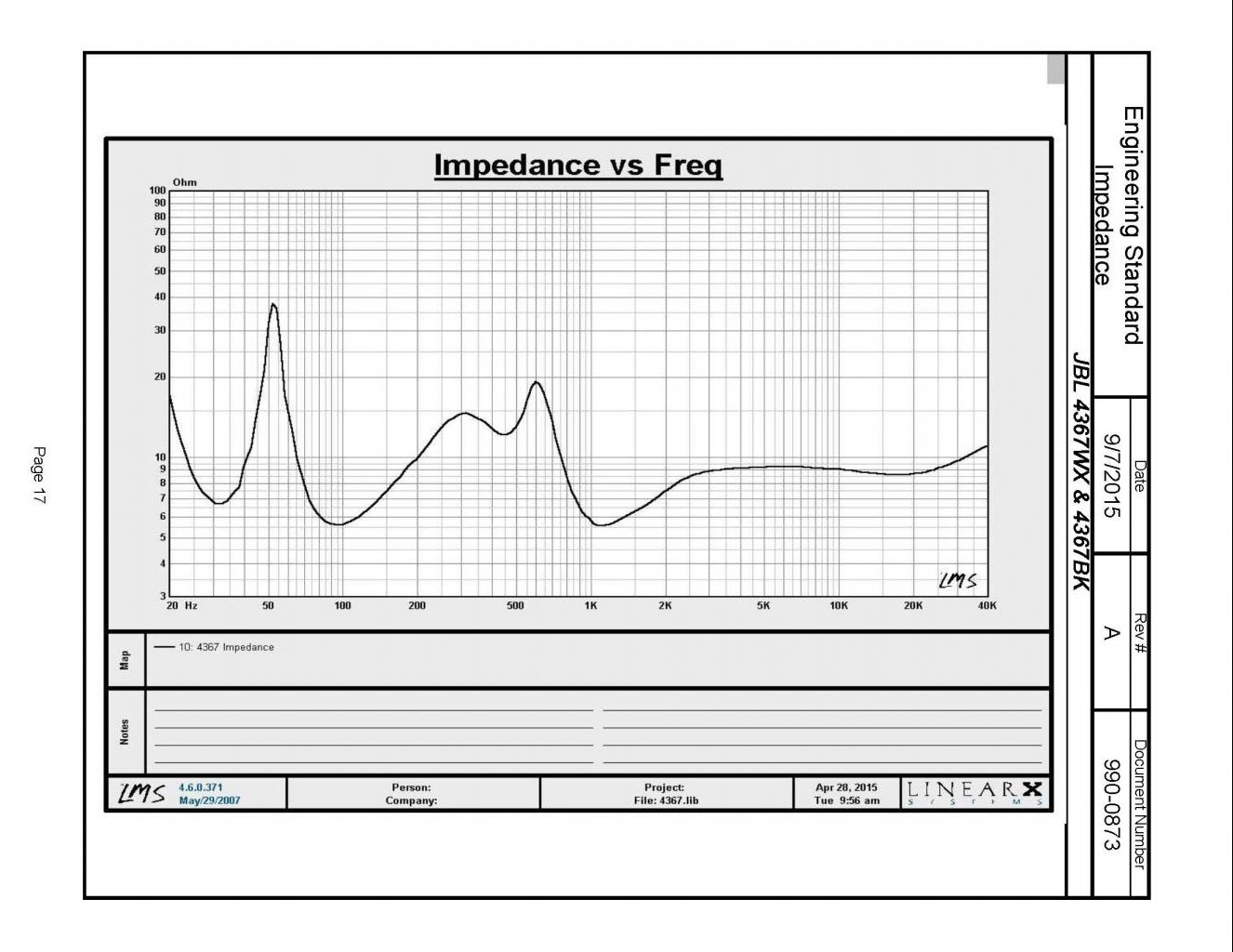

The JBL 4367 cabinet (where the 2216ND-1 is used) is way smaller than the QBB4. From the 4367 dimensions, I estimated it to be less than 5 ft^3. Is there something JBL knows? or is it just a marketing decision to go with a smaller box as a compromise?

JBL's White Paper on the 4367 gives its frequency response curves and impedance plots, so you can see perhaps a little more about what design choices they've made - you could then simulate to see how closely you can match that using the T/S parameters you have obtained.
Might help by giving you a reference for what they have considered acceptable at least.

Reading this has me scratching my head. I know the main difference was adding 10 grams of aquaplas and lowering FS to 28Hz. They must have changed the suspension as well as I don't think that's enough mass to make that large of a change. I found a much cleaner version of the Imp plot for the 4367 and Fb in that box is 32Hz judging from the min between the peaks. The box sizes here seem to big compared the JBL box volume Fb and F6 of 30Hz. You might want to just clone the box and tuning or try a test box before you cut wood.

the T/S param I got is from another person's measurements.
4367 is only 4-4.5cu ft net which is pretty small. they might have made some compromise to make it home friendly.
