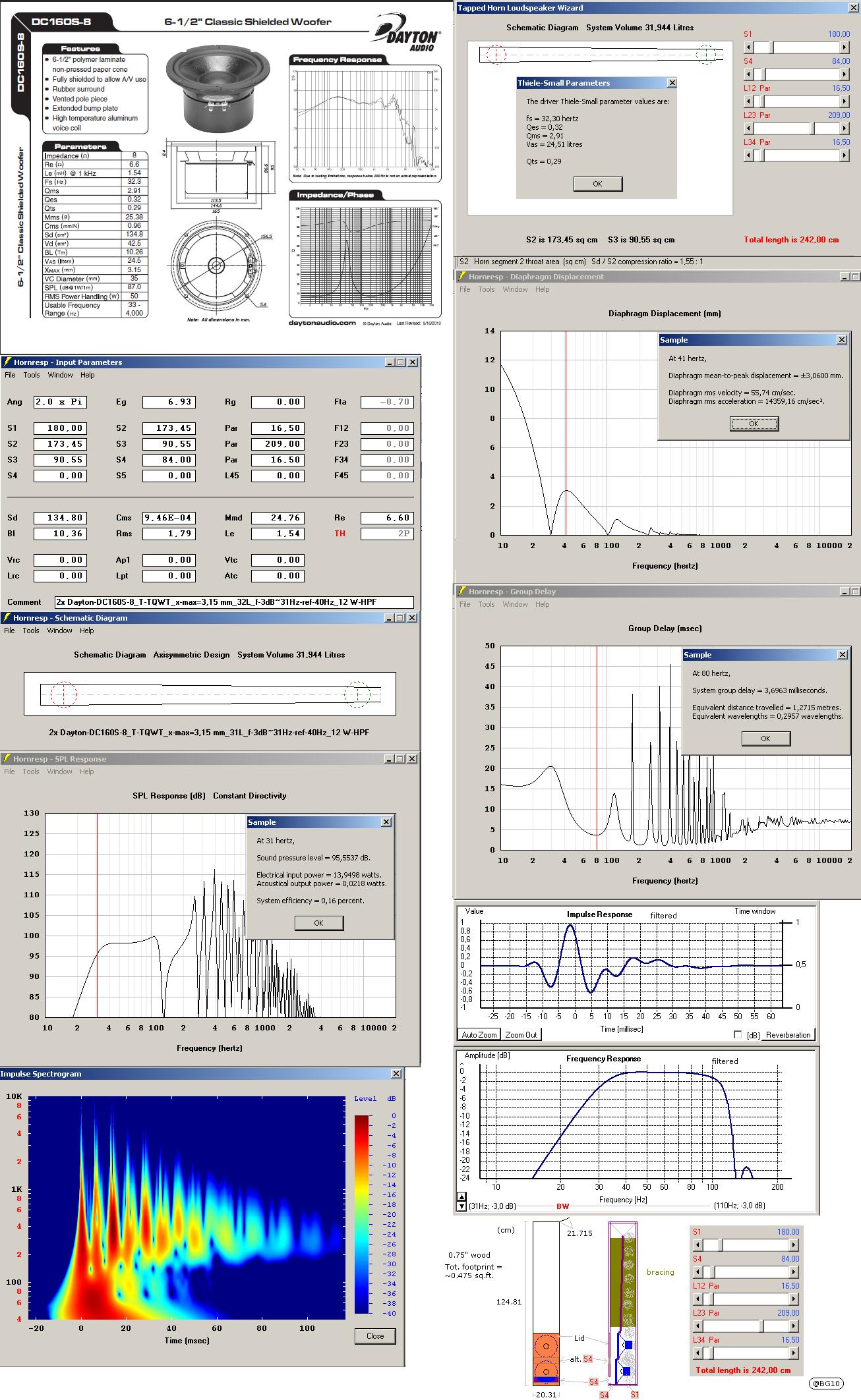

Trying to figure out how to get this less boomy...
Ok, so I started from a Klipsch Promedia 2.1 system -- though the only recognizable components are the control module and the amplifier (which isn't even visible normally.) I've changed the mid-range drivers among numerous other things such that it's no longer really even the same system. I'm extremely happy with the mids and highs from the system now, but I'm still having trouble with the lows. In particular, I'm sick of getting boomy sound and want a relatively flat bass response for music listening (I could not care less if it sounds bad by some people's standards in movies or something, music is the key here. For that matter, I don't really even watch movies anymore...)
The first thing I did was to try to switch to a properly sealed enclosure. I built a new box using 3/4" MDF. At the time I had no idea really about all of this, so I started out with an enclosure that would have the same internal volume as the original (but then the original was vented, so this perhaps wasn't the brightest idea.) This did seem to help a bit though as the original sound was just awful. I next tried getting a different driver. Due to rather severe budget limitations I decided to try the Dayton Audio DC160S-8 6.5" driver. It does appear to be better than the original at least, but still a bit boomy in some things with a lot of a bass guitar or certain drums.
download the freeware WINisd pro.
Look at what a sealed Qbox=0.7 response looks like.
Now compare your drivers and enclosures to the Q=0.7 response.
If your Q>0.7, then that will give bass emphasis to a narrow range of bass frequencies.
The higher the Q the worse this problem gets. Many manufacturers design in a high Q to give bass emphasis instead of bass extension. They are terrible to listen to.
Q<0.7 can sound a bit bass light, (the response rolls off very gently and early).
I was advised to look for a vented enclosure tuning that very roughly copied a Bessel function (Q~0.5). This when in room produced deep strong bass and did not sound light at all. More importantly, it did not have bass boom, nor one note bass, nor that male voice with bass emphasis.
First things first. Pack the box full of insulation and try it again. If you use fiberglass or rock wool it doesn't hurt to have a piece of cheesecloth or an old pillow slip to cover the back of the driver first. Also, your .1 amplifier likely has a bass boost feature that you might want to override if the insulation trick doesn't work. This may require help from someone with a schematic and a little experience.
Sorry, I know I tend to post very long posts. I did say that I have filled it with fiberglass. The walls of the enclosure are also lined with 1" Sonic Barrier.
And who might that be? Lol. Does it have such a "feature" though? It seems to me like there's no need for a bass boost when you have an actual subwoofer level control right on the main module. If you want more bass you just turn it up, right? Regardless, I don't know of anyone who could provide such details. I do wonder about this though as it could perhaps explain the issue.

I don't think you are going to get any further with the 6.5 inch driver, it's just too small.

Hmm. Realistically speaking, how might this one do then? Dayton SD270-88 10" Shielded DVC Subwoofer | Parts-Express.com Great price and I see one reviewer saying that they get good results down to 40Hz out of it. Apparently the recommended enclosure size is just about the same as what I ended up with (though I see reviewers saying that bigger is better unsurprisingly enough. Well, I'll not be taking the fiberglass out, so that should help a little bit at least.) Do you think the little amp in this thing that was originally built for that probably dirt cheap 6.5" subwoofer driver that came with the system could handle this (bearing in mind that I'm going to have it turned down pretty low since I just want it to work with the music, not shake the building)?
It's no good for your intended use.
How many ohms is the stock (sub)woofer ?
You need a driver that is the same impedence to get the maximum power out of the amp.
The amp puts out only 50W at 7% distortion , according to the "repair link" posted previously.
So in reality, you are probably looking at like 30 watts or so at a reasonable distortion spec. Just a guess.
Get the highest efficiency 12" driver you can find that is the proper impedence. This will relieve the bass amp from being overdriven , as the driver will require less power to achieve good output levels.
This is what you need to achieve the goal with your specific needs in mind.
Look at Eminence Alpha , Goldwood PA drivers, etc. High efficiency, higher Qts, low cost. These are 8 ohm units , you may need a 4 ohm driver. I would have to look around , as none jump to mind.
Roughly 40hz tuning with a simple sealed cabinet. A piece of cake.
Find out how many ohms the stock woofer is and let me know, then I can recommend a suitable driver.
