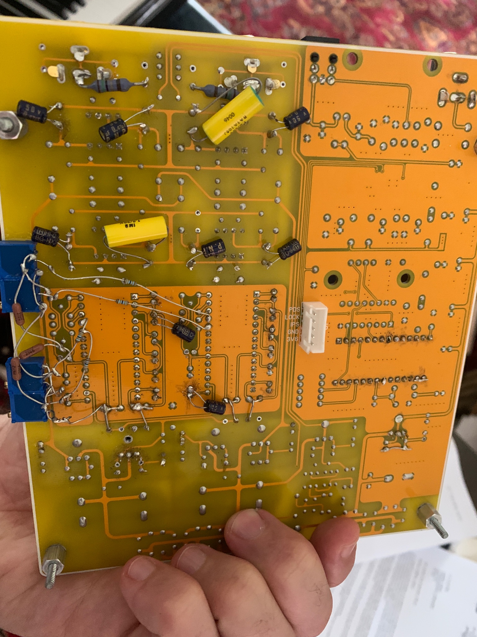

Somehow my module has ak411 something which converts my toslink into I2S.
I was using the upsampler in right justified MSB first, did not work well haha, now back to normal, looks promising.
Looks good... different than the pcm-J... It's kinda ready for a listening, opa604 i/v , op1611 buffer filter!

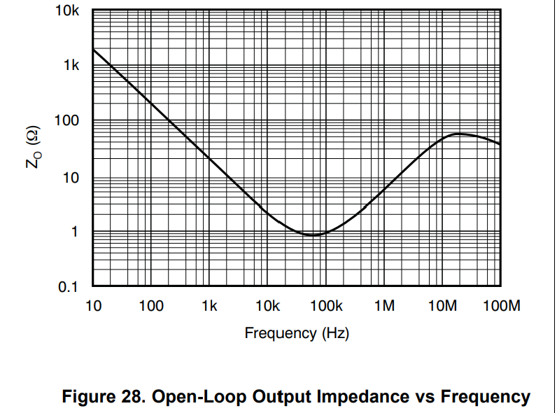

I'm not 100% following what modifications you have done, @gabdx , but what would bother me with using the OPA1611 to directly drive headphones is the huge output impedance variation over the audible frequency range:
This is directly from the OPA1611 datasheet. With a 300 Ohm impedance headphone, you are a factor two down in output voltage at 80 Hz (6 dB, factor 4 in power).
The spec for the NE5534 only says (on page 5 of the datasheet) '0.3 Ohm' at 10 kHz, without a graph, so on paper it should be a lot better for this purpose (directly driving a headphone).

I am running it as buffer, closed-loop , 101 db of feedback.
Z out is basically 0.0000000000000 lol , what set the output Z is only the resistor,
Many headphones amps have a 100, 120R output Z and drive 32 ohm cans.
I looked at many schematics and found I needed 15R.
Thanks! I hope I am right.

Many headphone amps are bad, in that they have too high an output impedance. So you gave up on the direct drive? As far as output power is concerned these opamps should be fine; I believe the HD6-something Sennheisers have sensitivity around 100 dB SPL per mW, so 0.15V output and 0.5mA should give you close to 80 dB SPL, plenty loud.

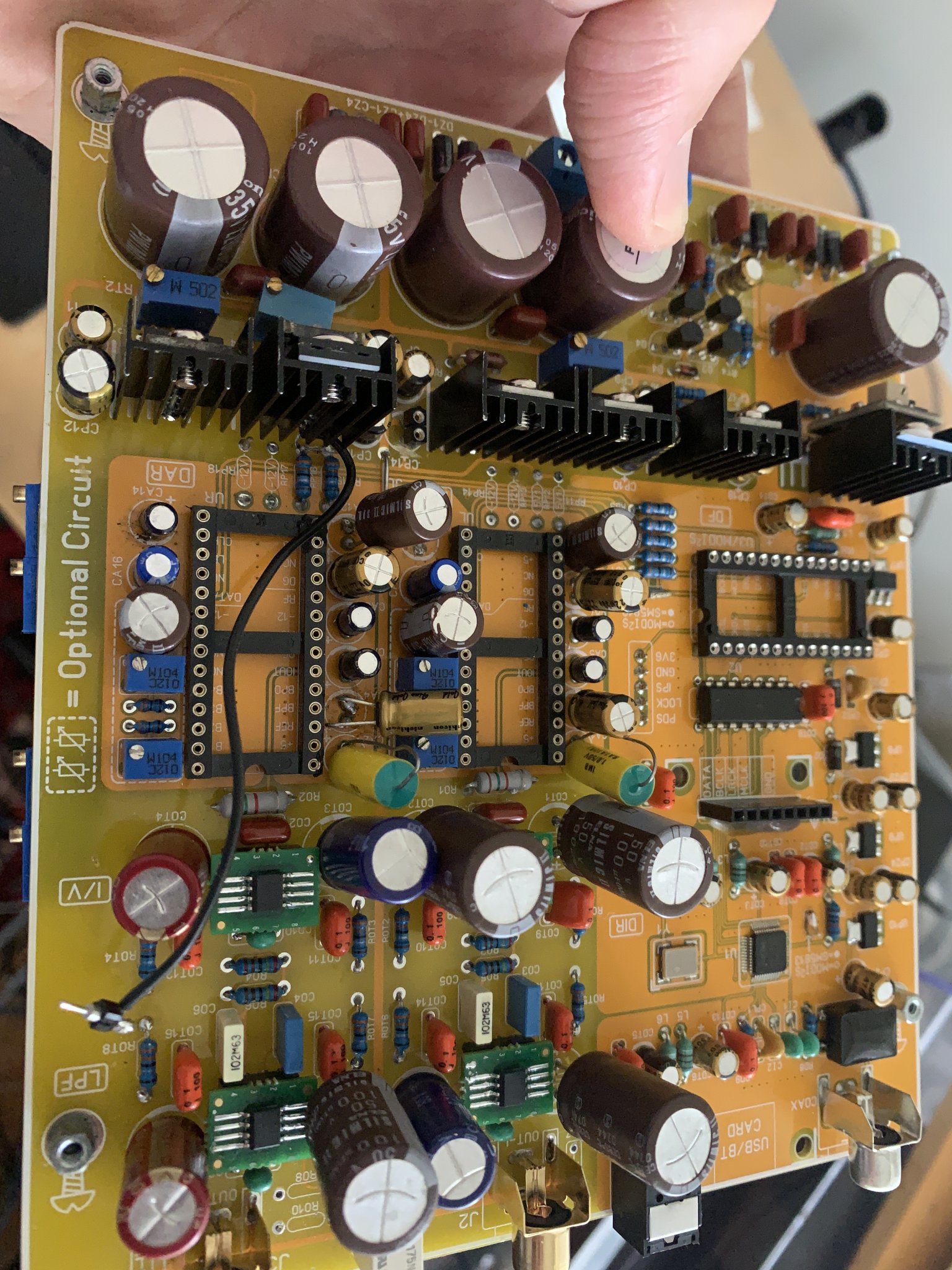

Two hypothesis:
the J is a genuine rare chip with better performances, however it did not performed as well as the modified DAC.
I can rule out the black gates, the special tantalum resistors , the type of IV (MAYBE), but I doubt, ill clear this one of the equation too.
The PCM K looks genuine but the K could have been faked, we will never know...
What is sure is that something is making that new board sound superb, and it could be the regulators. It has special dedicated external unit following the LM33x, and the -12V is also a very costly regulator.
The digital side has an extra custom made pre-regulator replacing the LM33x and I adjusted voltages higher.
Maybe it is only the Digital filter which is way superior to the 1704?
I bet it is either the filter of the power supply.
Lets listen with plain PCM-J and see if it sounds as good or get better specs even!
