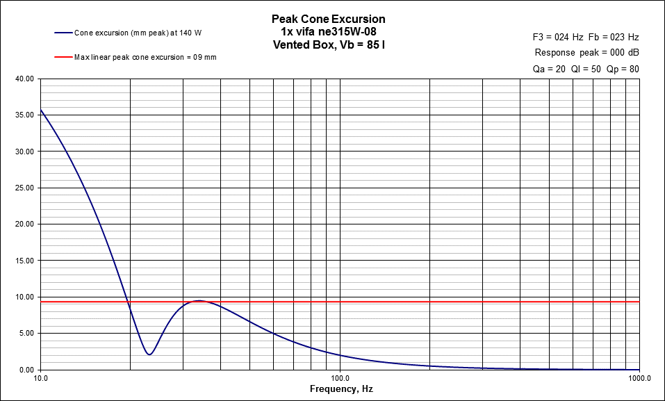

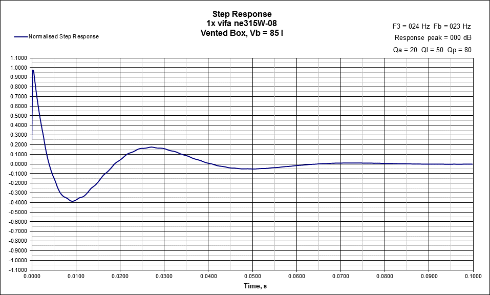

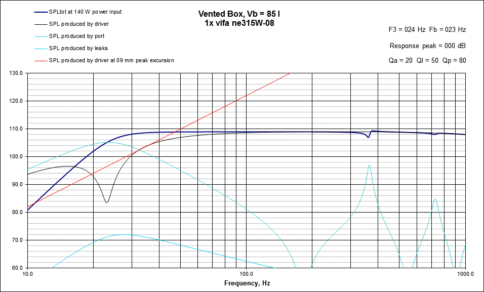

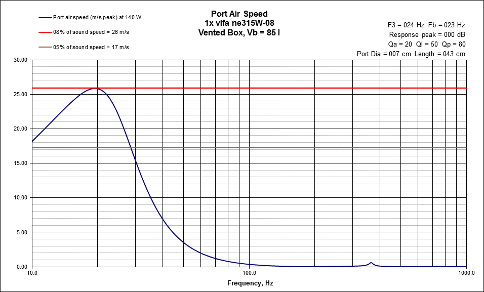

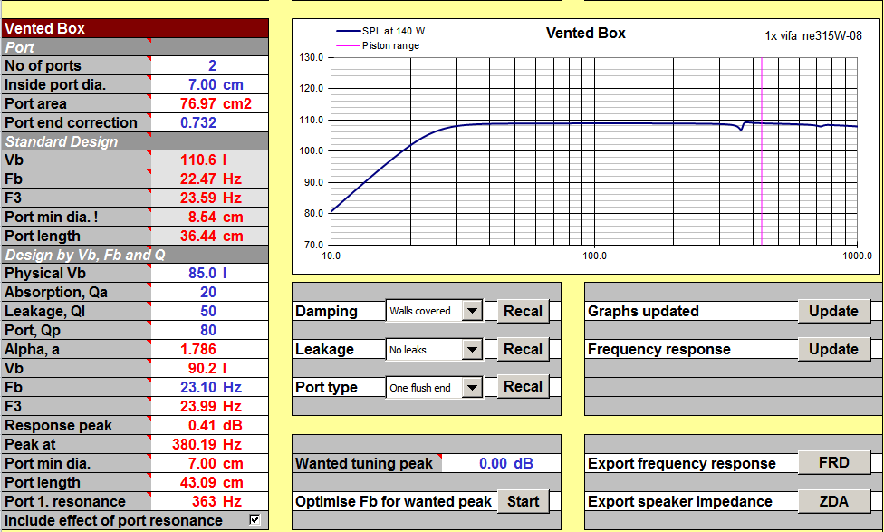

It might be a bit above the price range but this Vifa NE315W-08 12" Subwoofer Speaker 264-1142 models very nicely in an 85L vented enclosure. edit: the slight wiggle in the step response is from the port resonance, but if you cross it over at say 80Hz it should have a minimal effect I would think.
You would want to high pass it at 20Hz. You mention 8.5Hz on some movie tracks, but are there any DVD players that will faithfully reproduce that low a frequency?
just some food for thought :)
Tony.

Thanks, this is very interesting. I'll respond to the note about DVD or Bluray players first, as this is going to be another long one. I've asked Arcam about the frequency limits on the LFE output from the AVR 300. As the link from the Bluray player to the amp is digital (electrical coax) it will be the line output of the amp which will be of interest. Even if this does not have bandwidth down to 8.5 Hz, it may end up being complemented by another DAC at some point, and I'm going to build the sub to anticipate future hardware upgrades I might make.
I have looked up the Vifa NE315W-08 and modelled it both in a 90 litre vented enclosure and also in a sealed box of 50 litres, and compared it to the Scanspeak 30W/4558T00 which I liked from the previous models. Looking at the region below 20 Hz, it is apparent that the cone excursion is uncontrolled below the tuning frequency, so I added a 20 Hz 2nd order filter to stop this so that the comparisons of the peak power when the drivers reach maximum excursion can be meaningful.
Looking at the plots, it is clear that if we limit the cone excursion below the tuning frequency, the model predicts a hell of a lot of bass, and beats the closed boxes down to 15 Hz. I can see why turbodawg and KaffiMann recommended ported designs! Looking at the group delay, I can quite accept that this won't be a problem at less than 30 ms until very low. Whether this is what I need or not therefore just depends on whether I need to get up to 108 db, which I still have not worked out.
Thinking about whether I could improve the low frequency end I've also tried lowering the tuning frequency for the ported design to see if I could leave off the high pass filter at 20 Hz. While I was reading the material about Audibility of group delay that turbodawg kindly suggested I read, I did come across some discussion about designs with low Q sounding faster and I looked again at why I was using closed boxes with Qtc set to 0.707. This was originally to give a smooth response in the crossover region, and to keep the box volumes smaller. Anyway, if I am looking again at things, I'll try using Qtc 0.577, the value for the lowest group delay, and see how the overall response changes. So, I have modelled the Vifa NE315W-08 again but with the tuning set to 11 Hz, and the Scanspeak 30W/4558T00 in a 100 litre box, and compared them to the two drivers just in 50 litre boxes.
So, looking at the vented design tuned to 11 Hz, the vents need to be 212 cm long. This is possibly something I could get into, but not for my first build, I think! I have seen some subs with great big drainage tubes wrapped round the box, but if the tube gets as big as the sub, is it something else? I have not read up on horns and folded tubes and all sorts of esoteric stuff, so is that where this design concept ends up? Looking at the cone extension, even without any filter, it is controlled to 10 Hz, and the power us up to 120 W.
Looking at the Qtc 0.577 100 litre sealed design, there is a higher transfer function in the bass from 30 Hz down than the smaller box, but the power is now limited to 50 W, so overall SPL levels fall to 102 db at 50 Hz, and the maximum from 10 to 20 Hz is the same as for the 50 litre box. I suppose if you did not need this much volume you might find the lower bass was relatively louder simply because there is less power in the mid bass. Is this important for music or theatre use?

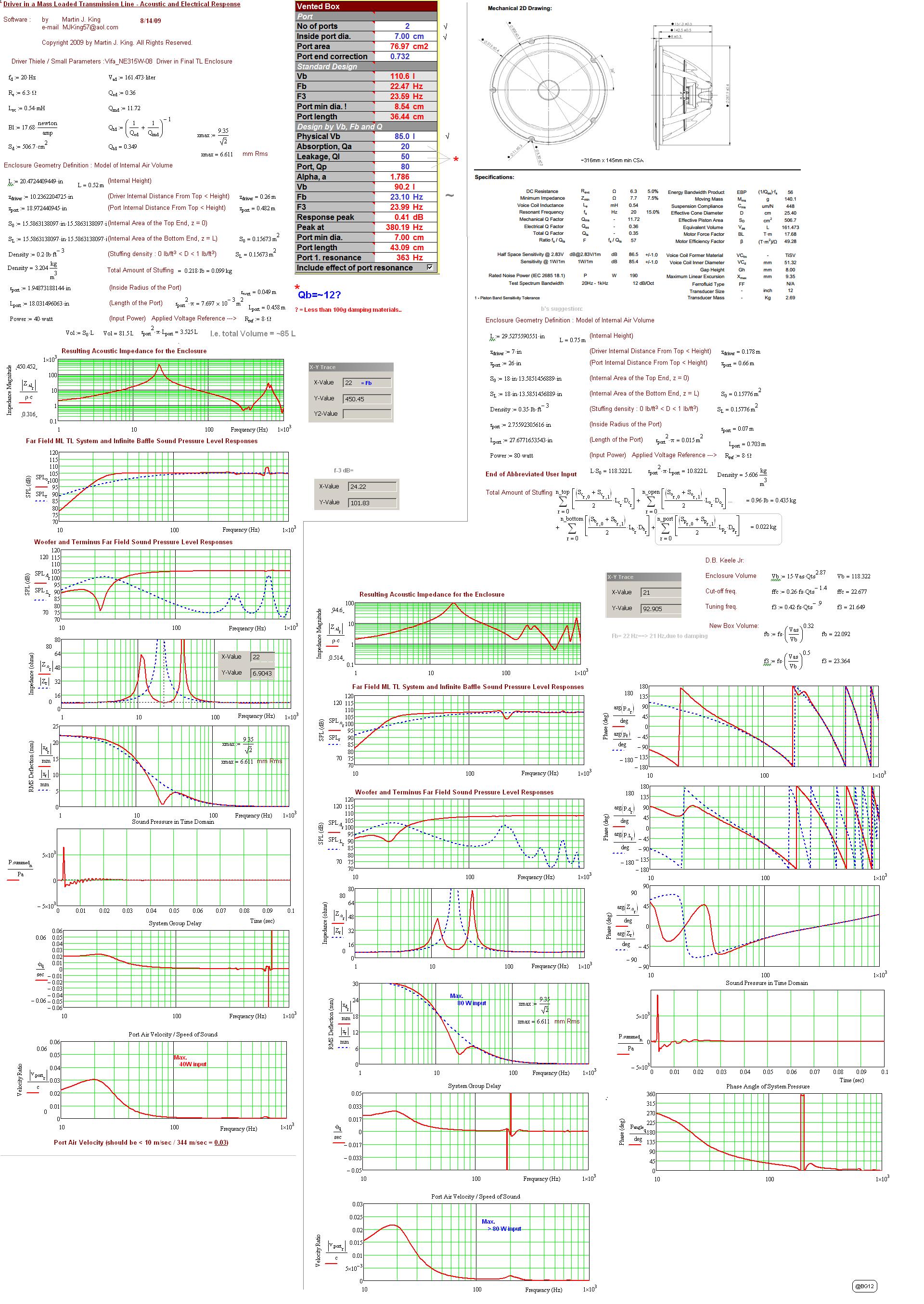

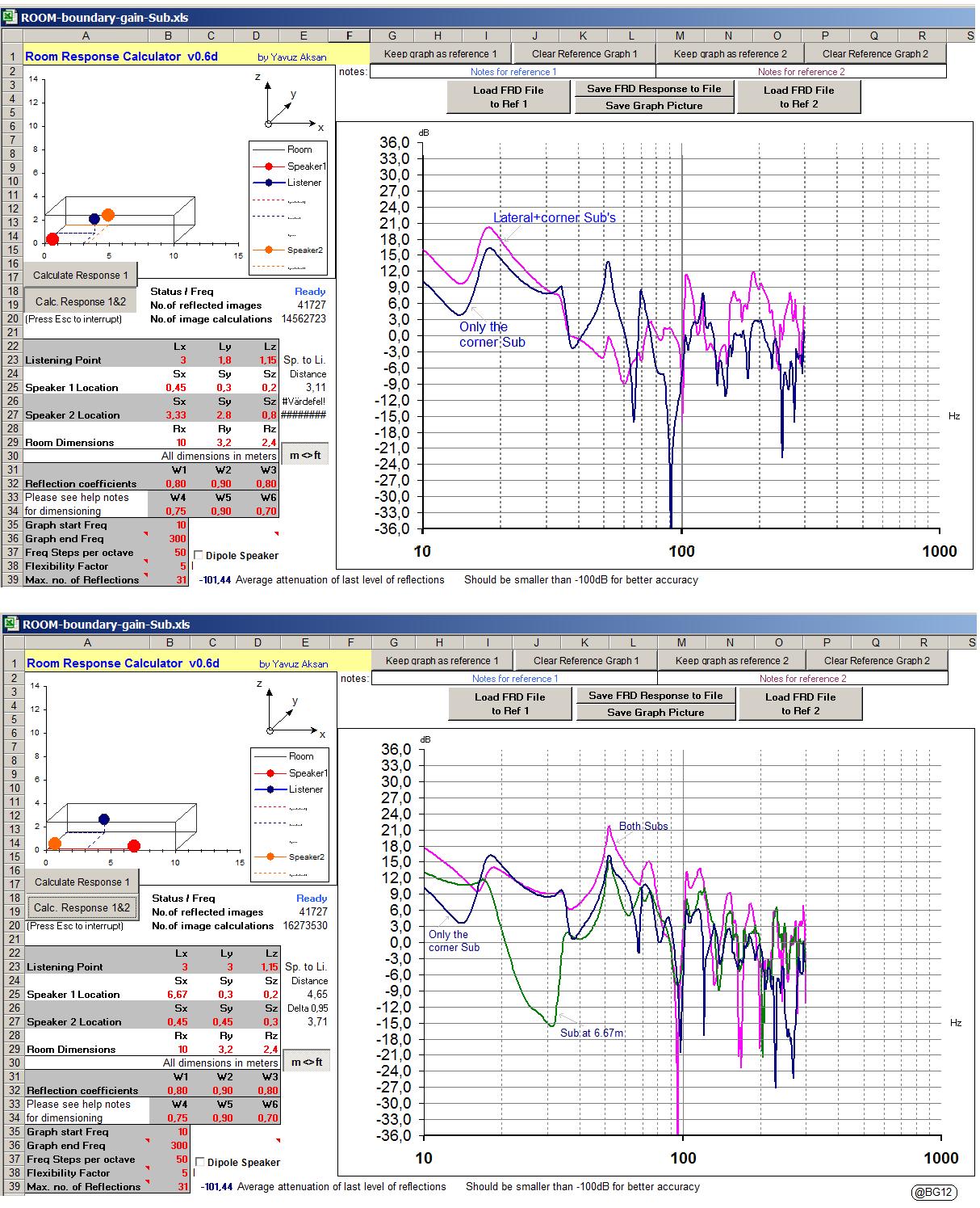

Hi All,Late :2c:
Post#1:
...my room being 3.2m wide, 2.4m high and 10m long. The lowest modes should be (according to Room Mode / Standing Wave Calculator) 17.2, 34.4, and 51.6 and so on down the length, and then multiples of 54 across and 72 vertically...
I plugged in your room into this program and found You need more than one sub to get even FR in the room modal region: See the picture:...and...:
Room Response Calculator - Reflective Accumulation Simulation Software

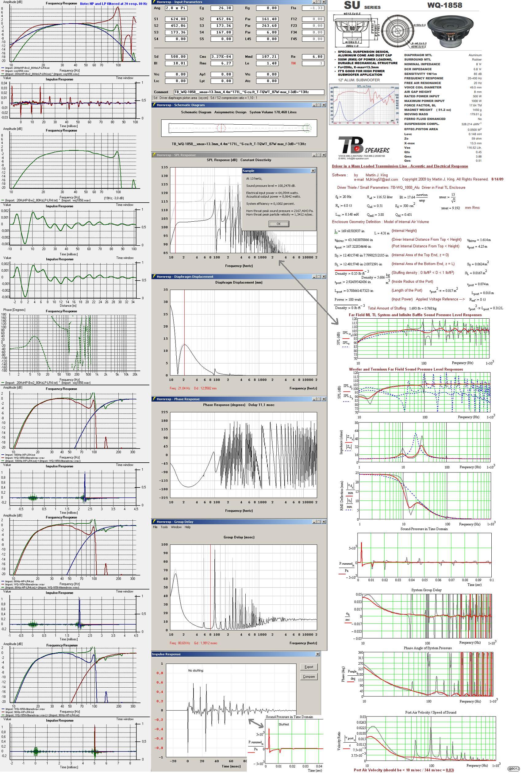

...The Tangband WQ-1858 appears to have a very flat response down into the low end in the recommended cabinet size, which might be a useful thing as I don't know where the crossover will be until I've built it. The measured response at Europe Audio WQ-1858.pdf also looks quite flat in this region from 20 to 100 Hz...
Post#9
...To get the maximum from the T-Rex footfalls scene is exactly what I want from this in terms of extension and volume. If I can get that without sacrificing timing, then I'll be very happy...
The Tangband WQ-1858 is IMO a very good driver and suitable for a main sub that can be integrated with the Mains without the need of EQ's or signal delay units:See the picture
Post#21:
..It might be a bit above the price range but this Vifa NE315W-08 12" Subwoofer Speaker 264-1142 models very nicely in an 85L vented enclosure. edit: the slight wiggle in the step response is from the port resonance, but if you cross it over at say 80Hz it should have a minimal effect I would think...
IMO: The Vifa NE315-08 needs to be reworked:See the picture:
b :)
Hi All,Late :2c:
Post#1:
Thanks for looking at this. I am going to have to work out where to put it with some care, I can see.
As for having two, there's the laws of physics which I try to obey, and then there's She Who Must Be Obeyed. She wins, so I'm going to have one sub, and just try to find the best place place for it!
