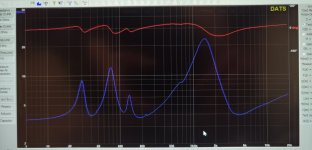

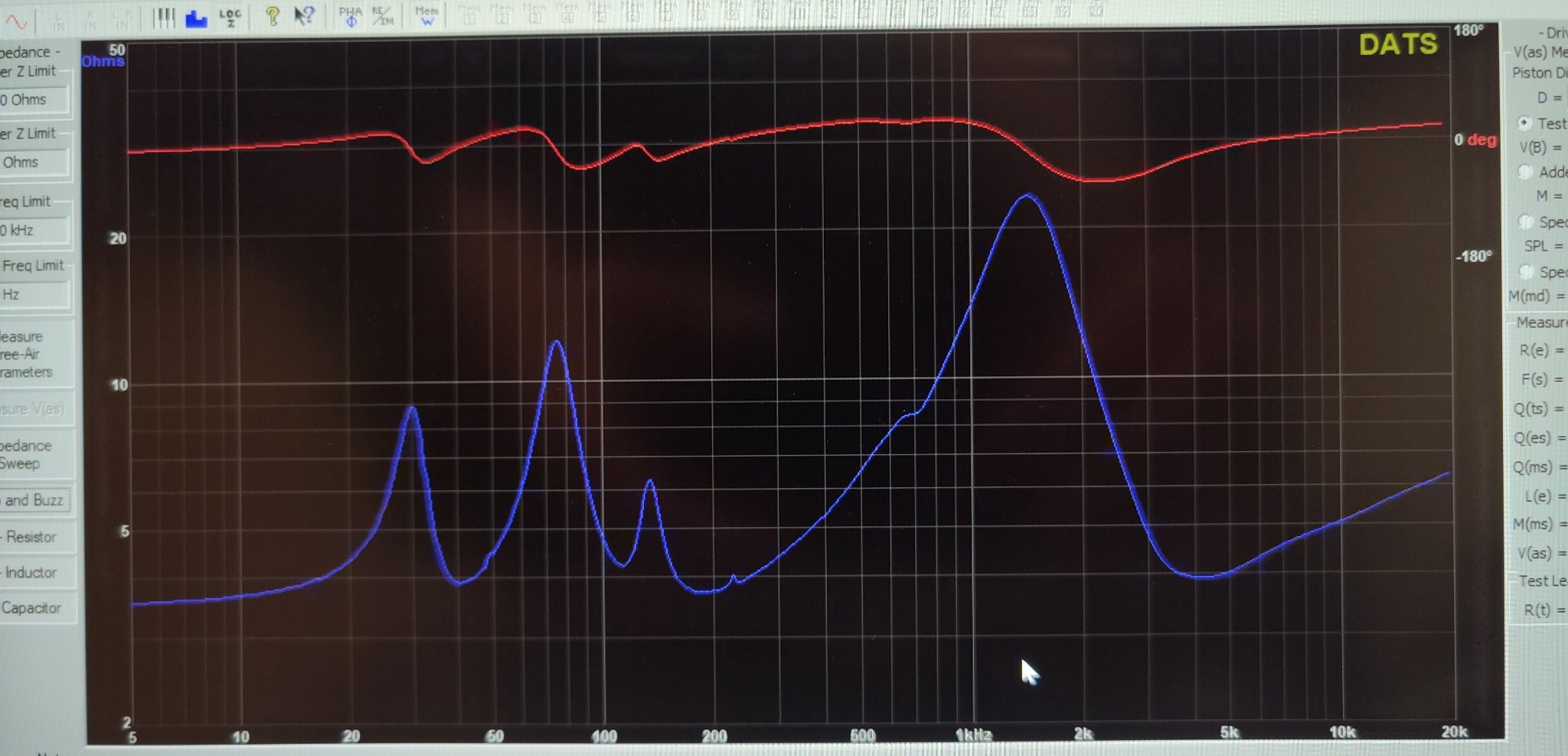

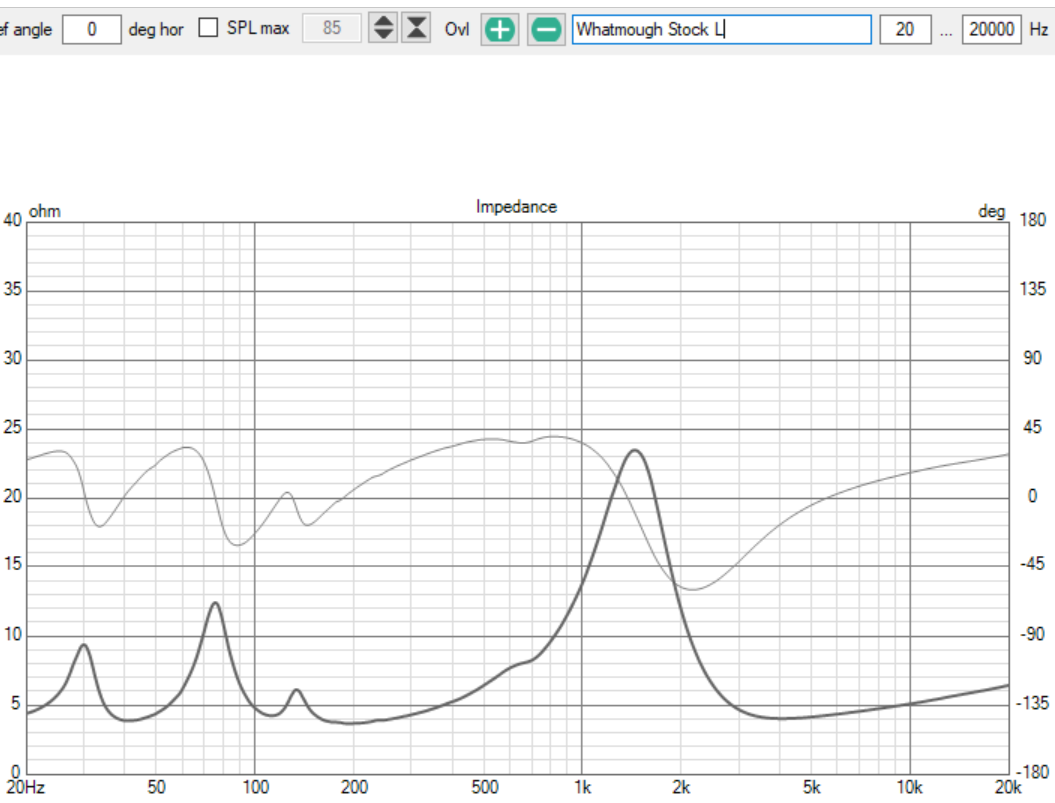

Stock L is with everything installed into the cabinet; impedance of the speakerJust to clarify, the first image is 2 woofers connected in parallel and still installed in the cabinet? Or you have taken the measurement with XO and tweeter connected (guessing this is with XO 🙂)?
The measurement indicates that the Fb is ~40 Hz.
One idea is add a little more Dacron type poly-fill inside the cabinet and see if you can get rid of the third hump. The poly-fill should be well fluffed.

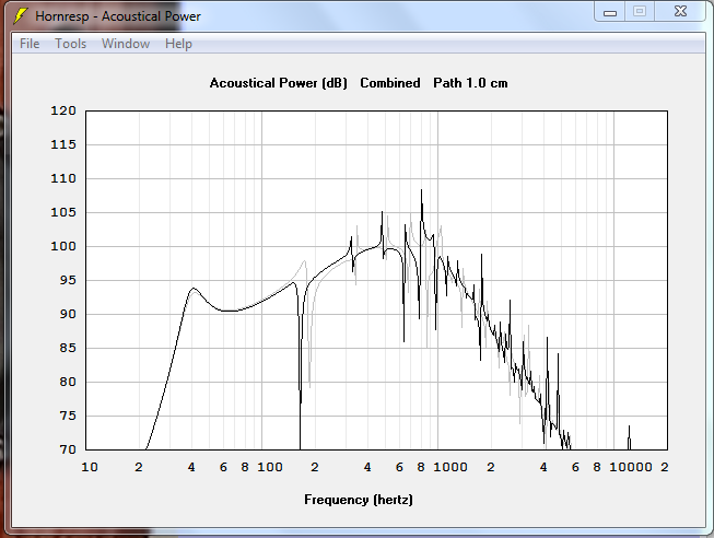

MLTL design from MA website for a single CHN-110:
https://www.markaudio.com/wp-content/uploads/2022/09/Kewel-CHN110-compact-MLTL.png

If the 3rd peak does not disappear with better/more damping, it could be a double chamber design and actually have 2 tunings.

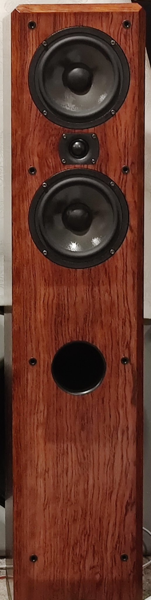

Nothing new yet, I have two driver holes so I'm wondering how these drivers would go if they have to share the 40L.Any progress Rennie on the retrofit?
40 liters is slightly smaller than the 48 liter cabinet in the link above, but CHR-120 might still work; and a Pluvia 11 might be good for ~40 liters.
I can try and look more carefully at the bracing to see if it's anything other than holey cheese, though the little peak was still there with a hand over the portIf the 3rd peak does not disappear with better/more damping, it could be a double chamber design and actually have 2 tunings.
