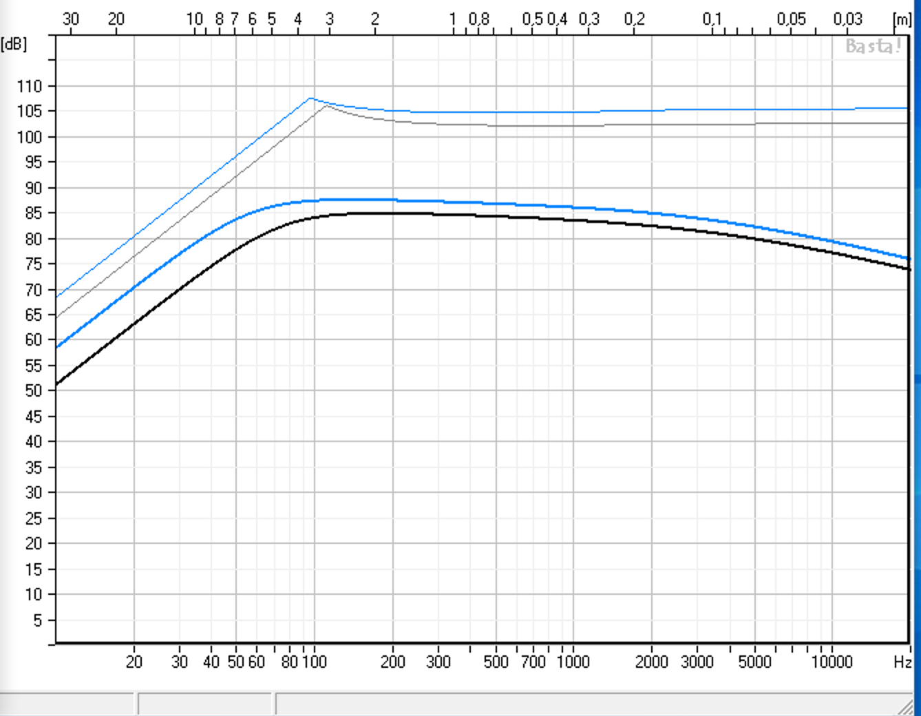

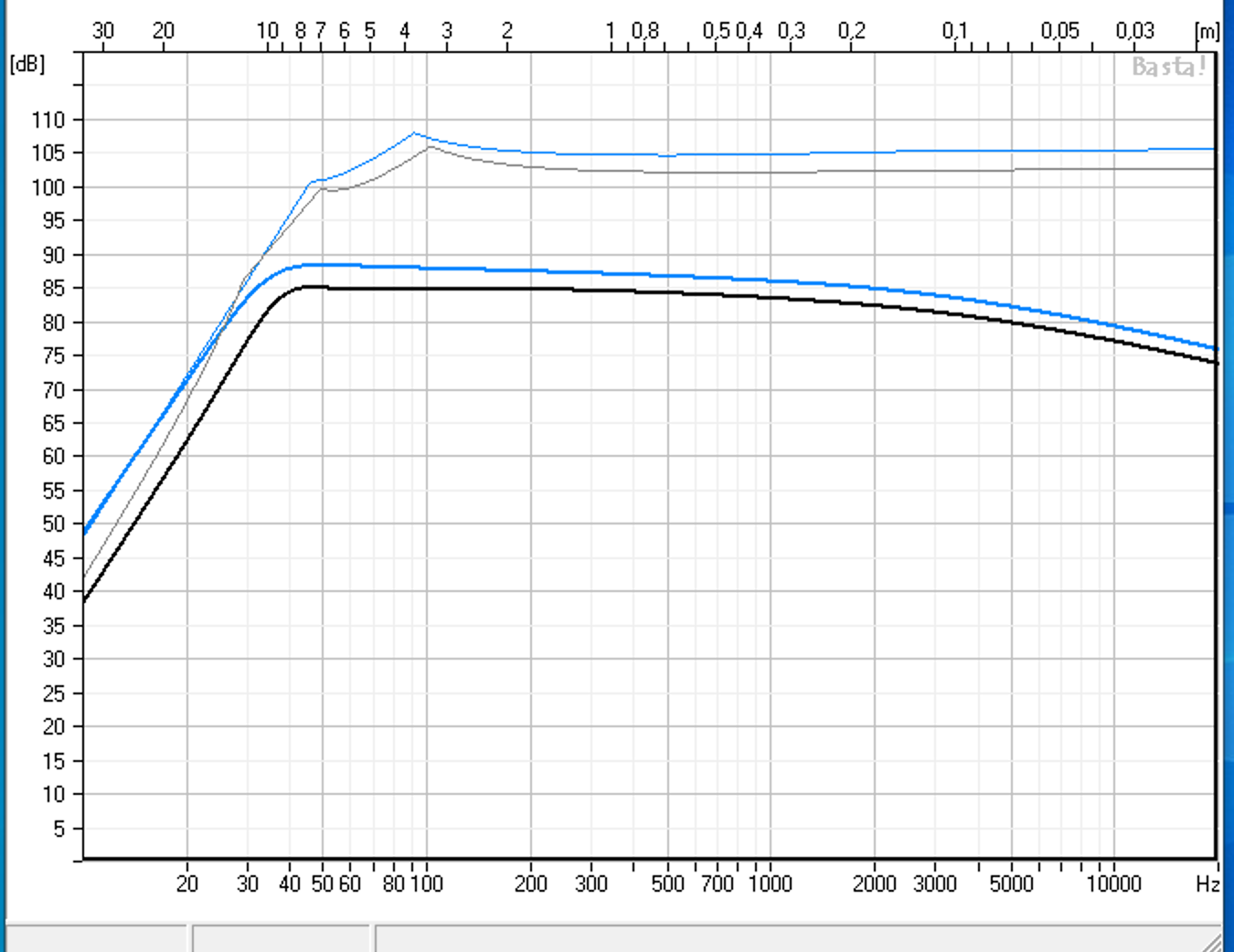

The differences have been explained. In terms of low frequency capacity: both reach 40Hz, even with the same max SPL, but the 18 does some lower frequencies too. For that the enclosure will have to be more than two times as big too... See the attached response, blue is the 18, black/grey is the 15, both response and max SPL at max excursion/max power.
The 15 indeed will have wider dispersion and matching a tweeter without a kind of waveguide (or a small one) will give better results than with the 18. Put otherwise, if you are going for the 18, sure do consider a tweeter with a waveguide attached.

[Edit]On the sub thing: my sims were BR but that is moot if you cross them at -say- 80Hz. Why would you tune them at 40Hz? Don't even consider reflex systems but go for closed enclosures. I've added the CB responses at 6l and 20l enclosures.

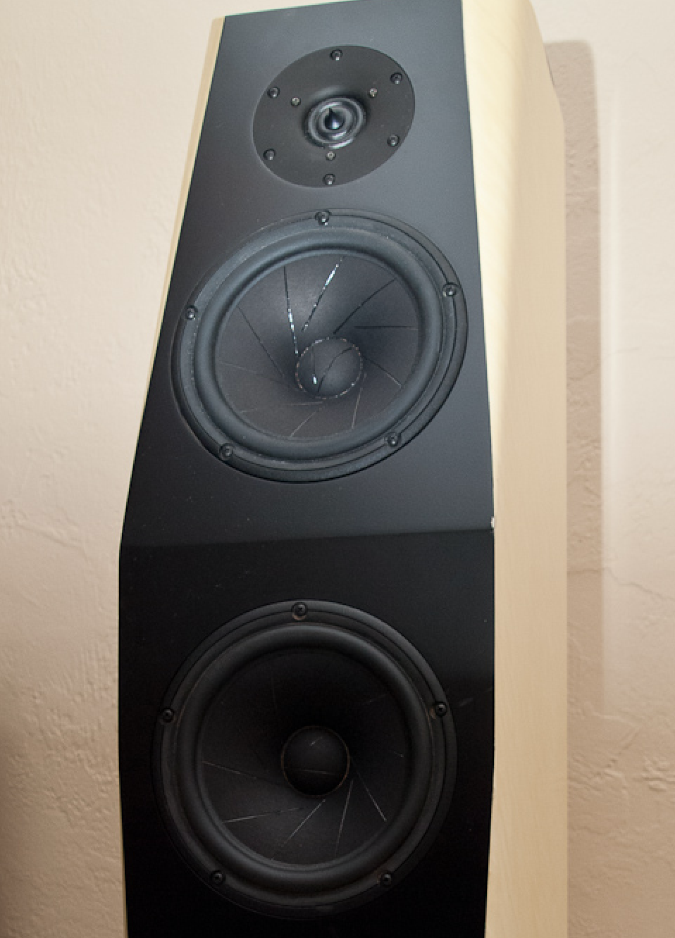

Thanks for your response. Looking at Paul Carmody's DIY Speaker Pages - Carrera.
Another design uses the Scanspeak D3004/6600 tweeter. I am curious about the Hiquphon OW1 tweeter tho.
I've listened to these 2-way speakers, and they sound very good.
Scan-Speak 15W/8531K00 and Morel ET338
