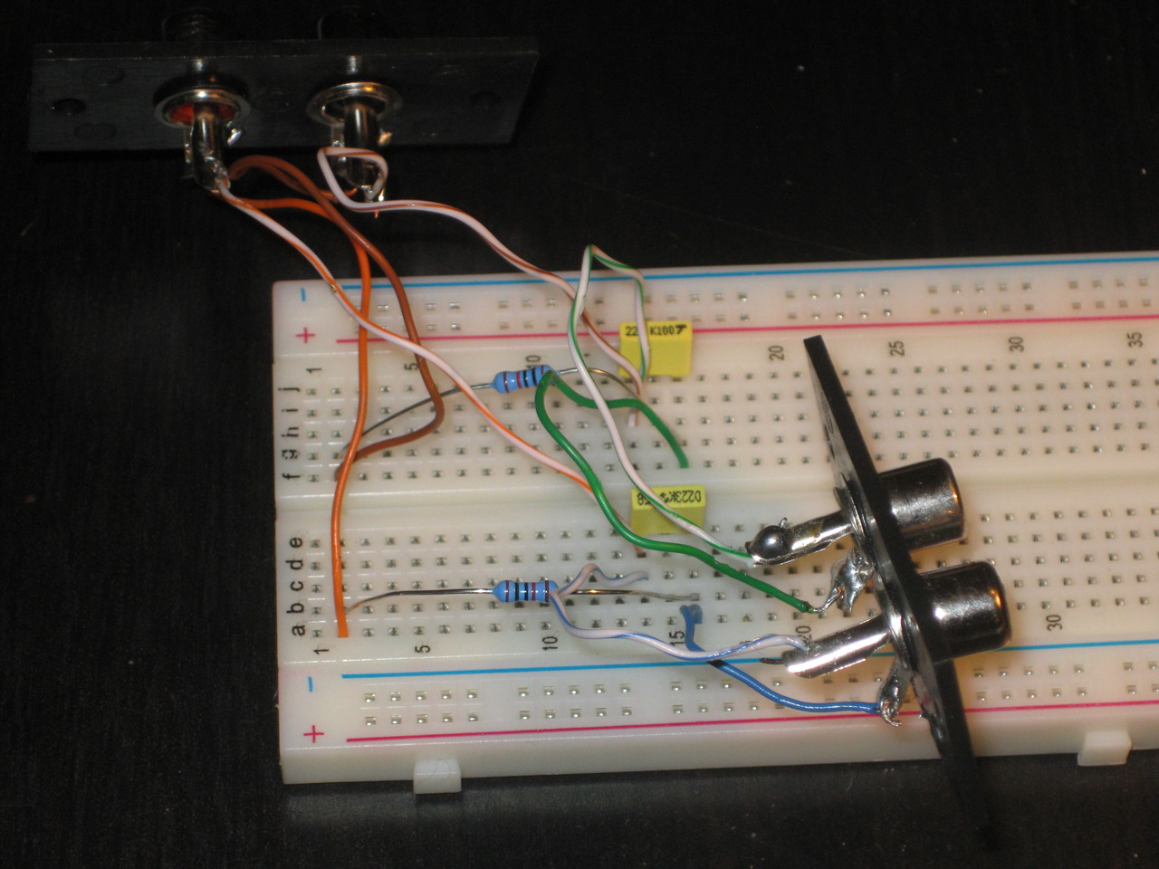

I tried wiring up the low pass side of the pllxo as per the worksheet. As a first test, I want to make just the 1st order low level crossover. The schematic is as easy as can be, but somehow I've done something wrong. I'm sure its a really basic mistake, I'm very new to electronics and just barely starting to get oriented. If you see what I'm doing wrong, please let me know.
The worksheet values I wanted to realize are:
Lowpass
70 hz
N.A. amp resistance (ony used in calculating highpass)
10k resistor
227.3642 nf (I used .22uf)
I built a rough prototype. The solder work is not pretty, I don't know what the RCA sockets are made of, but they just don't heat up. All 8 connections are solid though, I've tested this. I also know that some of the wire shielding is damaged, the wire is from a failed attempt to open cat5 cables. The wires don't touch each other so its not a problem for now.
The only thing this circuit does is add a healthy dose of hum.
On the board I have:
Row2: RCA+ in and 10k (leg1)
Row14: .22uf (leg1), RCA- (in and out)
Row16: RCA+ out, 10k (leg2), .22uf (leg2)
I've tried also reversing the RCA positives and grounds just to be careful, with no change.
I'm sure I'm making a real noob mistake. I've attached a picture of the breadboard. Thanks for helping figure out what I've done wrong.
Andrew
You have totally miswired it. It may help you to use the -bus as your ground. As you have assembled this thing you have no DC ground connection between input and output.
For a low pass you should have input and output grounds connected to one end of the cap. The input connects to one end of the resistor, the other end of the resistor connects to the output and the non grounded end of the cap.

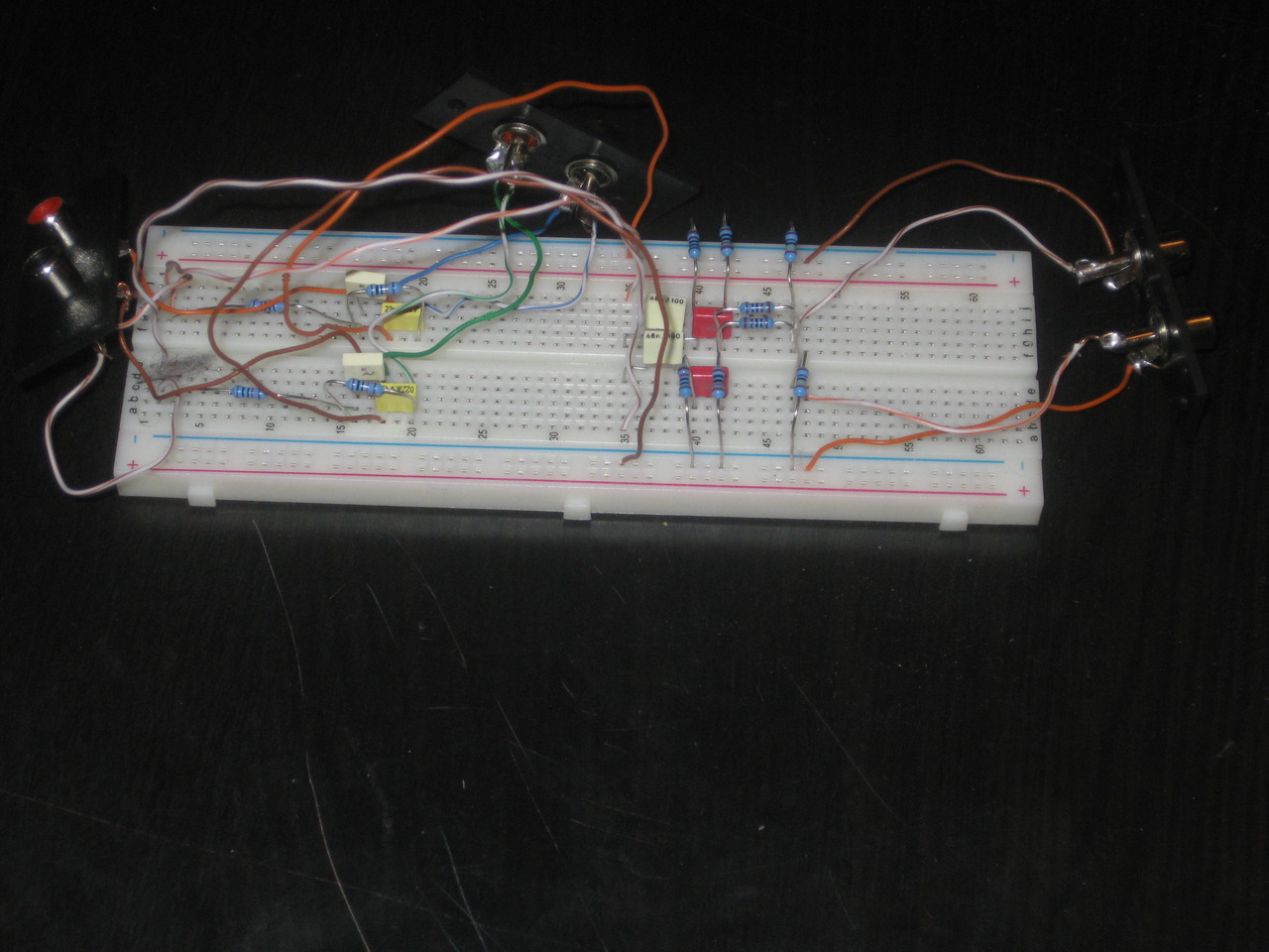

The XO with highpass
Here's a shot of the PLLXO now that I've added a 2nd order highpass. The highpass is followed up with a shunt attenuator (at least that was the goal 🙂 )
Hopefully I've wired this one right! At the very least its effective, indeed with test frequencies its doing pretty much what it should.
That said, I can't even listen to it. Music is so flat that I can't even begin to describe it. Arthur Salvatore goes on about the importance of "sound floor" (noise floor) on his personal website, HIGH-END AUDIO and Arthur Salvatore. This little toy demonstrates the principle perfectly!
I'm using an xstreamer with optical out to an audio-gd fun DAC (wolfram WM8741 based) to a triode electronics st-70 (with all NOS tesla tubes, including ecc802s and ef806s, sonic bliss!) connected to MarkAudio chr-70's in IKEA bowl spherical sealed cabinets. By itself the detail is just wonderful. Add in the crossover and dull doesn't begin to describe the sound. Lowpass is handled by a brianGT chipamp driving H frame OB Eminence Alpha 15A's, by the way.
So, for now I've pulled it out. I'll play with the xo a bit, and try to see if the low quality sound is due to a mistake I might have made. If anyone sees a problem with the way I wired it, let me know! I'll have to get a mic so I can do a frequency response test to make sure the component values are appropriate. Then I'll buy some good quality caps to test it with.
I'm also thinking that I could do the XO while still in digital: with a miniDSP outputting highs to optical to my current DAC, as its sound is quiet good, and use the miniDSP DAC for lows to the chipamp.
The pllxo though will still be interesting if I ever decide to get a turntable, so I think its an experiment worth continuing. A possible modification later would be to add a switch to each filter altering the resistor pairs, to be able to alter the crossover frequencies on the fly. Also, adding a buffer after the highpass so that you have a known impedance, allowing the highpass amp to be swapped, might be an interesting step later. In all it seems to have the potential to be a useful piece of gear.
I'll post as I make progress, since there seems to be little written up about pllxos.
You might try a buffer between your PLLXO and the attenuator. I prefer active filters.
The issue with your sound could also be a slight level mismatch. Measure your response.
Using your DAC after the miniDSP could cause timing issues. The signal will take a finite time to be processed by your DAC which may be noticeably different than the time it takes the lows in the miniDSP dac. Way above my head, but having identical DACs using the same clock reference is probably preferable.
I moved the attenuation before the highpass filter, and it sounds like it should. I didn't do much critical listening before moving the attenuation, but the main effect seemed to be that it had raised the crossover point. I'll order some better caps soon to play with.

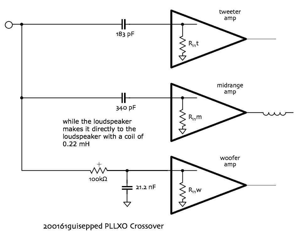

Sorry for my English, I've been using a pllxo for about 15 years, but the results of the c and r values ​​derived from the formulas gave me a horrible sound. For several years I have decided to use only my ear. Today i use an av nad t773 that has the preout outputs and i used to delete the wiring. In the specific use, a direct capacitor without resistance to the 183 pf tweeter, a 340 pf direct for the midrange passover, while the loudspeaker makes it directly to the loudspeaker with a coil of 0.22 mH, as far as the woofer uses a resistance in 100kohm series and a 21.2 nF capacitor. Capacitors are all silver-plated. The sound is really natural. The question is why do the formulas tell me that with these values ​​I have absurd cuts while listening tells me that it is correct? I found the value of the capacitors for medium and tweeters by setting the compensators first and once adjusted I measured the capacitance with a capacitance meter. I assure you that the result is spectacular. The casks are self-built with dynaudio components ie md130 tweeter, mid md140 and mw180 woofer with liters of about 60 liters. For ideex exchanges my email is giuseppemurena61@gmail.com. Greetings
av nad t773 that has the preout outputs, a direct capacitor without resistance to the 183 pf tweeter, a 340 pf direct for the midrange passover, while the loudspeaker makes it directly to the loudspeaker with a coil of 0.22 mH, as far as the woofer uses a resistance in 100kohm series and a 21.2 nF capacitor.
Do i have the inductor in the right place?
attachment.php
Then a mix of PLLXO & passive XO?
Looks pretty standard, but for the mid LP being passive.
dave
