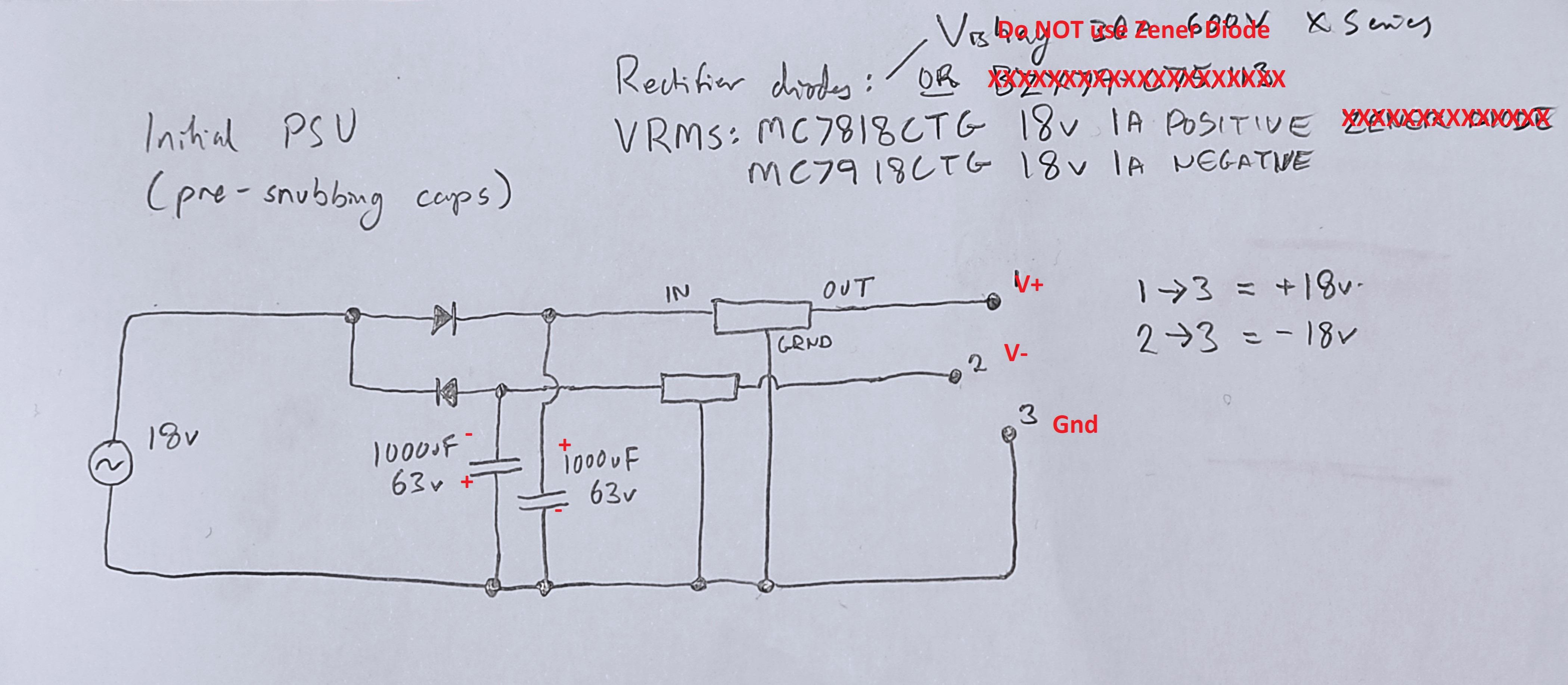

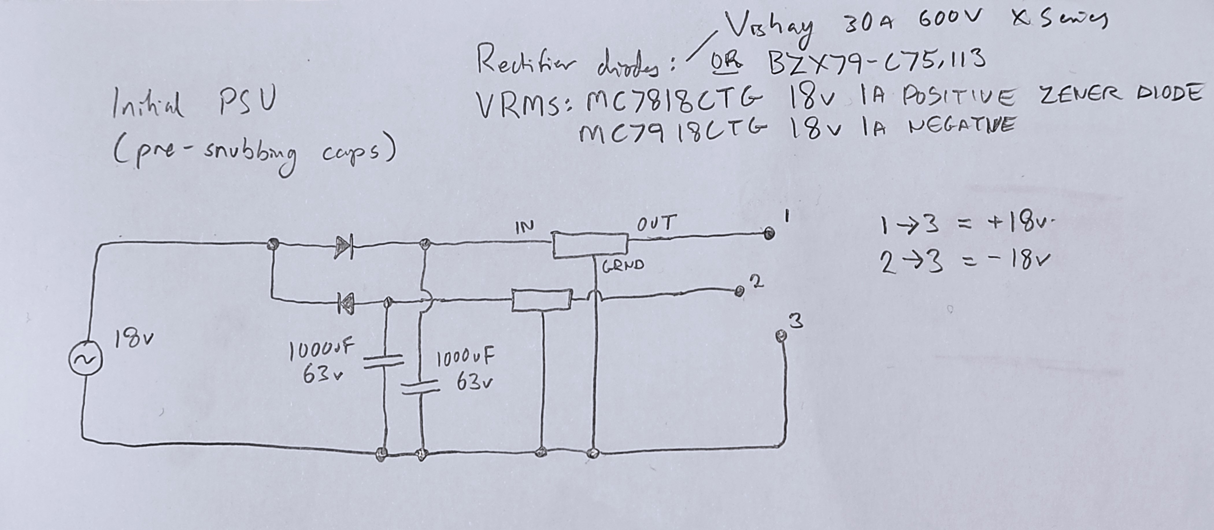

Hi all,
Picture is attached. Hope this is clear what I'm trying to do, I looked at the recommended PSU and understand that it says it can be used with an AC wall wart, but still confused over how we achieve that if it requires 3 input rails??

Your 18V AC wallwart followed by the 2 diodes gives -18V, 0, +18V.
This will measure 18V with respect to the 0V live and 36V if measuring from - to + lines.
The filter caps will increase this to 1.4 times ie 25V as they charge to the peak of the AC (50V from - to +).
Check for wiring errors.
You may well need a heat-sink for the regulators.
Power dissipated by the regulator = voltage dropped across the regulator (V in - V out) x current. Though for testing (without a load applied) they should be cool.
The circuit you have posted works by half wave rectification.
The positive half cycle goes to the + rail.
The negative half cycle goes to the - rail.
Because each rail only receives half cycles, greater smoothing capacitance is required compared to full wave rectification.
this is where I'm confused and should study some electrical engineering. I was thinking I need a neutral wire to give me half wave, otherwise I'd simply have peak to peak of 36v... but that doesn't make sense either.
Will one output on my wire be live and one neutral or is it nominal? And if so how do I correctly identify?
I'm strating to feel well out of my depth here

Nannoo,
As russc noted, your schematic shows half wave rectification for each voltage rail and it should work, so check for wiring errors.
You noted on your schematic a zener diode as a alternate to the rectifier diodes. That is incorrect. A zener diode will not work. You need to use rectifier diodes. Did you use zener diodes?
You mentioned sparks. Were you making connections with the power on? Hopefully not.
As russc also noted, half wave rectification requires more capacitance to smooth the rectified wave form.

hi tgreese,
is stacking two power supplies a better engineering solution? It sounds sketchy but I don't know it that's my lack of education!
You can stack supplies just like you stack batteries. It's not sketchy. Same idea. Any supply will conform to whatever ground reference you assign to it. Just make sure that all your ground references are to the same potential (ie earth or safety ground).
Hi all,
I'm keen to learn how to make these though as I'd like to make some opamp based active filters next year and will need to make psu's for them.
Read the P05 article in post #3 where Rod explains the use of a AC wall wart to achieve split rails.
