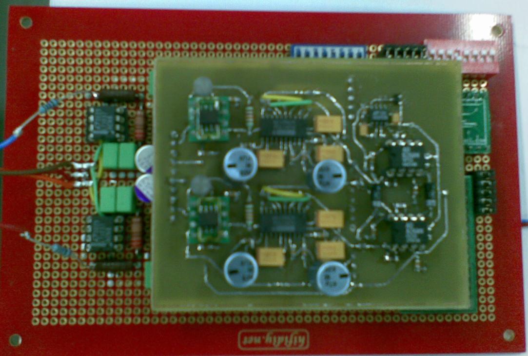

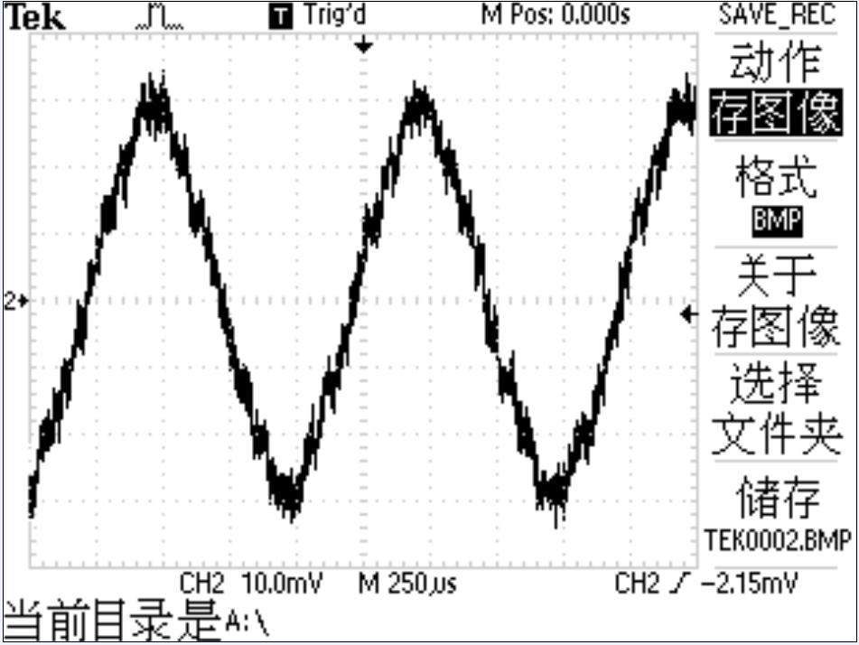

Try to build an old style DAC, PCM1702
Just finish the work hours ago 😀
CS8414 as the DIR receiver
DF1704 standard DF
PCM1702U X 2 DAC satge
OPA627AU as the I/V converter
LT1037 mfb LPF
All PCB made by myself , that made my hands look so poor >_<
The sound is pretty goooood

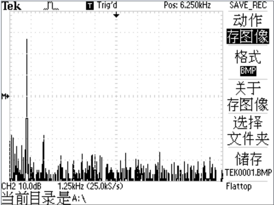

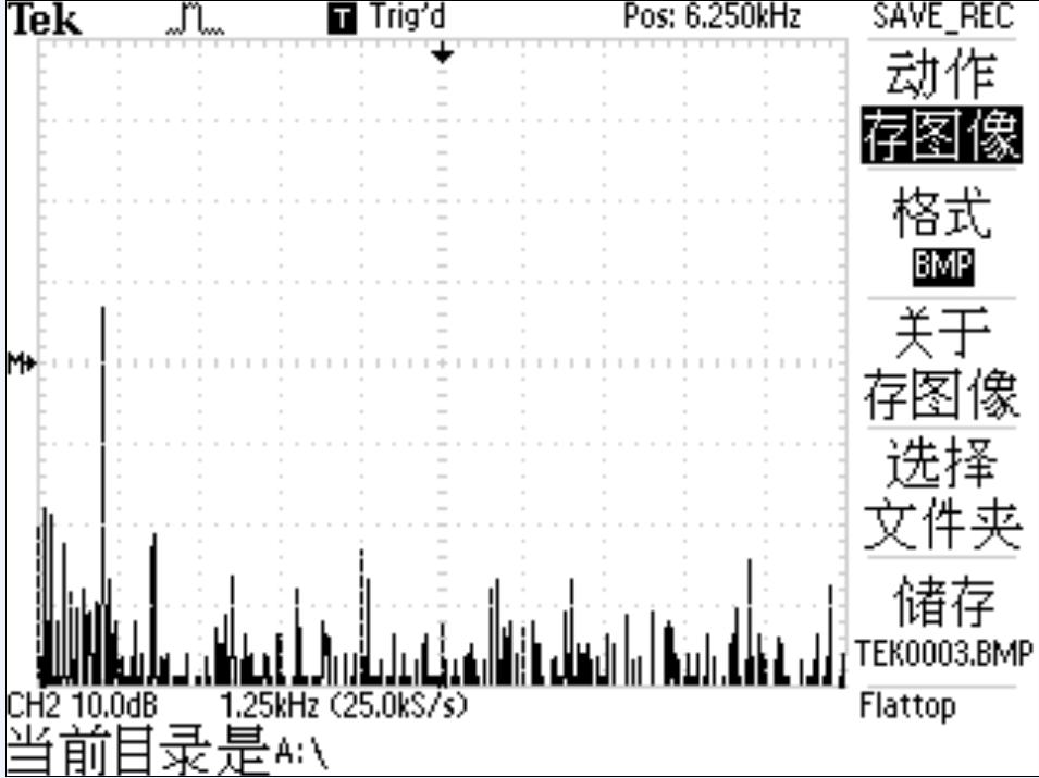

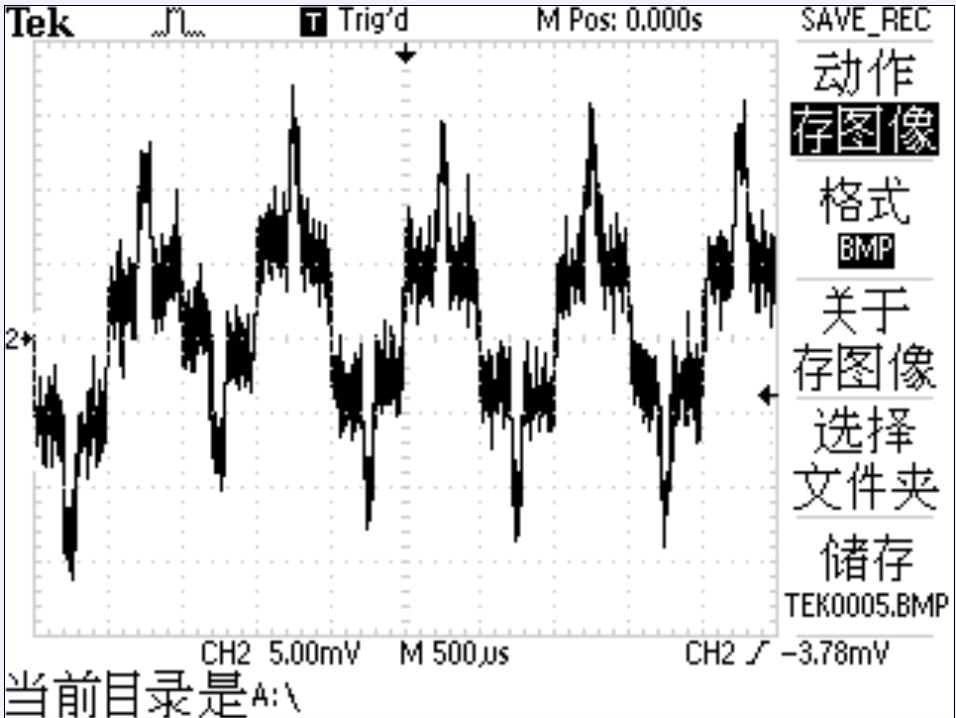

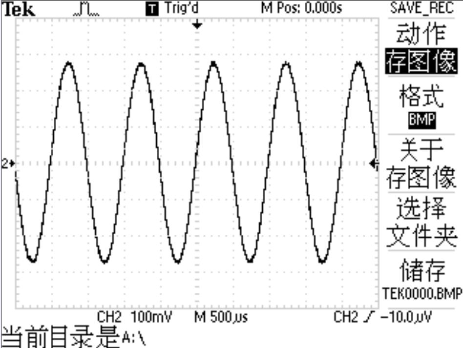

For the test result, I test the low level signal below:
Source : CD PRO (VAU1254/11) transprot , SONY test cd provides 16bit signal
60 dB Gain amplifier for oscilloscope TDS1020B, so, 100mv/DIV means 100uV actually ^_^
The pics bellow shows :
-60dB sinewave and FFT
-80dB sinewave and FFT
-90dB sinewave and FFT

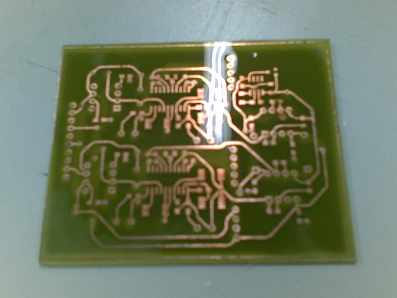

and the PCB ^_^

Nice project! I agree with the choices you made . Good job.
I dont see a single shortcoming on the digital part, when compared to newer designs. Not a single one. But you have to make the spdif receiver circuit as good as possible. (No toslink!)
I think I send you some datasheets, when I find it, that can clean up the spdif somewhat.

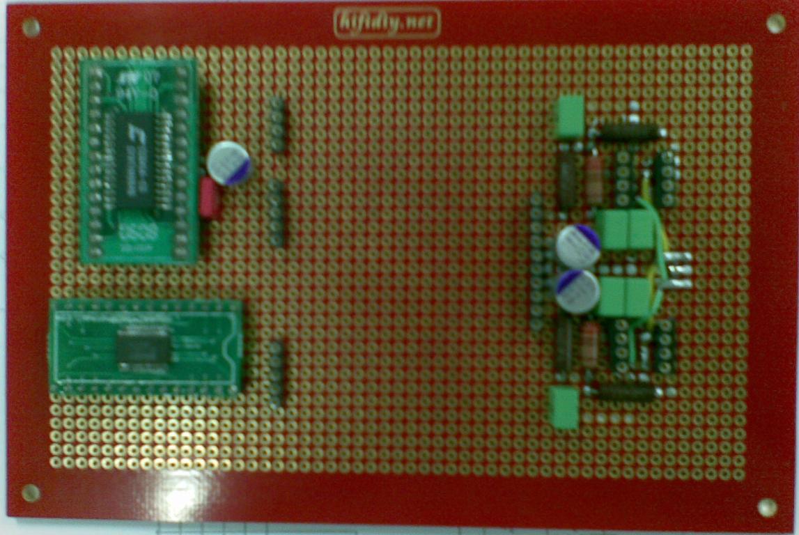

this is the female-board under the PCM1702

I made a mistake on #1, the gain of the amplifier is 40dB
