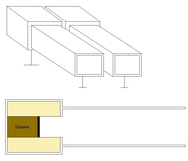

Dear Poldus,
What is wrong with the tube barrier? The absorption material? Did you try removing all the absorption material and relying on your room treatment? I don't know what the cause to this is. I'd be glad if you would inform me some more.
Thank you so much!
saddest regards,
Wolfgang
Wolfgang,
I found that using just an inch or so of rockwool as per your drawing allows too much sound into the room to effectively remove crosstalk. I found that I needed very thick layers of absorption on the outer walls of the tubes. This, coupled to the inner walls made of plain MDF result in increased high frequencies and subdued mids. You would have to counteract this altered response by modifying the speakers´ filters.
These, however, were only my findings with my speakers in my room, with a poor implementation of your design. Also, my speakers are actually touching each-other, not separated as in your sketch.

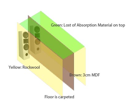

Sorry, I don´t have a camera.I´ll try to describe the whole contraption:
The speakers are next to each-other, actually touching since this gives the best results in my experience.
3 cm. wide MDF barrier ( 2mts long/1mt. tall)extending from the front baffle of the speakers on to the listener.
absorbent material from the side of the speakers on to the listener; same size as the latter.
All three panels sitting on heavy-carpeted floor.
Plus more absorbent material on top creating a kind of roof.

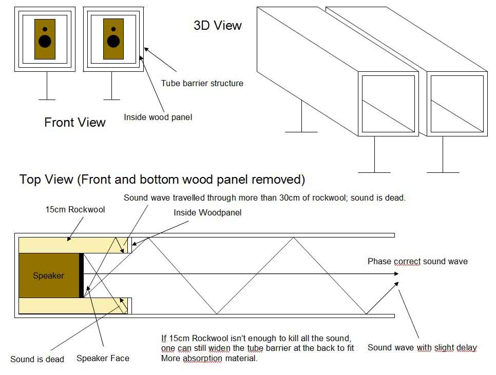

Uhm... I don't think that's exactly what you can see in the sketch or is it? Your system is not identical with my sketch (imagine I would move the speakers in a 0° angle) If you don't reflect the sound in a different direction with some wood, I don't think it will truly kill crosstalk. Am I missunderstanding something?
Thanks,
Kindest Regards,
Wolfgang
You are correct Wolfgang. There was virtually no angle between speakers in my implementation. Also the "roof and floor" of the tubes were not angled as in your design, but simply perpendicular to the sides. It is most likely that my results are not transferable to a properly executed rig.
The problem is, to properly put together your design with a span two-meters takes a lot of wood, time and quite some money.
My intention was to get a taste of the thing by cutting a few corners. I am confident that your design warrants further and proper investigation.
Poldus,
Is this what you have built?,
Kindest Regards,
Wolfgang

The past weeks I've spent experimenting with different factors of Ambiophonics. The tube barrier does work indeed, and no honky like sound is produced, like if you put your head into the flare of a horn speaker. The only thing I had to change is attach a thin layer of Absorption Material on the inner center walls of the barrier. Just like in the last concept of the absorption tube barrier (attached as JPEG) I mounted a 25cm deep basstrap after 25cm of absorption material and it successfully held frequencies down to 100Hz. The bass below 100Hz didn't sound good, and when I tried attaching a Subwoofer the bass was localizable and ruined the entire "I am there" impression. I realized that DiPole Subwoofers work best. 100Hz is the border where your ear stops localizing sound. If a normal pressure transducer Subwoofer is localizable at 50Hz, the absorption around the Ambiodipole would need to be far thicker. So the answer to THE Subwoofer for Ambiophonics is definately DiPole. In my case I have used 2 Mivoc AWX 184 18" Subwoofers.
Hope this helps.
