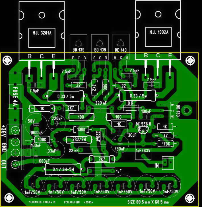

Re: taj and Alex MM layouts
I think Alex uses Eagle. I just use Microsoft Paint. 😉
..Todd
quoydoy said:
I'm curious what software you guys use for the board layouts.
..Todd
Please dear Alex MM..... produce a black and white layout for us
The one we use to produce boards... black copper lines.... in pdf and respecting the standards related sizing... to allow us to order print into a laser printer and result final product with correct size to hot iron image transference to board.
thanks in advance.
Very nice board AlexMM
regards,
Carlos
thanks in advance.
regards,
Carlos

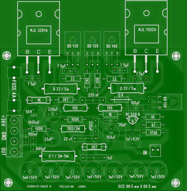

Nice colour to a circuit board
During the seventies Marantz was using this colour into their brand new super modern Fiberglass boards.... into those early days fiberglass boards were modern.
ahahahah!
Carlos
Image came from dear Brian
ahahahah!
Carlos

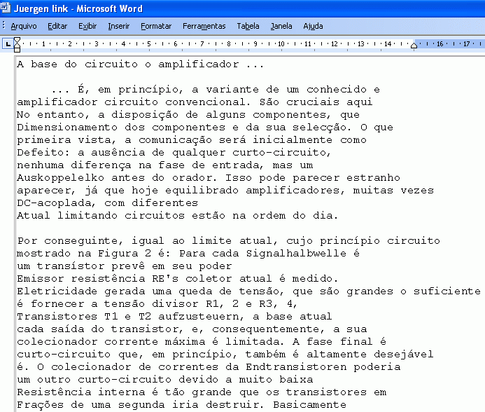

have look at
http://www.geocities.com/quhno/black-devil/index.html
maybe google can translate it for you.
This little amplifier was very controversal twenty years ago, because the author/publishing magazine advertised it as 'high end'.
regards
have look at

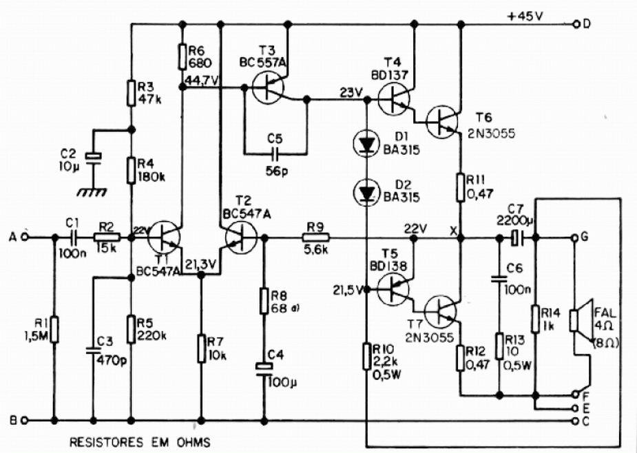

This one is another one i like Juergen
Was made by brazilian Philips during the seventies..and sold as a Kit.... more modern, uses differential amplifier into the input... and i know this one sounds good too..but do not measure so good as the Trust. (0.007% THD)
The Trust is even more simple.... alike the one you shown into your link.
Thank you Juergen
regards,
Carlos
