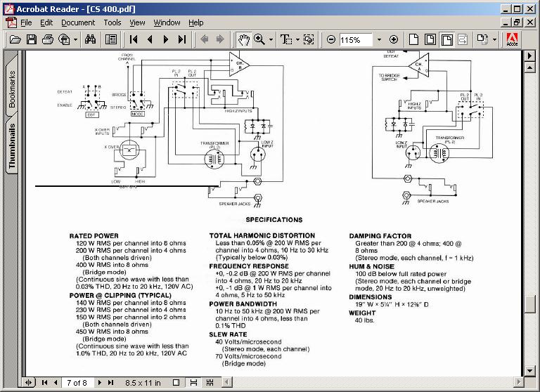

My Peavey CS-400 power amp has a power supply rated for 800VA and the output power is described in the manual as follows:
Could I then assume that this is an “honest” 120 watts per channel, or is there some deception in that statement, or would a time figure be needed to make it really honest?
Rated Power
120 W RMS per channel into 8 ohms
200 W RMS per channel into 4 ohms
(Both channels driven)
400 W RMS into 8 ohms
(Bridge mode)
(Continuous sine wave with less than 0.03% THD, 20 HZ to 20 kHz, 120V AC)
