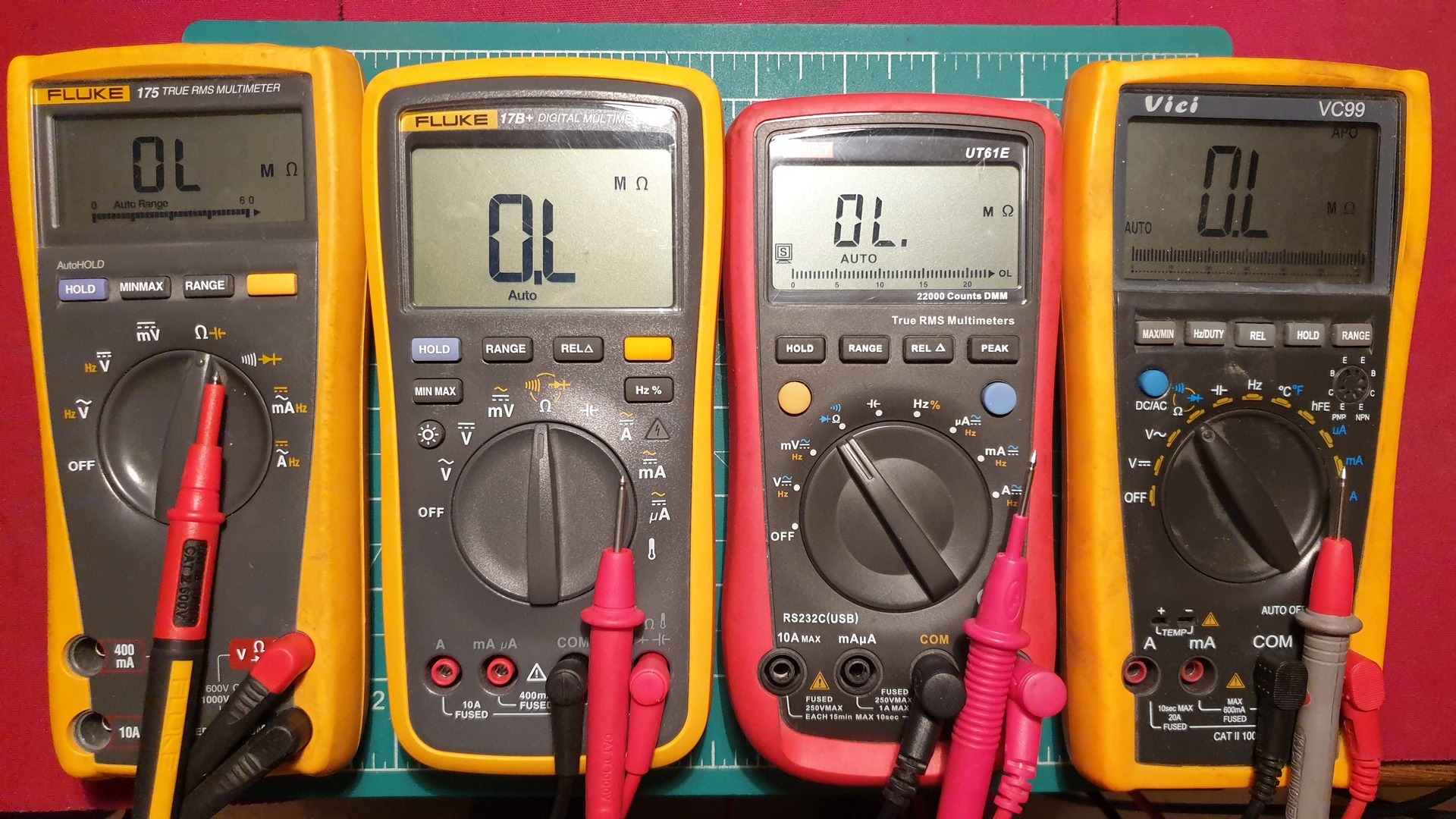

Take a look at the UNI-T meters, i bought a UT61E model for under $100 and honestly i prefer it to my Fluke 175. It just works.

For the money its great. Don't get me wrong, the Fluke 175 is a better quality and more accurate meter, but its three times the price. The UNI-T has more functions and is more versatile, and does everything the Fluke can do.
Put it this way, if i want to match resistors and want them to be exactly 49.9ohms on the button, or need to know exactly how many mA a circuit is using i will reach for the Fluke as i have more trust in its absolute accuracy. For everything else i use the UNI-T.
I have also found cases where the 175 wont work where the UT61 will, for example was calibrating a take deck recently and had to measure 400hz and 10khz signals at a few hundred milivolts, the Fluke would'nt play ball and give me a reading where the UNI-T worked flawlessly.
The Fluke 17B i bought from AliExpress when they were under $100, great 2nd meter but isn't true RMS. Then finally the Vici, what an absolute steaming pile of dog poo, don't buy one of those. Or anything that has those transistor testers built in, dead give away its a rubbish meter.

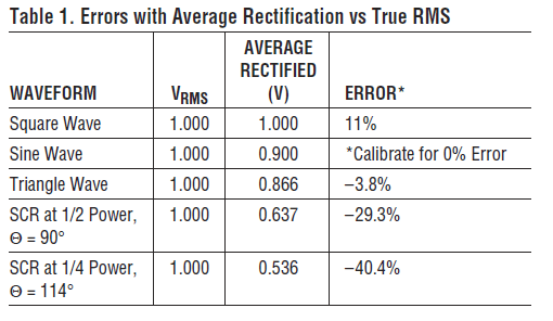

True RMS -- why you need it -- this chart from the Analog Devices/Linear Technologies LT1968 datasheet
Very interesting. Thanks!
I thought that was obvious.If its audio signals being measured it won't be SCR waveforms,
Yet some folks "never thought about it".
THE good excuse is trimming lamp dimmers. As I worked next to a theater in days of giant SCR/Triac dimmers, I have wished for TRMS. Before such things were affordable. However, use you brain. The equivalent average reading of chopped waveforms can be computed. Or even determined experimentally with resistor and thermometer.
I have NO idea why I would want an audio square, or the RMS of a square-- anyway a peak meter tells you that if you discount the "RMS calibration", or use a 'scope. (Yes I have used a lot of audio squares in synth work, but not as final product, just a rich soup for filtering.) The only reasons I would be measuring Triangles are for slope or peak clipping; 'scope work, not meter.
