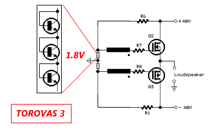

TRUE ESOTERIC AMPLIFIER
This machine has the characteristics to play a musical instrument to become successful
has no feedback
As for Zeus Susan uses a transformer to raise the tension
and a pair of MOSFETs to raise the current
the bias is not floating
Board toroidal 50VA with primary used as the secondary and vice versa - for OS 2SJ200
