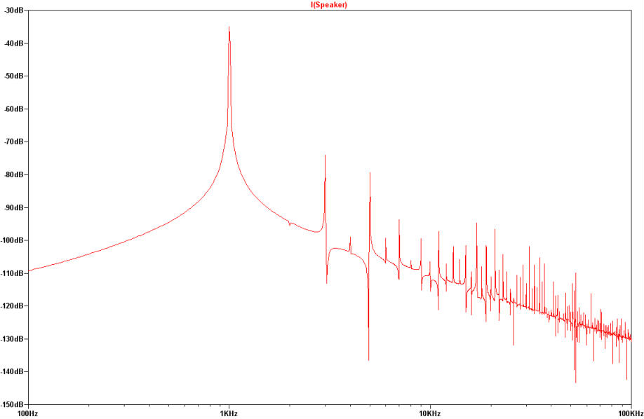

Okay, next thing. This is another thing that I have noticed about symasym which I think could lessen the even harmonics if dealt with properly. I have noticed a .76% imbalance in the Ib of the MJE15034/35 (I am using these), where the MJE15034 has more current than the other (142.3uA : 108.5uA). I have also noticed some even harmonics (I have the FFT in my attachment if there is something wrong) not immediately after the fundamental but the 2nd even harmonic is still noticeable (visually) And I think that correcting this imbalance would lower the distortion not a large amount, but significantly. Is there any sort of anything that would help balance these? I am just telling what I am seeing, and not really trying to correct it myself, but just politely notifying the creators of these things in hopes that I could aid in the development of the cool 😎 symasym. That would be cool 😎

This FFT was taken with 8ohm/5.26mW@1kHz

PS: I am now using the wilson current mirror

Keantoken, your mismatch between base currents can be fixed in real world by matching these devices.
About your FFT, something is very wrong, it shows a THD of ~1%, and way too much high order harmonics. Have you verified that bias in outputstage is ~50ma ? You might have severe cross over distortion.
At these levels you should have ~0.001% thd, ~-100db of 2nd harmonic relative to the signal.
