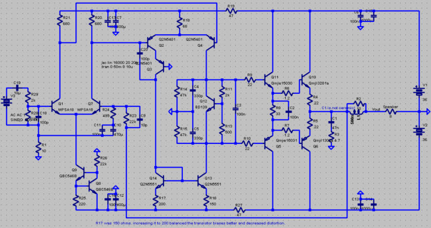

I have been messing around with symasym5.3, just testing stuff, and I found that the bias on Q13 and Q14 wasn't balanced and wondered that if I messed with the resistor values that the distortion might decrease slightly. I know that I'm not qualified to mess with this stuff but I wondered if anyone really bothers with the small stuff like that.
I have my schem in the attachment.
I increased R17 (in my schem) to decrease the bias voltage on Q14 to better match it with Q13 which made the biases around 710mV.
This is the FFT before the optimization:
This is it after the optimization:
NOTE: My site manager delays the time it takes for things to actually show up on the website, so if you don't see pictures, come back later
Here is my schem:

keantoken, i personally don't like the idea of adding an extra unbalance to compensate another. I can't see the fft-plots...
A Wilson current mirror (the 3 bjt thing) does remove the unbalance, but does not cancel the distortion.
Mike
Edit: I checked that in my sims, i would need 153ohms for your r16 to balance that out, in any case i had increased distortions. You might not fully trust in sims.
Where did you get the models for the output devices ?
How big was your unbalance ? I have unbalance of 2% (currents)

I got all my models from onsemi.
sorry, my host server is still delaying the stuff...
I will attach my images. Maybe there is something wrong with my software? (LTSpice)
Here is my FFT without the mod:
Actually, I accidentally switched the pictures when I was saving them. I saw the difference when I first looked at my attachments and redid my simulation and resaved the files. Refresh your browser and look at the attachments again. Maybe there is something wrong with my software.
