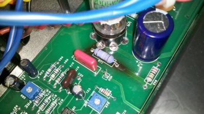

Troubleshooting UA 2-610 Preamp
i repair two sets, was 22Kohm 3W burnt, i replace with 5W

Thank you for your response, Claudiomas! I checked the board over for obviously burnt components and I didn’t see any. I’ll meter it out.
Are there any differences between the LA-610 and the 2-610? I imagine they are conceptually the same, but I don’t know for sure.
