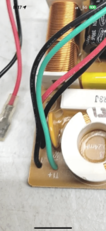

I picked up some used klipsch speakers (2 way, 2 woofers + 1 tweeter, nominal 8 ohm). One measures 15 megaohms and the other measures 21 megaohms.
That seems way out of the ordinary so I opened them up. I disconnected the tweeters and woofers and they all measure what you’d expect on their own (something like 5-ish ohms). Not shorted and not “open”.
So now I’m looking at this crossover and trying to figure out where to start looking for problems. Nothing appears “wrong” based on appearances. No bulging caps, or burn marks, etc. My first thought was that thermistor, but (in circuit) it measures 0.4 ohms, which seems reasonable. Am I wasting time measuring any of the components “in circuit” or must they be removed, the caps are glued to the board and will have to be pryed off.

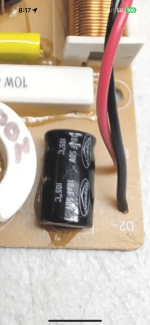

That 390 uF cap could be it, for the woofers. Do the speakers play alright, as a whole?

If a capacitor (HP filter) is in series with an inductor (LP filter) and these two in series with a woofer, then a dcr test can not show dcr of the network because a dc signal can not pass a capacitor, only ac signal can. Trace the x/o board. Start from + In at the cabinet terminal.
This speaker may incorporate a 390 uF series capacitor in order to change the order of the bass loading.
For a vented speaker this results in 5th order bass loading and for a sealed speaker it results in 3rd order.
An infinity reading on an ohmmeter connected to the loudspeaker terminals is the result of this large value capacitor blocking DC.
I suggest the OP connect the ohmmeter after the 390 uF capacitor when he should measure 6 ohms or so of resistance.

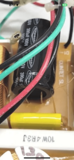

Why not link out the big cap and retest on your meter.

Connect a shorting link across the terminals of the 390 uF capacitor then measure the DC resistance at the speaker terminals.
