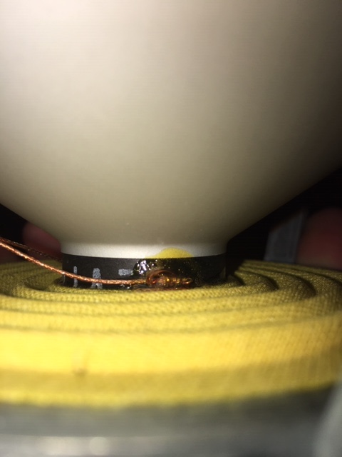

Check the spider for any signs of burning due to an overheated voice coil. If visible you will almost certainly require re-voice coiling.
On second thought maybe I don't know what burning looks like - I took a photo with my phone and it looks different than when I looked with my naked possibly bad eye. I've attached it here - is this burning?

Is it just a trick of the camera, or is the black voice coil former tilted to the right (i.e. not truly vertical)?
That would be consistent with a slipped magnet and would indicate in which direction to thump the rear plate.
Just clutching at straws here!
