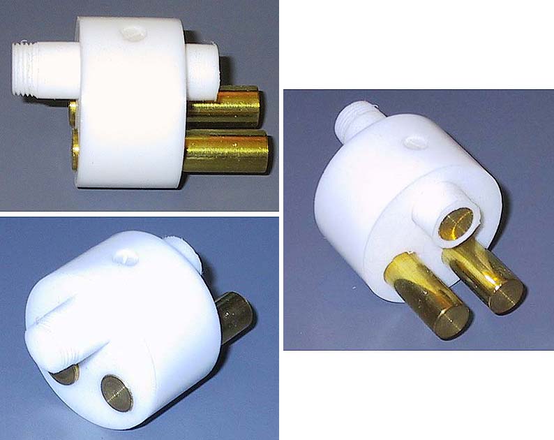

chrisb said:
In my own case, a local designer/guru developed an underslung design from a combination of Delrin & brass.
This one would be pretty easy to diy...
dave
