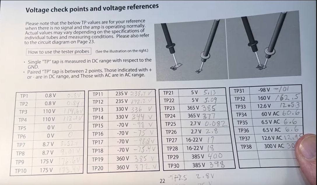

I'll preface this with saying that I'm reasonably new at this, and I'm doing the best I can with a multimeter and what little knowledge I have. But essentially I'm troubleshooting an Elekit 8600 where one of the 300B tubes is consistently running hotter than the other. This is a problem that has (maybe) been happening since I built this amp 6 years ago, but the voltages at a few test points fell within normal fluctuation ranges though a few were a little high, but the amp played fine, and I didn't really focus on it.
That said, I started having issues with distortion, and a channel cutting out occasionally (after 4-5 years), until finally one channel would pop and stop altogether. I would swap tubes from side to side, but ultimately it never seemed to change the performance, and once one of the tubes (I think) became damaged, tube swapping didn't help because if it's the tube AND the amp, it becomes difficult to diagnose. Finally, I just replaced the two 300B tubes, (not the ECC82s or the ECC83) with a matched set. and put them on the amp. I turned on the amp and it sounded OK-ished but I noticed one tube seemed a lot brighter. After a minute or so of playing, one tube was significantly hotter than the other (one was measuring 86F and the other was 136F). I didn't let it keep running because I didn't want to damage the tubes, so I shut it off.
So here are the actions I've taken:
1. Initially when I had the problem, I reflowed the connections for the tube sockets and visually inspected the PCB, problem seemed to be better, but after a while persisted, honestly the problems were intermittent anyway, so not even sure this had an impact
2. Retested all test points. All voltages were fine, except for two fairly close to the channel - these were unusually high, but fell within the 10% range of acceptable according to instructions, but by then, one of my tubes were probably fried so I am not sure of the cause
3. Purchased a matched set of new 300Bs - but in my first try one channel got so much hotter than the other, I shut it off
4. Taken apart the amp, to visually reinspect to make sure that I put it together in the first place, resistors, transistors all in the proper place and orientation.
5. I also visually inspected solder joints - and started doing some continuity tests, but honestly don't know how to do this effectively. I have a Fluke 87 Multimeter which I think is a pretty decent machine, but when it came to resistors, it was hit or miss whether the continuity was registering.
6. I took a multimeter and tested each resistor for the correct value. I realize that IN A PCB, the circuit is going to impact how these measured, and some of the resistors seemed way off, but when they were way off, they were off in pairs, meaning the readings were similar channel to channel - which seems like that means they're correct
I've reached out to the local Elekit partner, and he's working to help out, but honestly, I'd love to learn how to understand this a bit better, and I want to see if there are any other common sense checks I've left out. So here are some questions:
1. How can I test, or should I just replace the ECC82s and ECC83 in the amp?
2. Aside from visually inspecting solder joints (they all look fine) - what else can I do to test components here? I have the schematic but would love directionally some idea of potential areas to chase.
3. Can anyone share a good PCB troubleshooting 101 I can watch/read?
4. What other potentially silly or simple thing am I missing here? Could there be some unwanted issue with any connections downstream? Speaker polarity? Pre-amp?

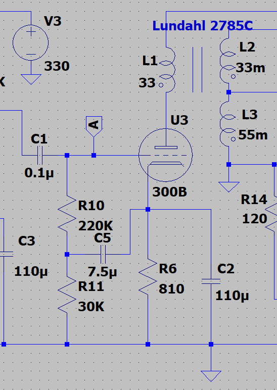

I would suspect an issue with the autobias regulator circuit. Continuing to buy/swap tubes probably won't help.

The Elekit 300B employs self bias with 810 ohm resistor at cathode. Please measure the voltage at cathode and grid relative to ground. Then, we may able to find the cause of the problem.
Thanks @soulmerchant ive been talking to Victor - but even though im sure hes much more technical than me - I thought the collective brain here might be able to clue me into something I’ve been missing.
@kmtang thanks for digging that up. I assume I need to measure the voltage with the tubes in and since these are new I don’t want to damage them. I’ll see if I can dig up the old ones.
