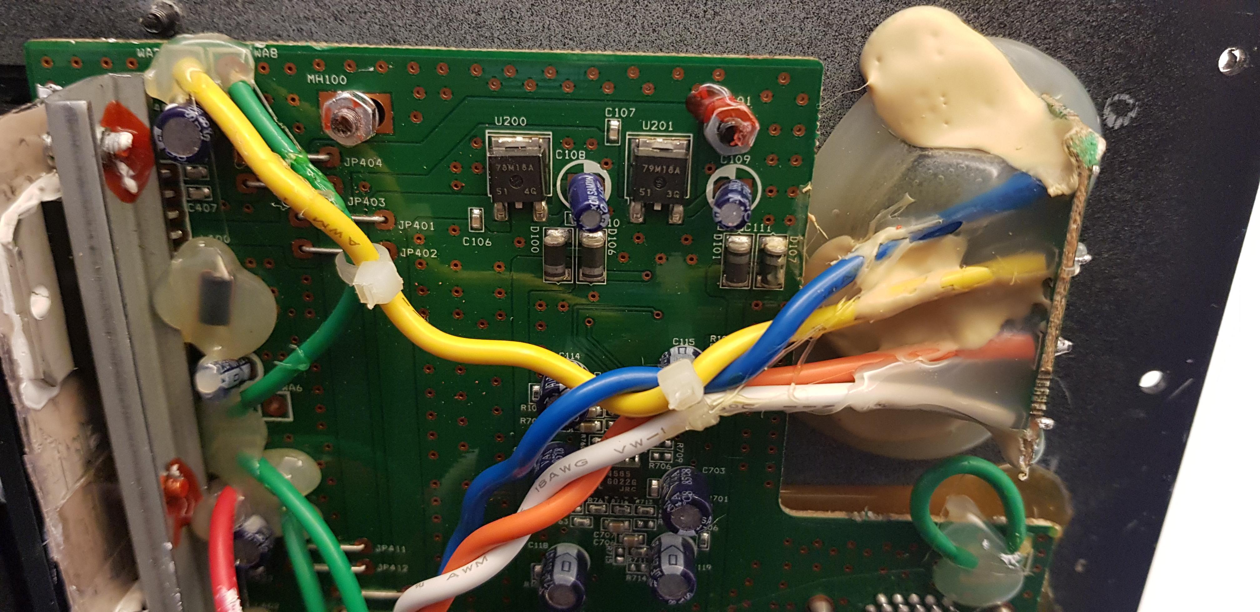

Upon googling further, I found a common problem in the Z-2300 is a subpar mechanical joint of two ground wires. See Logitech Z-2300 subwoofer hum solved! | YourITronics. I replaced the mechanical joint with a soldered joint, but unfortunately this did not mitigate the humming.
I then spend some time measuring the power supply circuit of the Z-2300 with my DMM but I couldn't find anything suspicious: mains voltage appeared over the primary coil, the secondary was at 40.2V AC and I measured 54.2V DC after the bridge rectifier. Measuring the rails for the MOSFETs, my DMM reported an initially high ripple on the DC voltage but after a while the reading would stabilize to less than 1V (note this was with no outputs connected).
I then proceeded to try and de-solder the output caps on the bridge rectifier (in order to measure their capacitance, I don't own a ESR meter) but have been unable to desolder them due to all the epoxy on the PCB. As the two big caps still look in good condition in the pictures linked below, I'm doubting whether they are causing the humming.

However, upon resoldering the capacitors and re-installing the PCB onto the woofer back plate I noticed that the humming has disappeared from the speakers! This was yesterday evening and today it hasn't returned so far. I'm hoping it'll stay good for now. The transformer still humms, but this is almost inaudible as I placed the woofer with the transfo in a corner of the room.
I can only guess what might have been the cause of the humming at this point, clearly the transfo was not the culprit. My best guess would be the grounding from either the PCB to the chassis heatsink or from the FETs to the heatsink (I reinstalled the bar pushing the FETs on the heatsink) . I noticed there are small strips of plastic between the heatstinks of the FETs and the chassis heatsink. While I don't know their function, I realigned a number of these strips. But I don't know what solved the humming, all I can say is I'm relieved it's gone! 🙂 Thanks everyone!

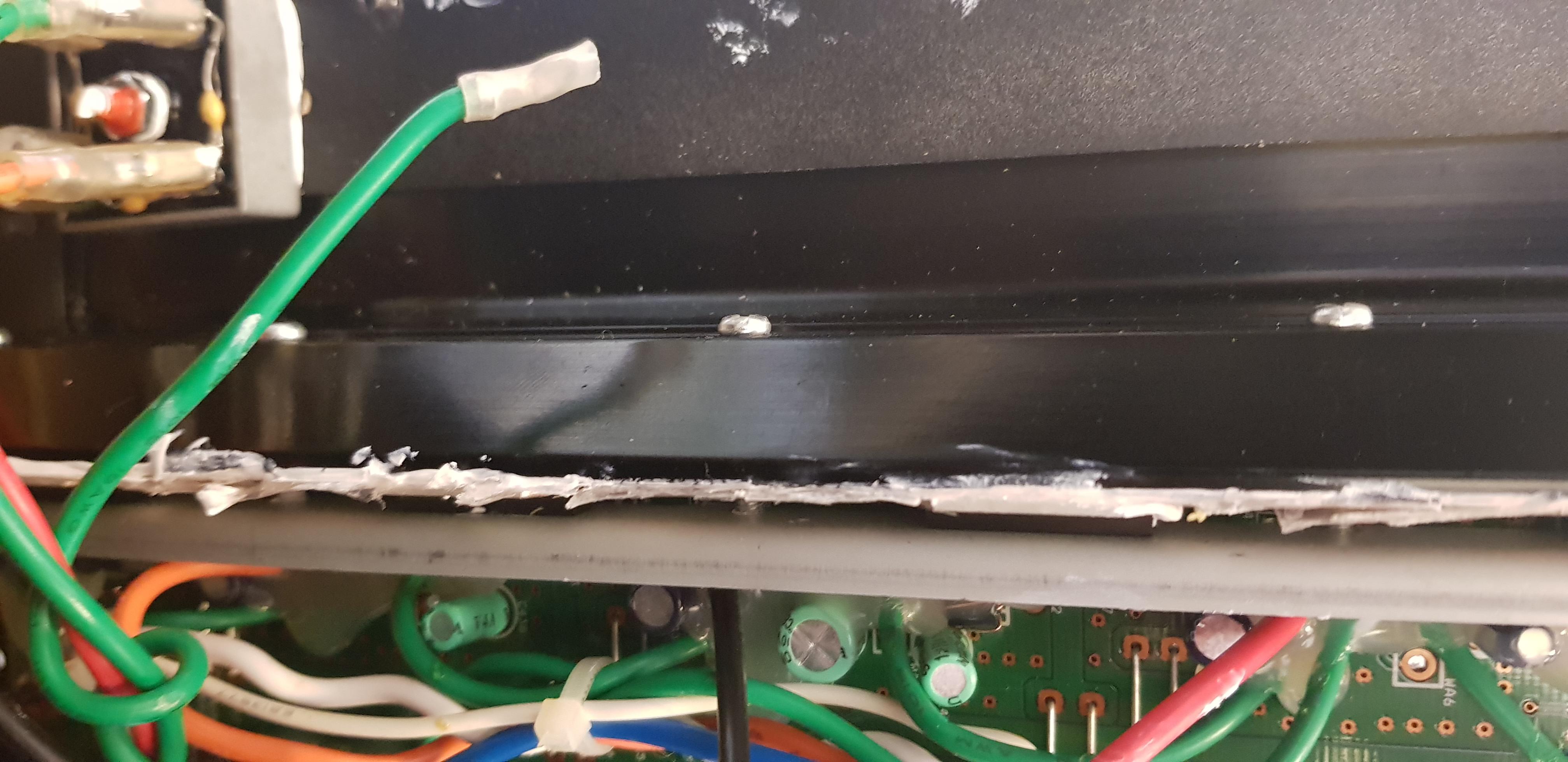

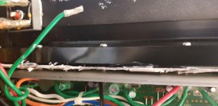

The Z-2300 has a design flaw. The chassis should be earthed next to the signal input only. This is done by two screws holding the PCB. (The two nuts on the side near to the input).
However, the PCB is also grounded with a green wire to the cooling assembly. (the wire that is connected on the back of the amplifier assembly). To get rid of the hum you can tighten the screws on the PCB to restore good contact, cut the green wire, or both. I did both and the hum completely disappeared!
Be aware that when you cut the green wire and the insulation between one of the amplifier units on the cooling rail fails, a large DC current will flow though the PCB. This can cause fire.
