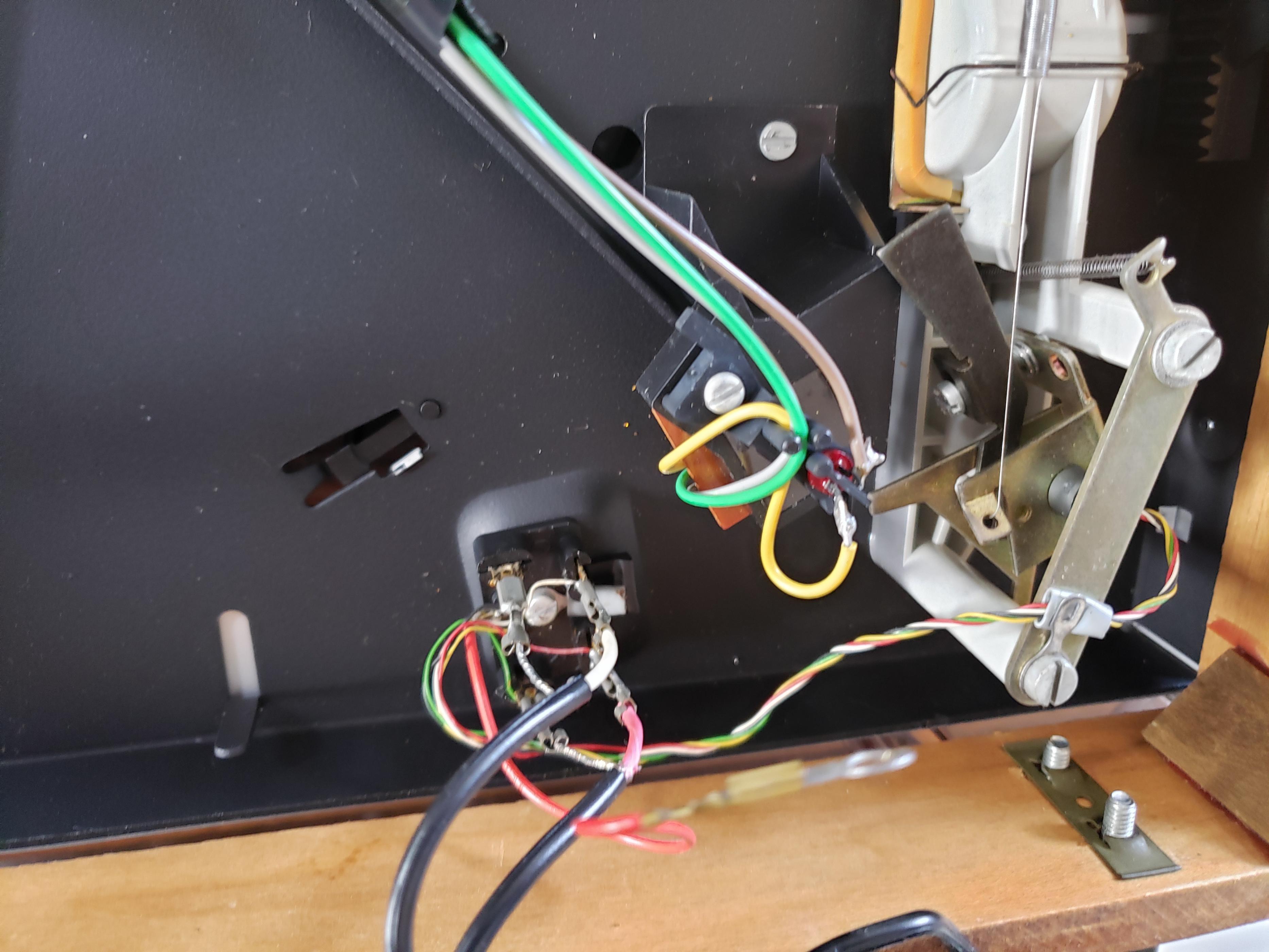

Thanks for the feedback. Photos attached.
I did attempt to check for loose connections inside the case. There are 1/8in wide spade terminals connecting the fine wires from the tonearm to the RCA cables that exit the enclosure. I removed each, buffed the terminals and reconnected them thinking that any corrosion probably wouldn't be helping me here.
The external wire for the chassis ground connection connects in this area as well via a ring terminal and star washer. I removed and reconnected that as well.
I get continuity between ground and all of the motor control board grounds and the chassis. The motor casing appears to be intentionally isolated as it is mounted on rubber bushings with no clear signs of an intentional ground connection. I get no continuity between the chassis ground and the platter, but its unclear to me if that is intentional or not. The metal tonearm is also floating I believe.
Outside of this and looking for broken wires I am not sure what else to look for inside.

Just a further clarification, the red wire with the ring terminal hanging out in space is a ground wire. It connects to the external ground wire and a foil ground plane on the bottom cover. I removed the bottom cover for the photos so I didn't have to hold it up. The transformer is also mounted to the plastic bottom cover near the white 4 pin connector on the lower left. In this photo, the front of the turntable is up.

Is the arm ground in good condition.
I had the same problem but only with my Linear arm, my Technics EPA100 was fine. But the linear arm has a carbon fibre wand so no shielding for the wiring. Grounding the TT chassis to the phono ground eliminated the buzz. My point is hum an be difficult to trace. The fact it get worse as the arm moves across the platter indicates the hum is induced most likely into the wiring.

I initially thought the metal tube of the arm was floating, but I think I was just not pressing my probe to the metal with enough force to make a connection through the anodizing.
Being new to this stuff, I have no sense for how common this may be, but this philips uses a little mounting plate that the cartridge bolts to, and that slides in and out of the tonearm head. There is someone on ebay who sells a remake of this plate. It's the best set of photos I could find.
Pats Audio Cartridge Holder - Philips 212 312 Turntable Plus Ortofon Super OM 10 | eBay
You can see the 4 pins for the signal and ground wires. In the head there is a 5th connector in the center that is a chassis ground. My original mounting plate and the photos of remakes I could find seem to not use this for some reason. Maybe just having the connector on the head side reduces crosstalk between channels? Anyway, the metal parts of the arm and this terminal in the head all show continuity to the chassis.

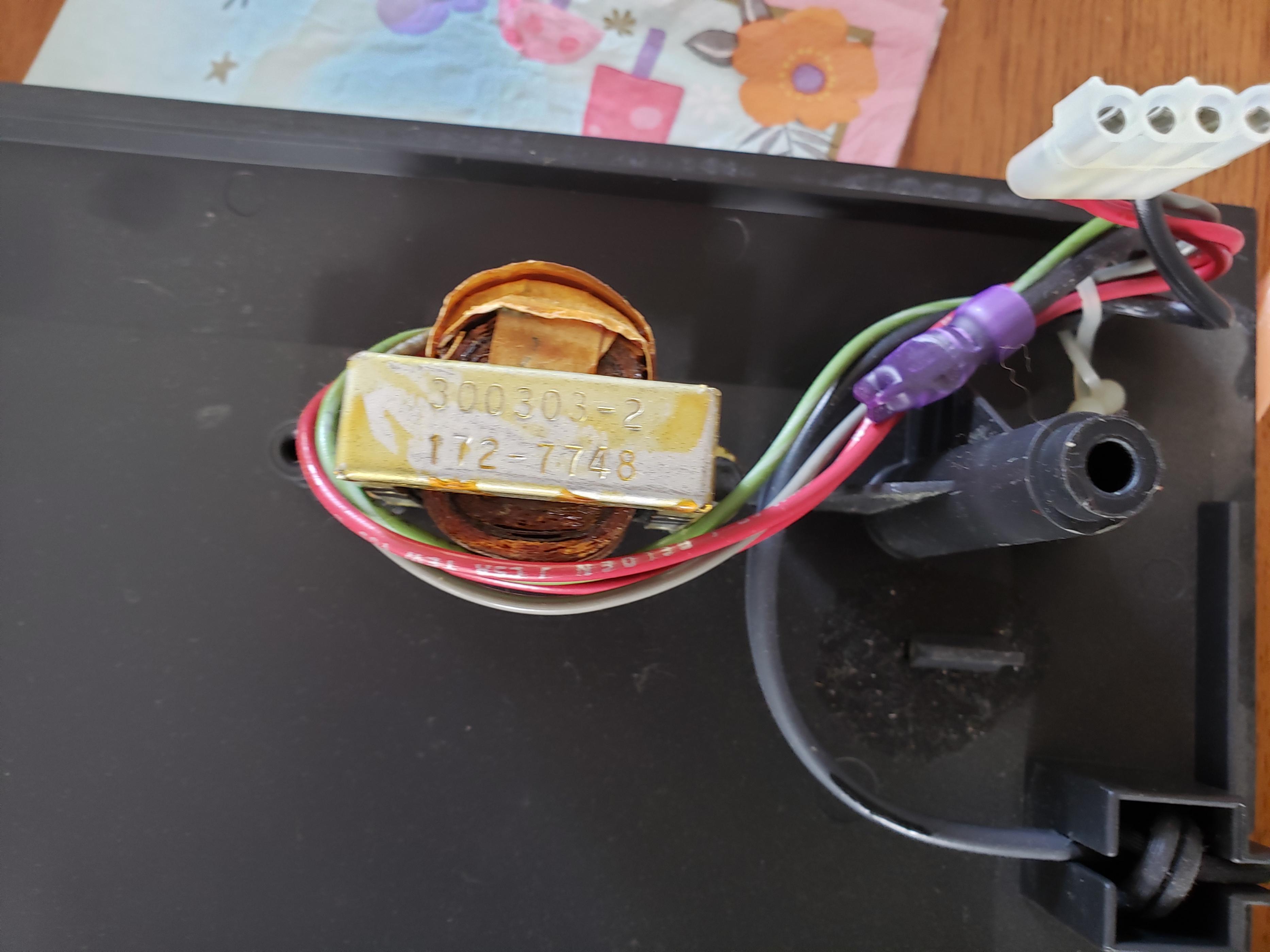

Also, I am attaching a pic of the transformer. Its mounted to the plastic base. No grounds. I suppose I could try chassis grounding its metal frame, but I got to wonder why that's not already grounded. I suspect that could create a safety issue if one of the windings fails and shorts to it somehow but I am not sure. This turntable has a 2 prong plug.I am leaning toward leaving that alone.

You could try rotating the transformer - the fields from EI types are very large and very much linked to the geometry of the core - so the orientation has a big effect.
Another option is to replace the transformer with a toroid. The Ametherm [sp?] types from Digikey feature very low external fields and judging by the pic, that one is probably a 5VA component, so about $15 in the USA.
Certainly worth going down the external AC to AC wallwart route.
