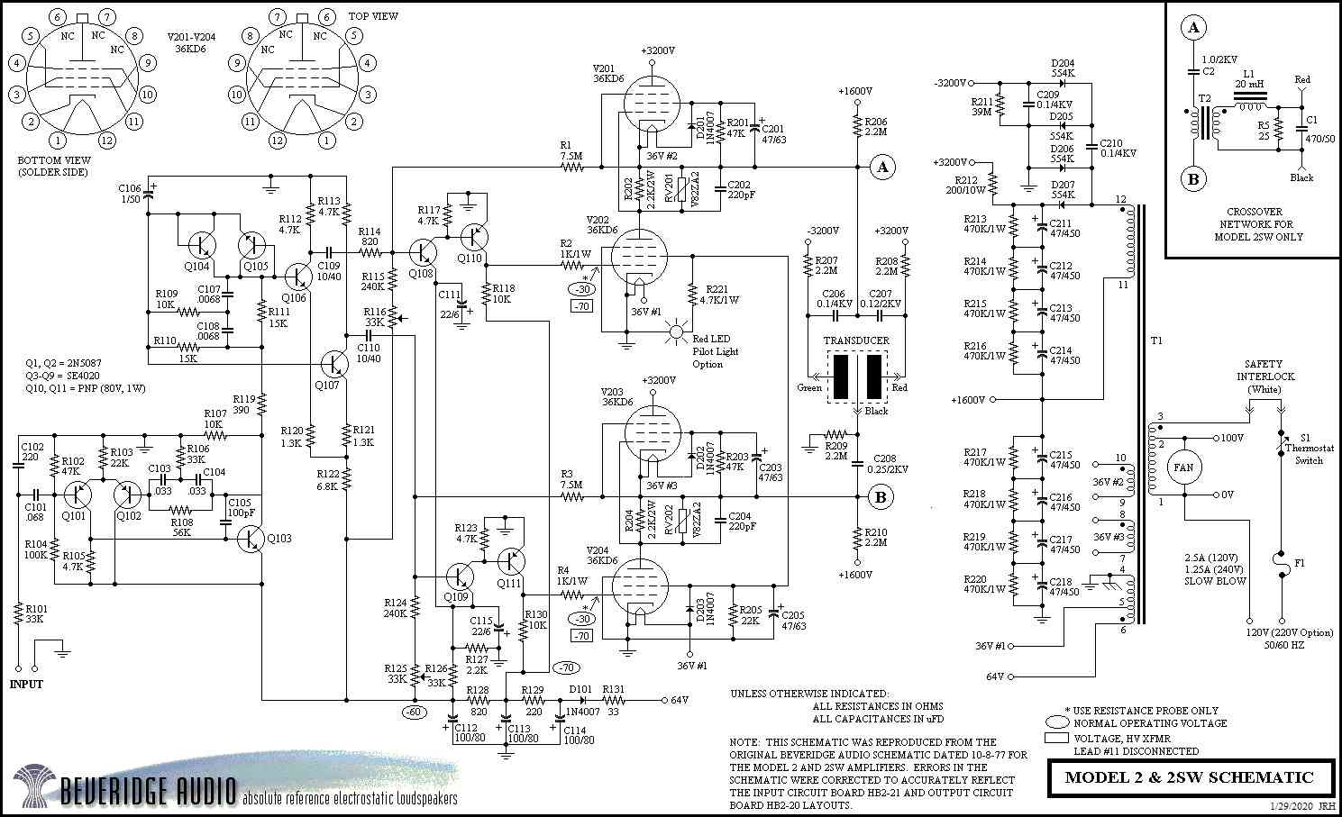

Hello. I am a new diyAudio member and have just registered now. I own a pair of Beveridge 2SW-1 speakers which I bought back in '79 as store demos which was the only way I could afford them, barely, and that was a sacrifice to do so. I got a real good deal on them. Back then Harold Bev came to the store where I bought the spkrs, gave a talk and demo on his system and I met him then( and much later on called him to ask what a good dummy spkr load would be). I am still listening to these going on 45yrs. For the first 20 yrs I owned them they were 'on' almost as much as my refrigerator. I have a lot of info I can share with fellow 2SW-1 owners in future posts regarding failures, tubes to use, etc., but right now I am extremely eager to get my left channel amp back up and running. I have read the posts from cvanc, kcin, and others regarding these amps and it looks like I'm in good company.
I have attached the newer redrawn amp schematic for referencing for my question(s).
The failure mode (there were other failure types in the distant past which I permanently fixed) I have from time to time is that any of three resistors in the screen/cathode circuit of the 36KD6's partially burn up which blow the fuse. They are R201, 203 and 205 which are 10K, 22K and 10K, respectively, half watt, carbon film type. In this case, R201 failed. I replaced it and powered up the amp again and I could only hear very low level lower frequency sound from the spkrs. I hooked up the other good amp to these spkrs and played fine with no issue. I opened up the bad amp and traced a 1kHz signal through the driver board to find there was no signal at the collector of Q110. There was signal at collector of Q111. So the stators (electrodes as Rick Bev calls them) were getting no audio signal and the diaphrams were. So I replaced Q110 with a suitable equivalent (BD140) which did not fix the problem. If I remember correctly, there was signal at Q106/107 collectors. So after doing some more probing with my scope the amp started to blow fuses when I would turn it on and V204 tube arc'd bigtime in the base area of the tube. Q111 collector (which has signal) is tied to grid of V204 through the 1K (910ohm in my amps) resistor. The dilemma I am having in trying to continue probing is that in order to see the signal at the Q110/111 xistors, the HV has to be connected so there is feedback present through R1 and R3 at the bases of Q108/109. I confirmed this by disconnecting the HV on the good amp and seeing there was no signal at the collectors of these xistors when HV is disabled Back in the mid 90's I bought and built the softstart circuit boards which Ron Welborne (Welborne Labs) sold and installed them right over the main pwr xformers using 3 nylon stand-offs. They still work and are preserving the main xformers. Something I will try tomorow is to bring the mains voltage up very slowly with my variac and see if V204 will live and not blow a fuse so I can continue to check for signal at Q110/111 collectors. Measuring input and output voltages on the driver bd, up to the Q110/111 collectors, I calculated 28dB voltage gain.
If anyone has any suggestions/ideas to try please pass them on. Thanks much!

Simple stuff first.
Do you have all of your voltages ? Is there an ac component on them?
I would check the varistors and the 47mfd caps for shorts and diodes for open.
Are your tube sockets clean and tight no carbon tracking - board is clean.
You should prove the low level circuit board works in both amps swapping boards is not that big of a deal.
Do you have all your heater voltages stable over time
If you pull the tubes do you blow fuses? Can you raise voltage slowly and monitor current.
Are you able to test for leakage across the the windings in the transformer with a megger? Honestly there is not a lot there. If all the checks above are positive statically then I would suspect your transformer.
Q110/111 Side note- the BD140 should work although the beta is higher than the original Toshiba S1376
I found that the closest sub was the the Motorola MPS-U56 Vce80v or the bigger brother MPS-U57 Vce100v -in fact in some very early documentation on the the schematic from Beveridge he notes the MPS-U56 as the Q110/Q111 transistor.
Both these Motorola transistors are correct pinout EBC of the original and both of them are discontinued... they still exist out there though.
Modern available equivalent from Central Semiconductor is the CEN-U57 - Central seems to take old designs and resurrect them- the CEN-U57 is an exact copy of the Motorola MPS-U57---fyi and as resource for others if ever required.
Good luck

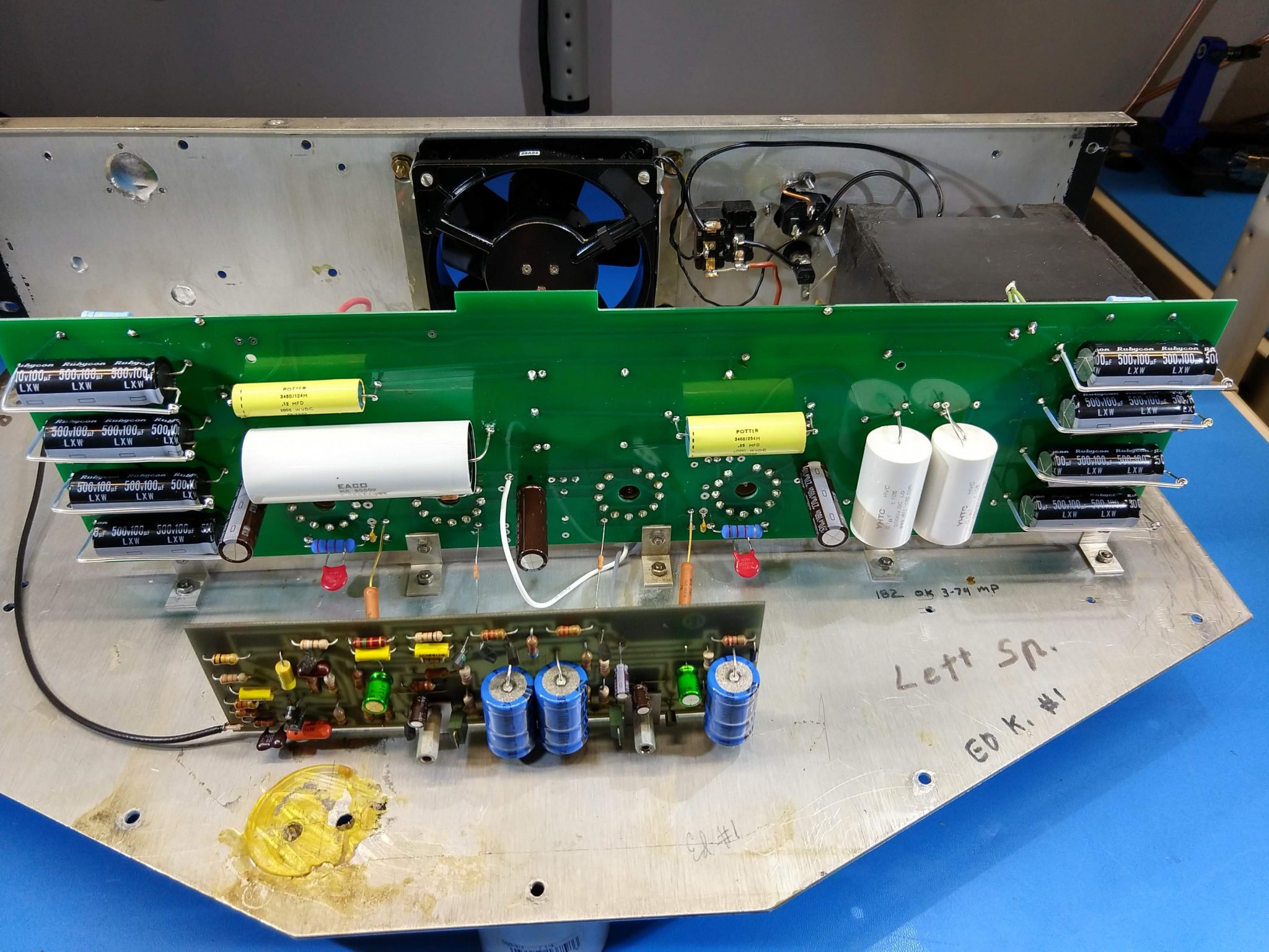

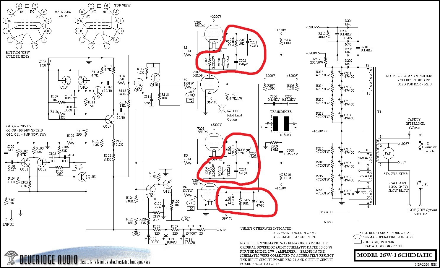

I think you should rebuild the "mid-point" of both totem poles including the screen supplies. You want better grade parts in there anyway, just get it behind you now.
Remove the 3 electrolytics you've added on the back and replace with ones that stand up, you will then have all the space you need. Photo gives the idea but does not show my current parts.

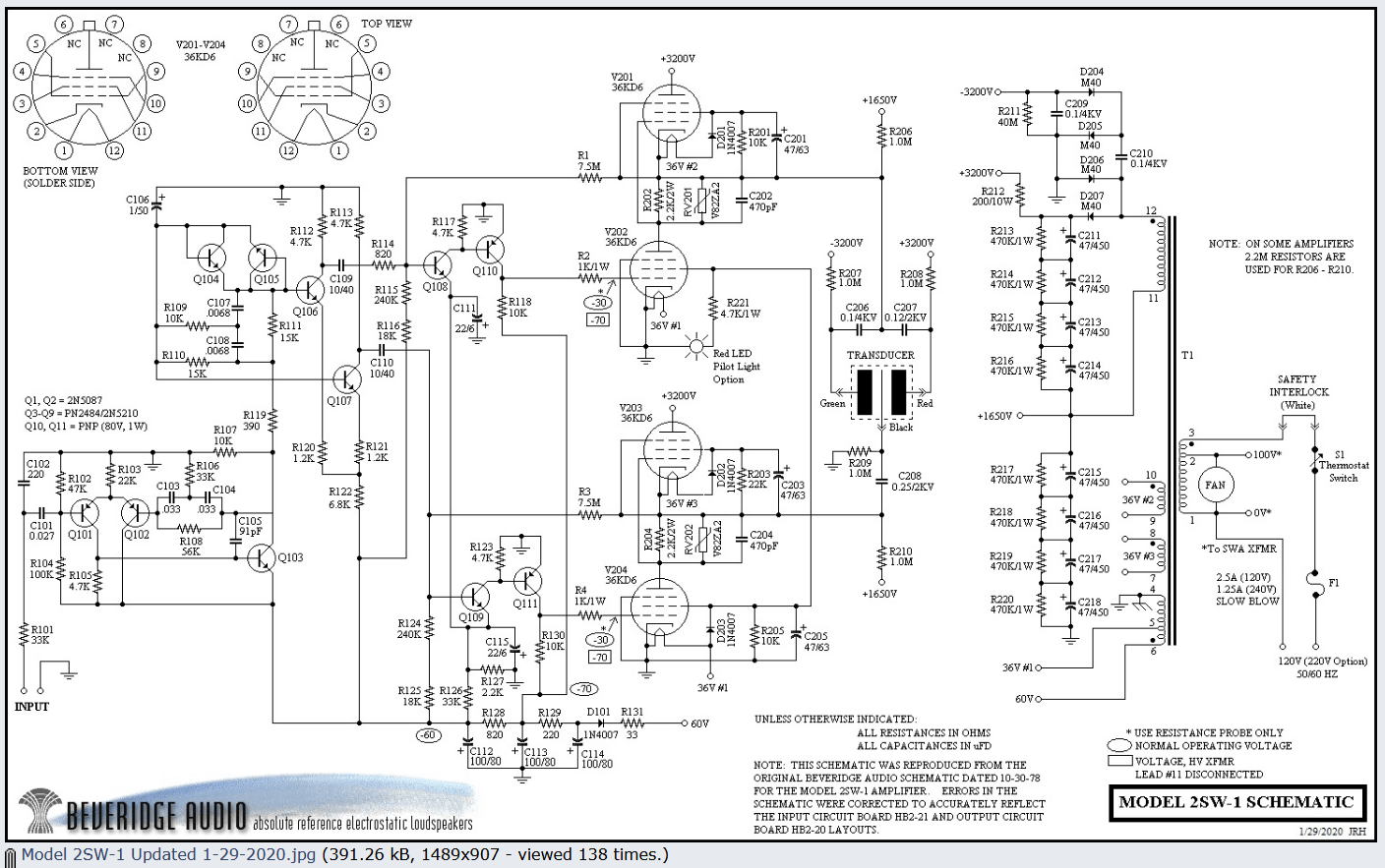

My screen resistors are 47k not 10k ...as in the diagram attached. I also have the 2.2M isolating resistors not 1M .

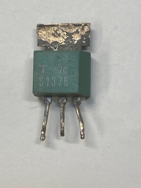

On the Toshiba S1376 output transistors... my boards came with them and my observations on many other boards show that they are original.

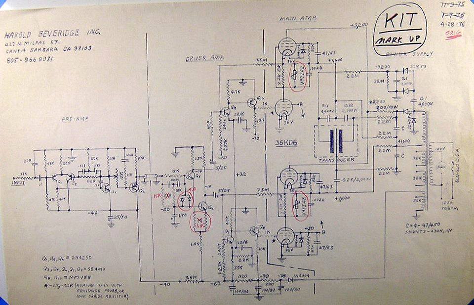

On one of the hand drawn Bev amp schematics it is noted that the outputs are MPS U56. The MPS U57 is a sister device with 100v CE rating.
Current Transistor that is the same pinout and rating is the Central Semiconductor CEN-U57.
On RAM.. I had spoken to Roger, he definitely did not design these amps but certainly was involved in their production and the crossover boards.

For clarification, when you mention 'mid-point' you mean the +1650V totem pole, correct? Also, for example, can you tell me the DC voltages you read at the suppressor, screen, and control grids of V201, quiescently (i.e., with no signal input)? What is the DC voltage measured at the speaker side of the 1M resistor (R206)? I have never measured these voltages on my amps for fear of blowing something. I always wanted to be able to see the actual audio signal as well that rides on the DC screen voltage (i.e., at R206, the side that goes to the stators (electrodes) and the signal at R210 (1M going to the diaphram). Can I safely do this after I AC-couple my scope using my X10 probe? I float my scope with a cheater wall adaptor. What kind of AC voltages do you see with a few mVs of input signal? Do the tubes produce additional gain on top of the gain present at Q110/111 collectors and if so, how much? On the 36kd6 data sheet I read that it has an amplication factor of 4. If there is gain, do you know how to calculate it? I would imagine the screen and plate resistors are part of the calculation. I tried measuring the feedback -30Vdc at the 7.5M FB resistor but only read -3V. I think this was a bad connection to my meter and I need to clip the alligator clip on the probe to the 7.5M and try it again.

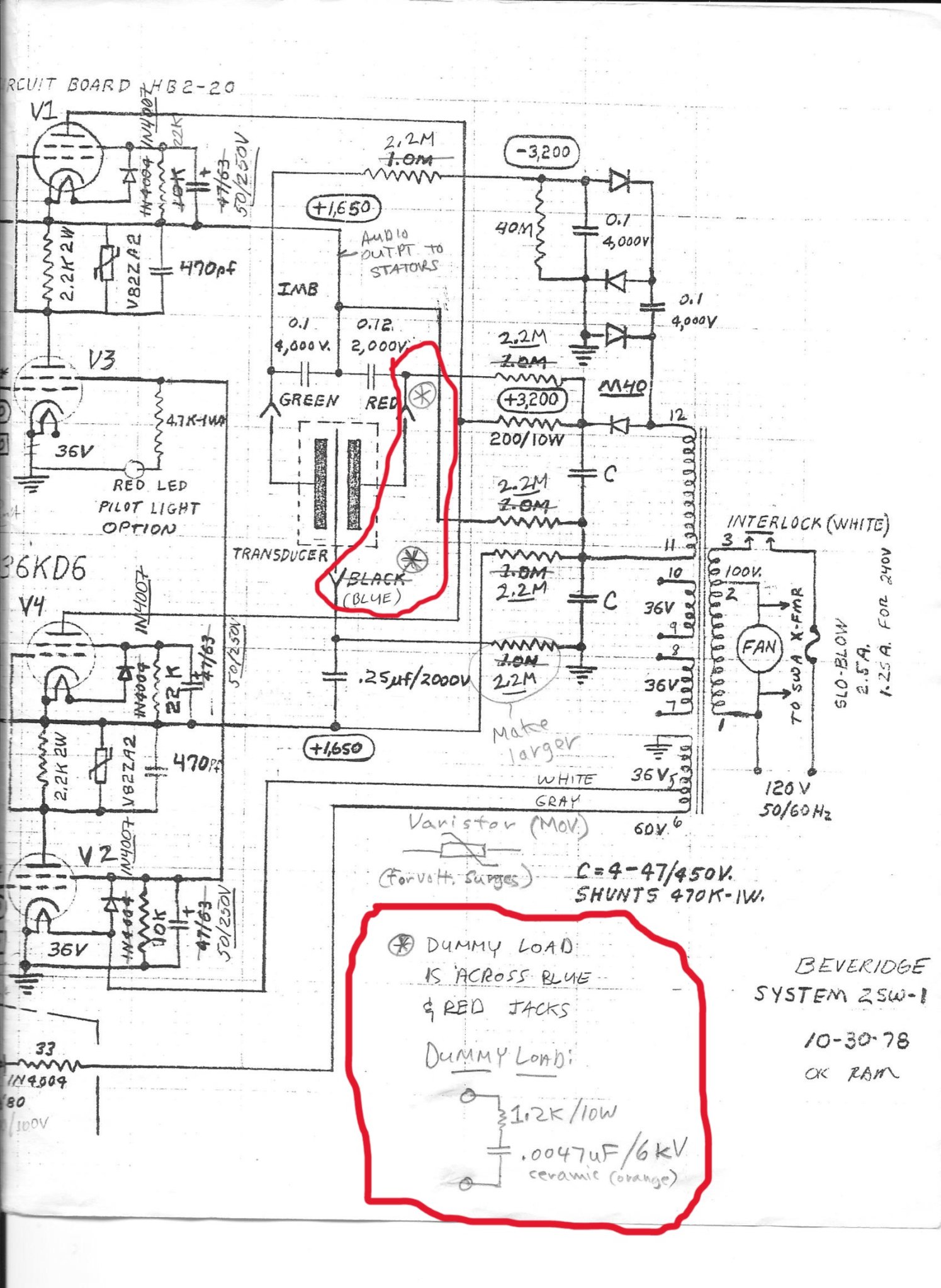

I attached a marked up schematic of the output half of the amp showing how to connect the 1.2K 10W/.0047uf 6kV ceramic cap dummy load to amp. You only need one dummy load, i.e., one resistor and one cap. I connect the resistor end to the '+' red banana jack and the cap end to the black (blue on my amps) diaphram jack. I doubt that it matters if you connect resistor end to the '+', red or '-' jack, green, either polarity should work. This load works fine and I used it whenever I needed to troubleshoot.

Thanks for the info and history on the Toshiba driver xistor and extra thanks for the very original Bev schematic. I searched for and could never find either one online. As I mention previously there are no markings on my green xistors and the schematic only said, "80V, 1W".
This must be the circuit for the amp that drove the original Model 2, 2-panel (as opposed to 3) speaker. I would guess then that Bev may have very well designed the original circuit. He designed tubes and defense systems for Raytheon in the Boston area before he moved to Santa Barbara. I just it weird that 'RAM' was on all the dwgs.

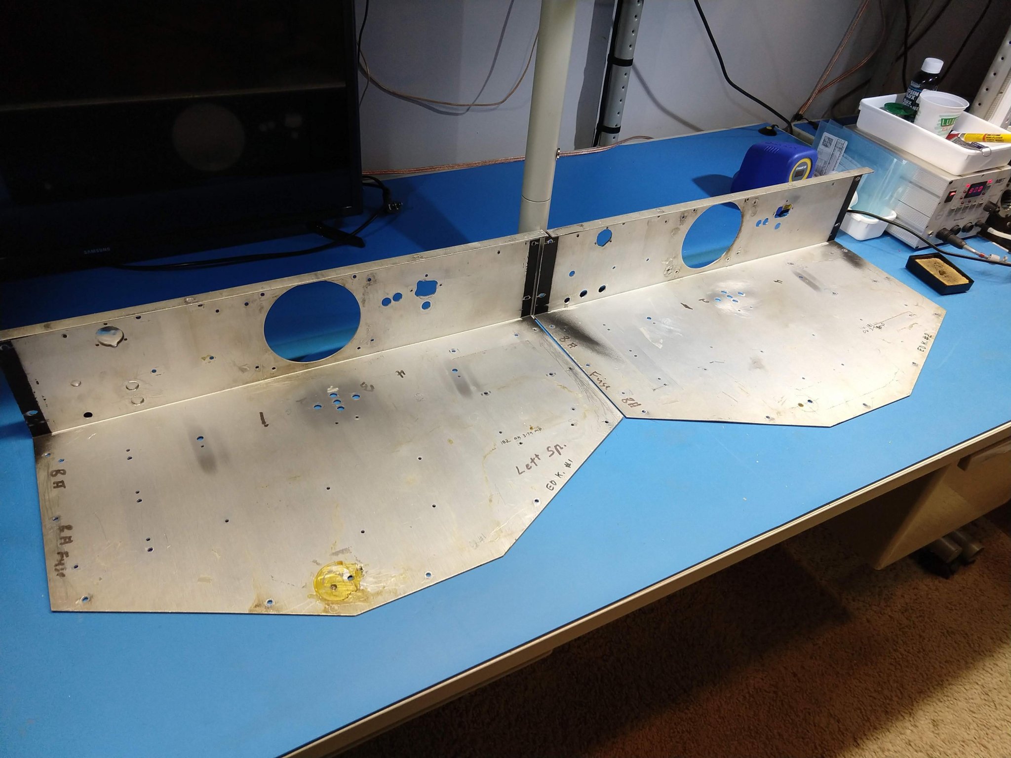

My pair of speakers were flood damaged burned up hacked on barn finds when I got them. Nonfunctional. They had been "fixed" and "upgraded" by someone who did not know what they were doing and should never have been in there. There had been fires in both the amps and the foam in the speaker cabinet(!).

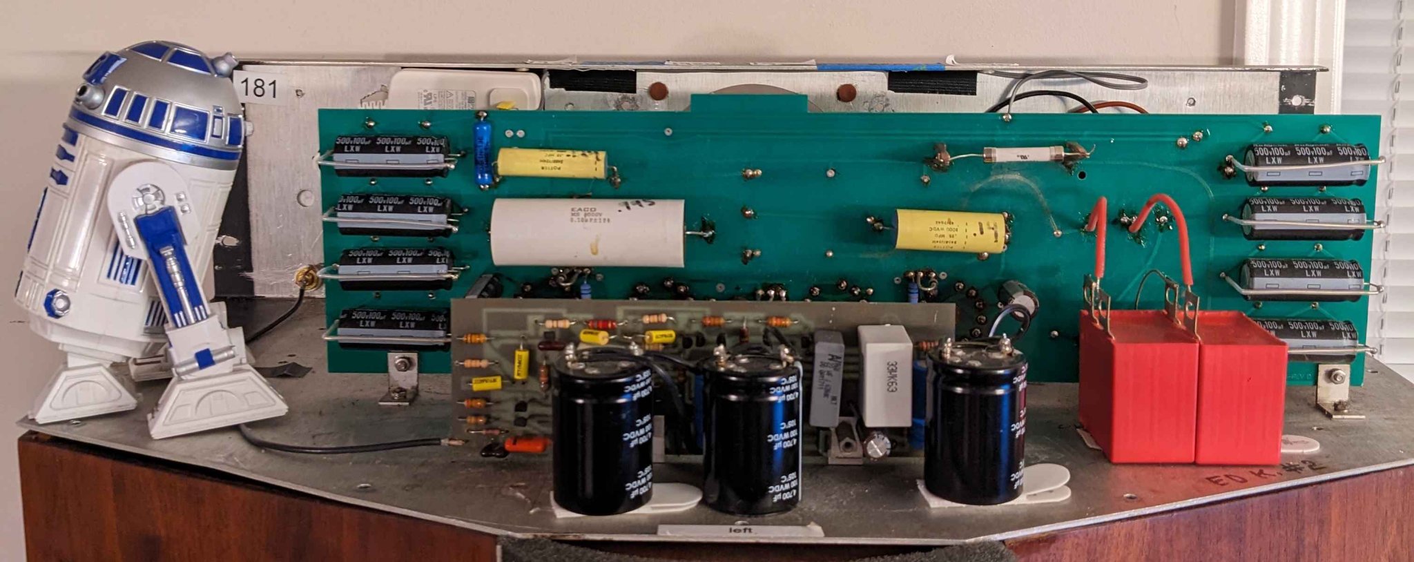

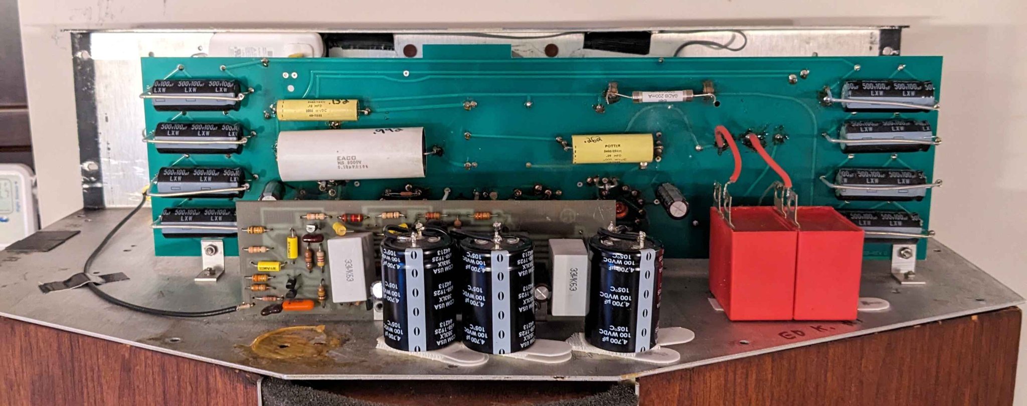

Circuit boards: The small driver boards are original but both of my large output boards are new.

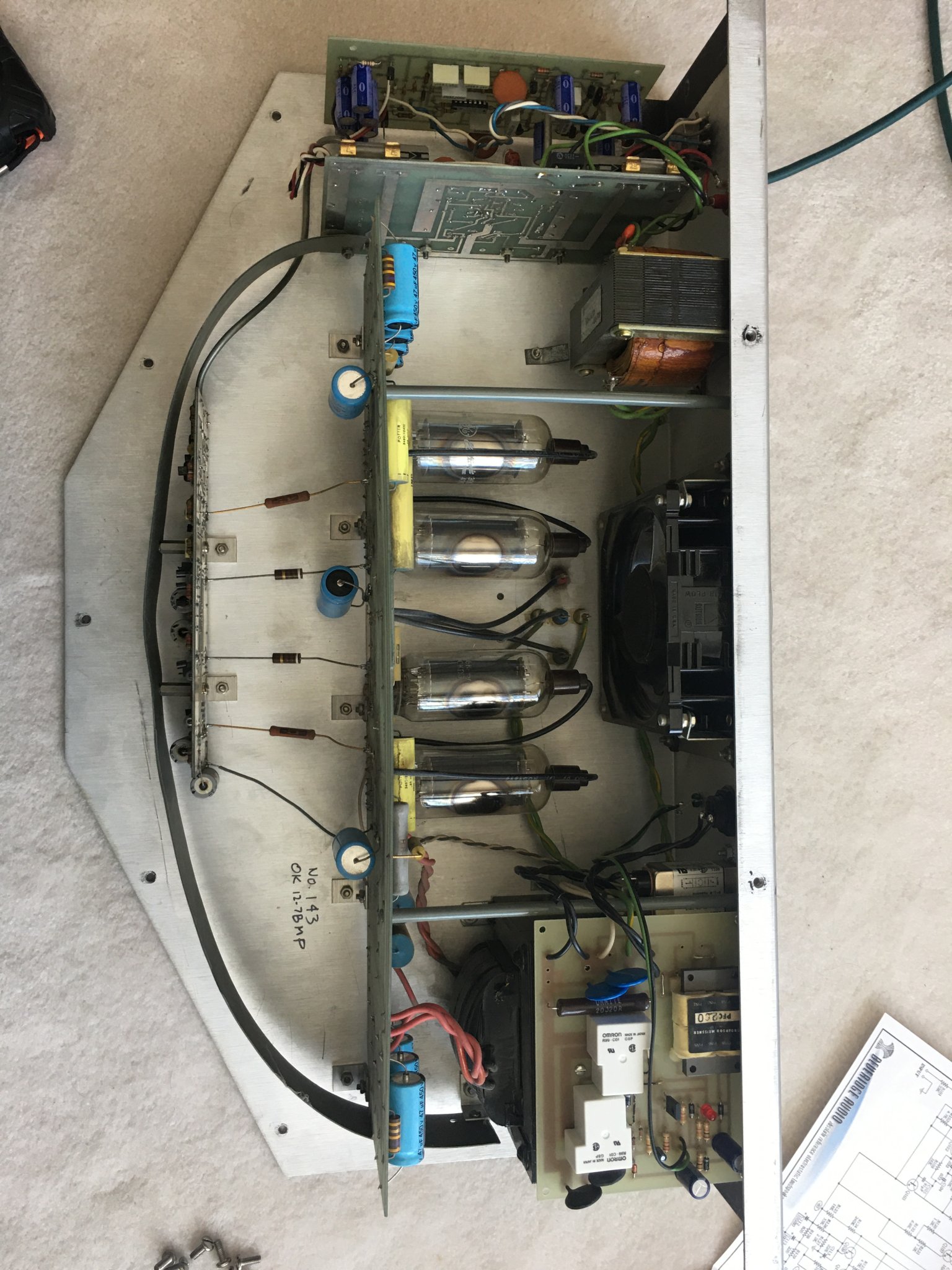

Pics attached showing how tidy they first looked after the rebuild and then the progression as bigger & bigger caps got fitted. It's all quite the FrankenBev by now but it remains, more or less, the original schematic.
I'm very aware of the dangers of using a cheater plug for my scope. When I first start troubleshooting the bad Bev amp 2-3 months ago. I thought to protect anything from failing on the driver board referencing to gnd something that shouldn't be, I used the cheater adapter since I was still getting acquainted with the board. After I probed the board where I needed to and realized the circuit is SE throughout and is just a diff amp used as a phase splitter and was ok to use the scope probe w/gnd clip. By that point I never thought to remove it. I know that's a dangerous mistake. It's been removed. When I was still working we would test car audio amps which had balanced outpts which required the use of a scope set to 'Diff' mode or use a plug adapter to float the scope otherwise the output ICs blew.
Looking at your amp's pics I see you are using 100uF caps in the totem poles. That's an additional 424uf from the stock total capacitance. Doing this significantlly increases the charging current putting a bigger strain on the tubes at turn ON, at the tube plates specifically, especially with the very high voltages involved. I was hellbent on doing this with PS filter caps in my beloved Mac MI75's when I refurbished them but after confering with some guys at another audio blog, I got talked out of doing it. Yes there would be bit more bottom end to be had, but it wasn't worth deceasing tube life for it. The amps sound great just the same. This stuff can be done with SS stuff which involve much lower voltages with no issues. Do you have a full front view of the tube board?

Dude. PICTURES! Need pictures of your cool Bev stuff. Open baffles? Your own stretcher? Don't be a tease 🤣
I've owned my pair for 5 years. The new blank boards were made by a friend of mine here in Chicago many years ago, he had a couple extra sets and I got lucky. They match the original layout.
Thanks for the Harold-approved dummy load info! This is something I did not know. For others reading I can confirm these amps will run fine on the bench with no load, a load is not mandatory, but I have plans for testing with one.
It seems to me whether your resistor is noninductive or not is a BIG deal here, I went with inductive as I want the load to ease up a little at HF.
When I say mid-point I mean between the upper & lower tubes (where the Varistor is).
Each of the 3 half-wave screen grid power supplies run off the 36V filament winding that drives their respective tube. This defines the voltage across each screen cap at about 51 Volts. Some early hand-drawn schematics have this voltage noted on them.
Of course both of the 'upper' screen supplies are elevated & sitting on +1650VDC. The single 'lower' screen supply is shared by both totem poles as they share a single filament winding.

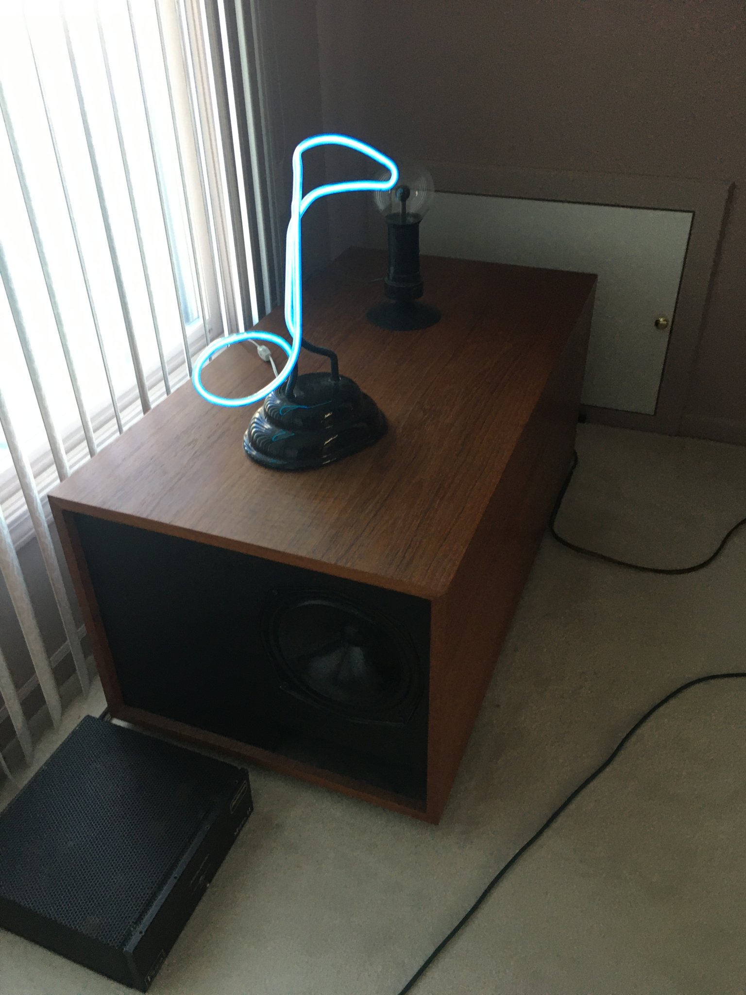

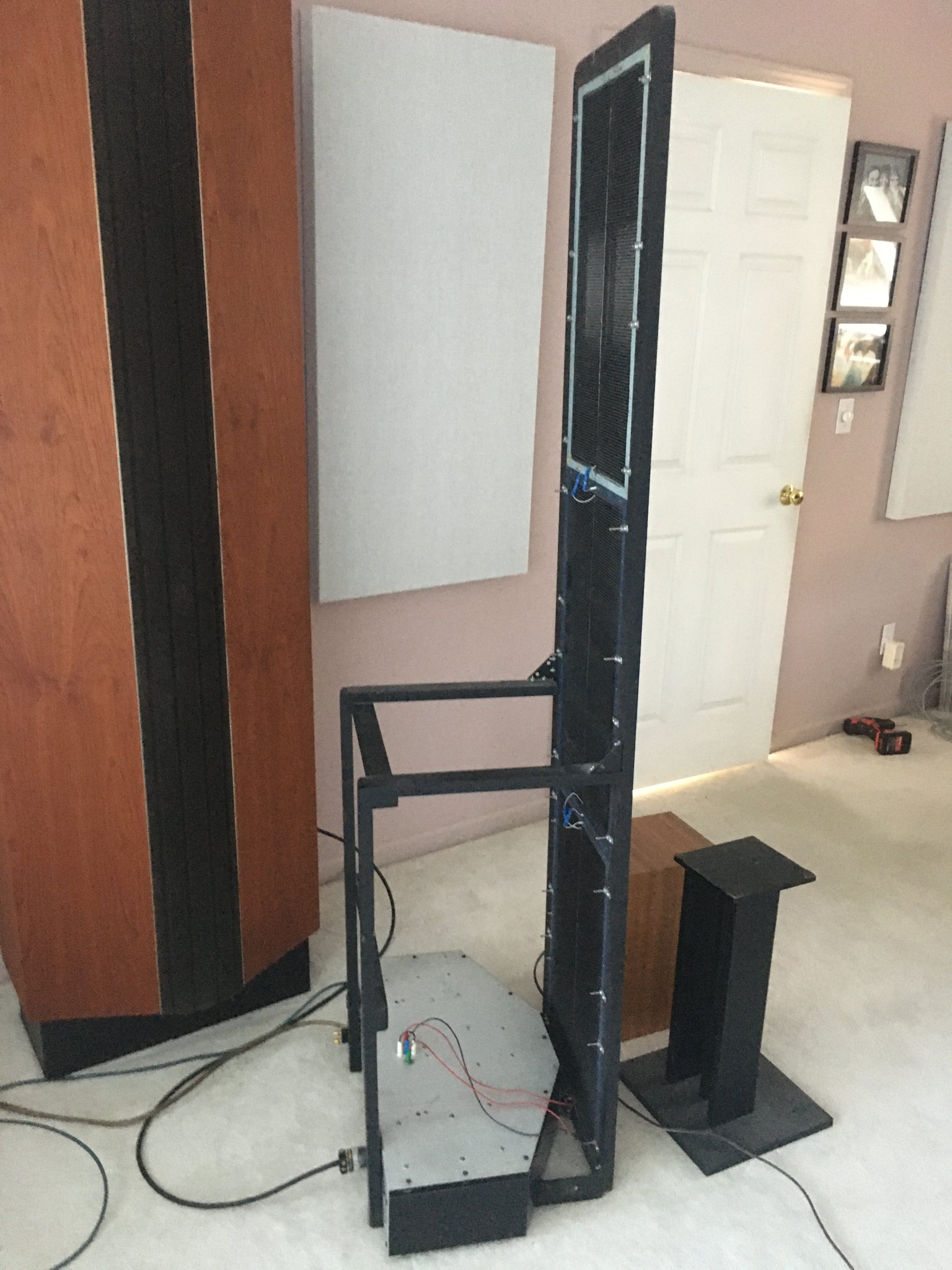

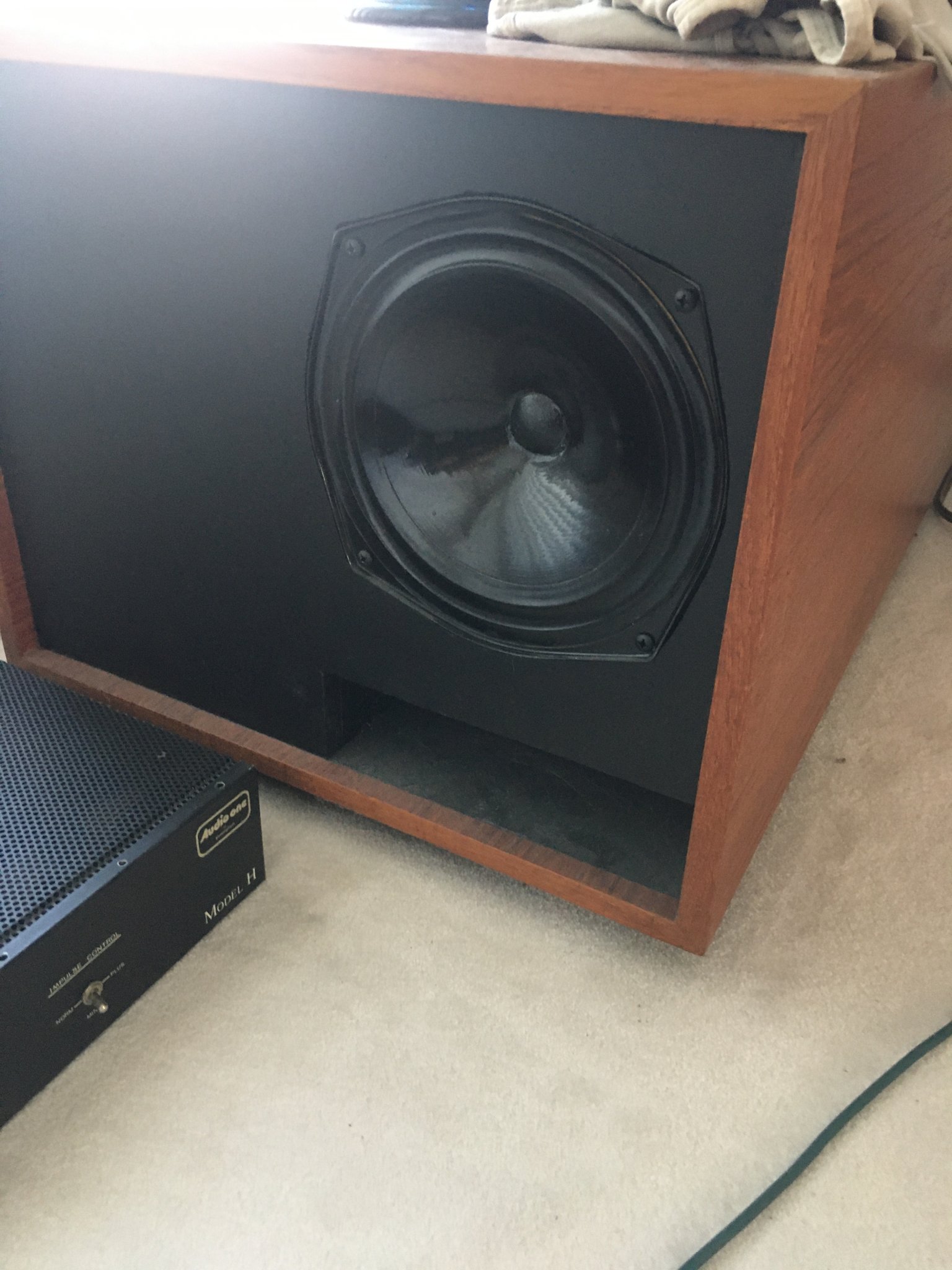

OK, OK. I have attached some pics of my Bev system below, but first per your post from last Thurs. So it may be understood, Harold Bev didn't approve anything. I asked him by phone many many years (early '80s) what would be a good dummy load to use when benching a Bev amp. HE told me to use the R & C values I gave you. The 10W, 1.2K resistor I use is an inductive type and it works just fine..been using it for many years if I needed to. It really doesn't make much difference.
Referring to the new corrected schematic from '20, I have noted the 50V value on the screen caps on the very original schematic from '75. So the voltage at the top tube side (i.e., V203 cathode) where the varistor, 2.2K, and 470pF are tied together is ~1650V. (I have 2.2M isolating resistors in my amps.) What is the voltage at the other side of these components, i.e., the plate of V204 for example? What would the voltage rating of the 470pF be? Have you actually measured these voltages quiescently, with no input signal applied? I would REALLY like to see the actual audio on the diaphrams. With 1650VDC, I would be exceeding the DC limit of my scope after AC coupling it. Have you seen the audio signal at the diaphram? How can I see this?
On the topic of inrush current, I don't have to worry about that in my case because I have the softstart circuit to null this, but I don't see how, IF there is no IRL or other protection used, the tube plates would not be affected by this since the 3200V is going through only a 200 ohm resistor at the top end of totem pole. Regardless of rectifier diodes or not there would be large current surge.
On an earlier post you mentioned that you don't use load resistors when testing amps That could be very detrimental to the amps, especially if you are making power or THD measmts. They do need a load. This is especially so with SS amps. I learned that a very long time ago when I forgot to hook up my load resistors to my Mac MA6100 which has full complimentary direct-coupled outputs instead of the typical Mac output xformer (bi-filar wound) and wiped out the output xistors.
In regard to the attached pics, I will probably turn off some or all of the Bev owners with the first pic of my speaker panels sans cabinets & lenses. Back in the mid nineties I had a great curiosity as to how the panels would sound out of their cabinets and mounted in a suitable wood frame. I was longing for more top end, detail and more focus of voices and instruments from left to right. I new I would be giving up the great front to back depth. So I got some 1- 1/2" X 3/4" poplar wood pieces which is very much cheaper than oak but almost as strong and dense, some fastners/hardware and built the frame(s) you see - all for not that much $$. After finishing them and many hours of listening, my suspicions turned out to be correct. I did miss the depth of the soundstage and greater stereo field the lenses provide but desired more, more top end with more upfront, intimate in-your face sound that you get in a jazz nightclub. I do listen to classical and other music genres but mostly jazz. Listening to the panels this way, the voices and instruments are more clearly placed and the stage has a less homogenated (spelling?) sound. (The Bev acoustic lenses are actually diffraction gratings [per wave theory]...when plane wavefronts goes through a slot in a barrier, out comes 180 degree wave fronts on the other side of the barrier. I may to turn my amps into 2SW-2's by adding the switchable input caps to the output board inputs to add either 3 or 6dB at the high end. I then might put the panels back in the cabinets and listen again.

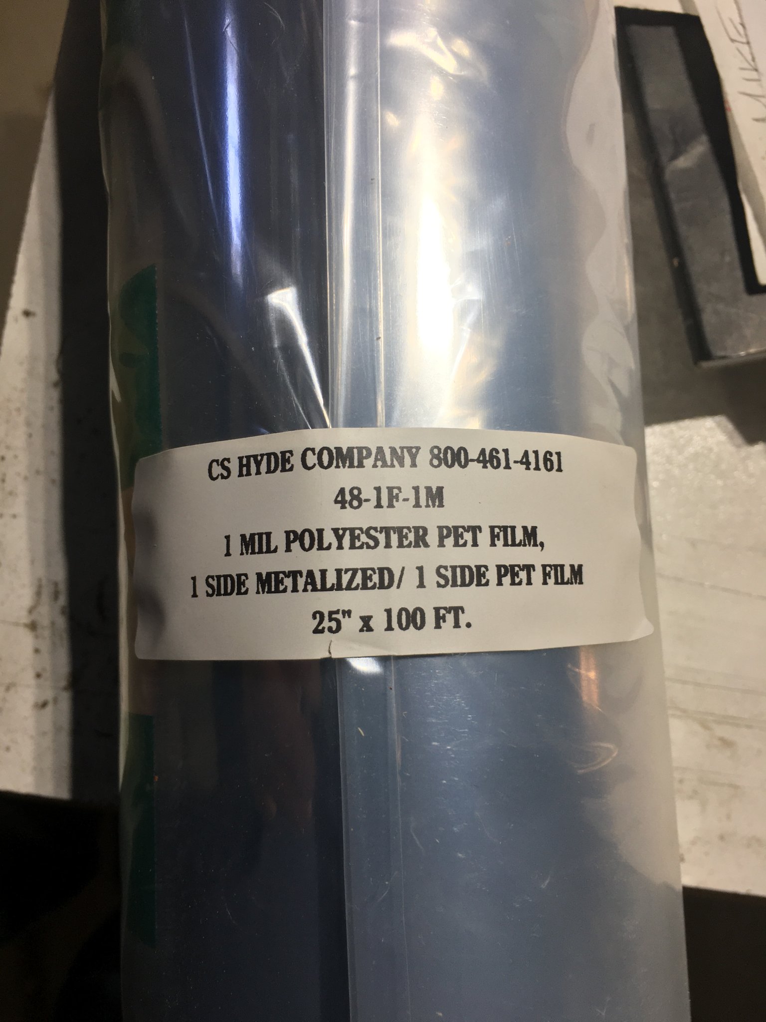

Lastly, if you want to try rebuilding a panel, I included a pic of the roll of mylar I got several years back from CS Hyde. I see you are in Chicago and CS Hyde is in your back yard in Lake Villa, IL. With my set-up, a 100' roll will rebuild 36 panels which should last a little while, ha ha. If you desire they can put 100' of it on one roll.
https://catalog.cshyde.com/keyword/?ddlSearchType=2&keyword=48-1f-1m

I think it's cool you got to talk with Harold. I talked once with his son Rick, in I think 2019. He was happy to hear from a fan and quite gracious but sadly the signs of age were already in place. The last I heard he was not doing well.
The dummy load was from his lips to your ears so good enough for me. I'm eager to do some bench testing with one and will grab some of the measurements you've asked for whenever I next have one on the bench.
I think your speakers are cool and hey we all just instantly learned you don't have a cat because he'd be dead by now 🤣 . You're running with three thousand volts on the outside? Warn the cleaning lady ":^)
I bet your set up goes much louder, right? I stuck a mic deep into the lens once and it was almost ten dB louder back near the transducer! The Beveridge Lens may be an acoustic miracle but it's quite inefficient.
