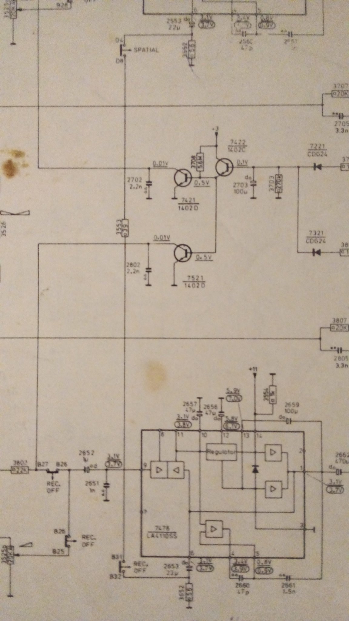

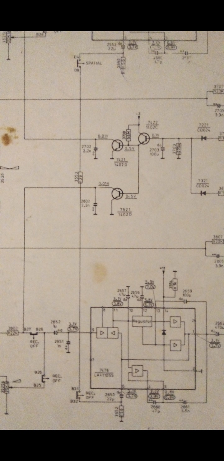

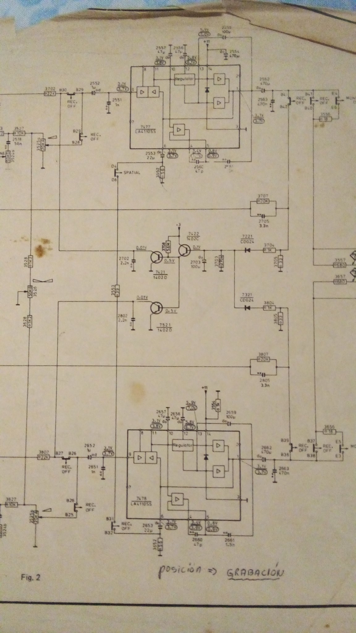

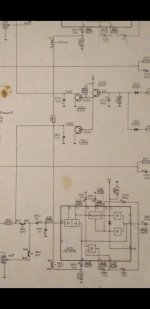

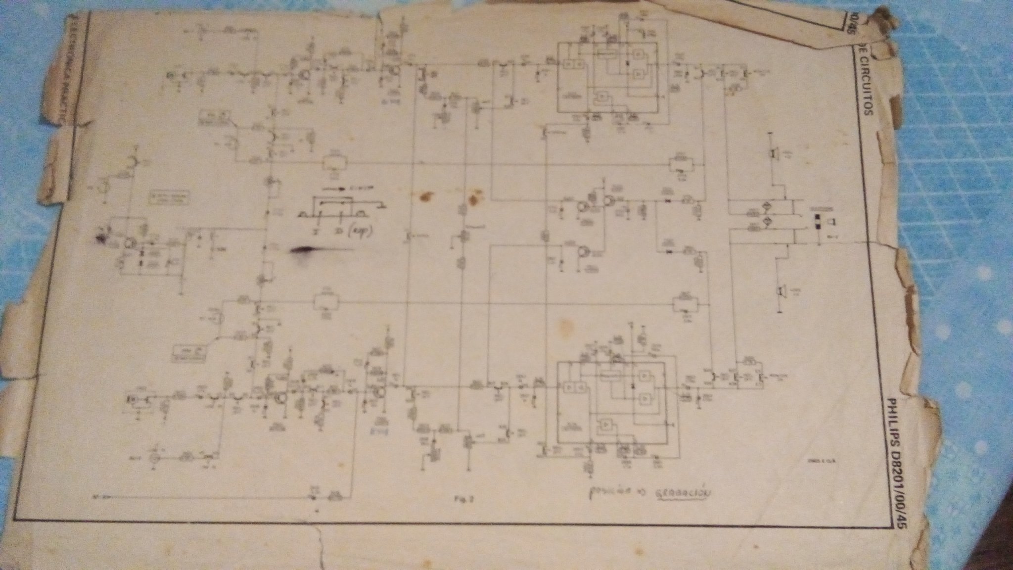

Here are the pics I promised. The global state is good for a paper that has over 30 years saved in a book. Observe the switch labeled spatial and a second switch ganged with the play/record control. It mixes partially both chanels. Again, it was a cassette player/recorder.

Thanks for sending. That's interesting I would have like to listen to that cassette player. Did you ever hear it? I had a coworker who wrote code to simulate vinyl playback, it was more involved than I thought. Wondering if vinyl playback has the same spatial effect because higher frequencies will crossover more and that seems like an enjoyable effect.
As the mix is essentialy resistive, it is independent of frequency. However, as the phase of the signals on two stereo signals are more easily encountered in higher frequencies (low freq are more similar in both channels) the effect tends to upgrade medium and higher notes.
