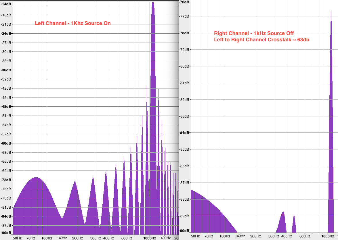

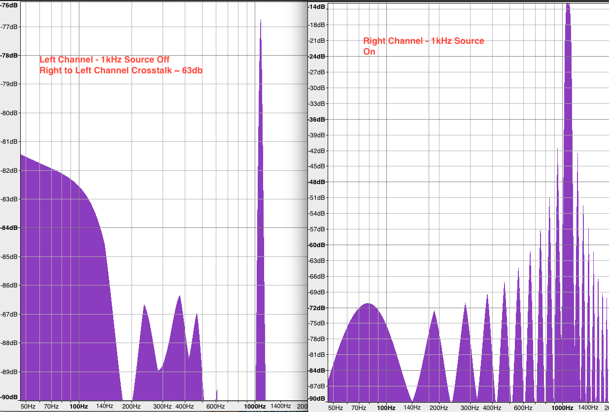

Update on measurements after shorting the unused channel
Crosstalk Left to Right with 1kHz sine wave - 42db!
Crosstalk Right to Left with 1kHz sine wave - 60db
However, I isolated the crosstalk!
It turns out it is the 7-conductor cable marked in red, that runs from the input to volume control and back! The cable is shielded but the 7 wires twist once every 2 feet. I replaced the left channel with a unshielded ethernet cable. Apparently twisted pairs make the difference!
Cross talk is now 60db+ in both channels!
I used this website as the signal generator and left/right panning.
https://www.szynalski.com/tone-generator/
And Audacity to record from the amp headphone output.
https://www.audacityteam.org/
Attached are the screenshots of the crosstalk. Unfortunately I didn't save the a screenshot of the Left to Right channel crosstalk before the fix!
Thanks again for the help!!
Now that I have a working setup I will use cat7 or cat8 cable as my input line cable.

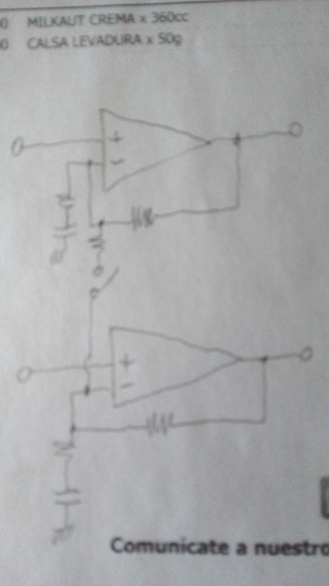

I have an schematic of a cassette player (don't remember its brand now) in which there is a simple switch connecting the two amplifiers of a stereo toguether with a resistor. They did that in the return of the NFB loop so its sum is partial and changed of sign (say, L - kR and R -kL with k<1). Let me see if I can find it.
Reactions: gghodg
The true circuit is at a book in mum's house. When I go, I take a pic. But rougly the idea was this:

Update: Replaced all internal input wiring with a single Cat7 cable I found on "A" which has shielded twisted pairs (STP), outer shielding, and a drain wire. Channel crosstalk remains the same at 63dB with a 1kHz sine wave. Also, the right channel thumping on changing inputs is gone! The only caveat is working with 26awg wire is delicate.
