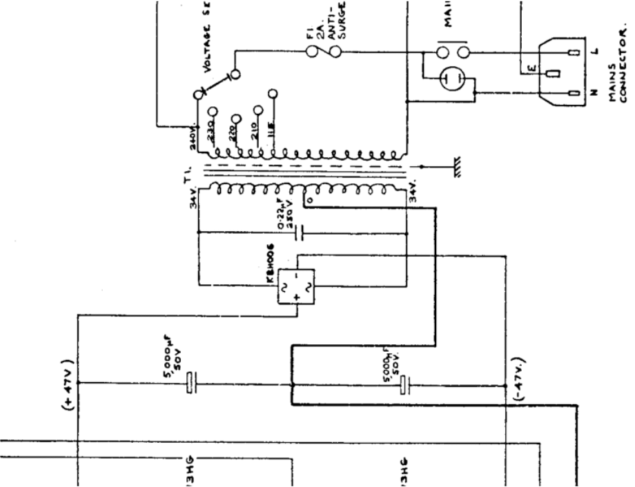

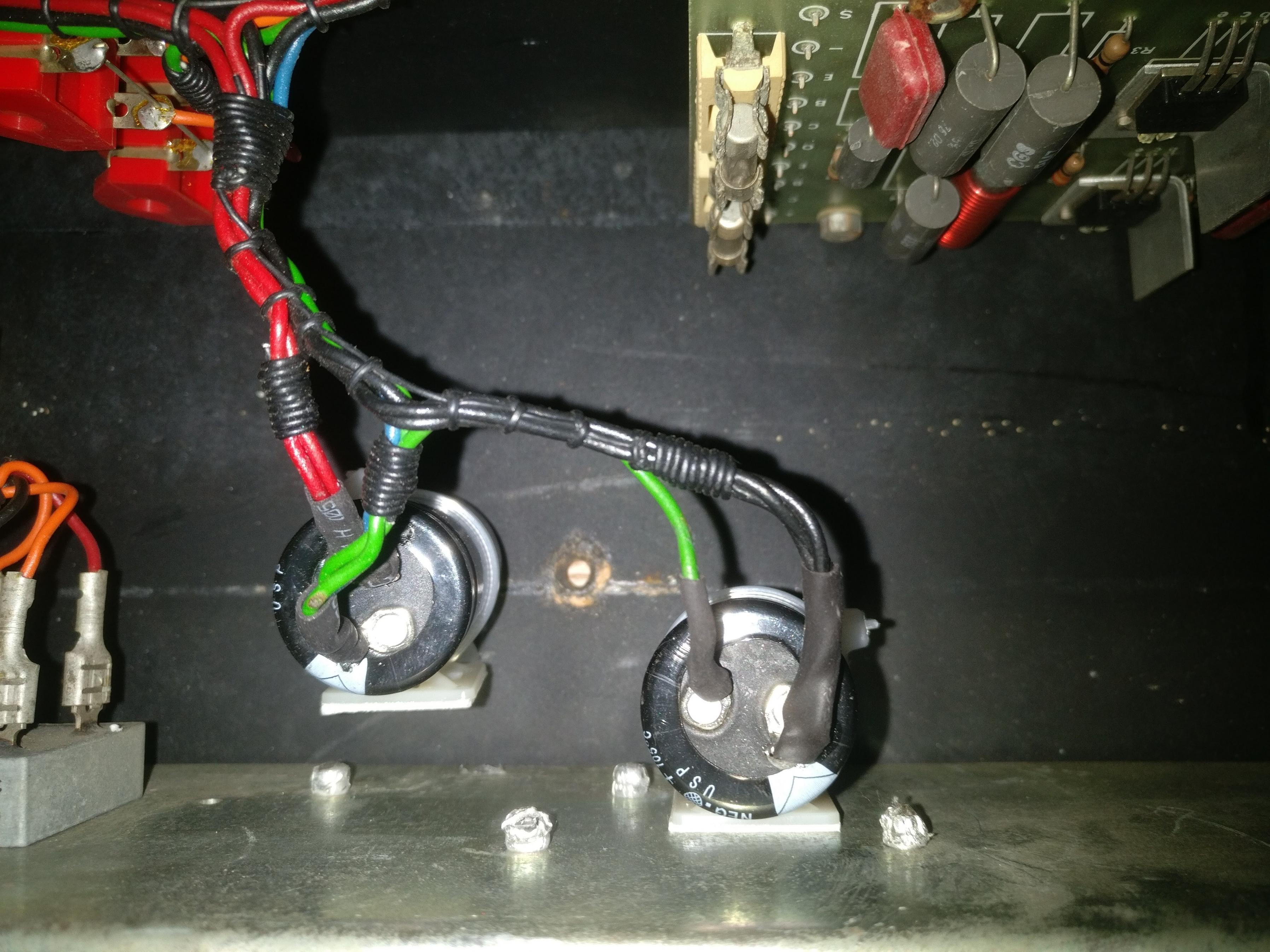

Hi Martin - Thanks, I'm going to try that tonight! Before I do, something has been troubling me in terms of the wiring for the caps. It's very neat but looks like it's in series (assuming green is ground).
I'm not good at reading schematics but they look like they should be parallel?

You have a bipolar supply, +47V and -47V, don't mess with it. Most ss power amplifiers use one.
Measure the DC voltage directly between the two capacitor terminals.

Just to avoid any doubt: The schematics are very clear that the filter capacitors are coupled in series with the (green) connection between the two capacitors being connected to ground.
The picture you have uploaded matches this - likely with the red wires being at +47V and the black being -47V (the colours assuming slightly normal practice).
Note that the schematics says 47V where you measure 50V - this difference is of no consequence.

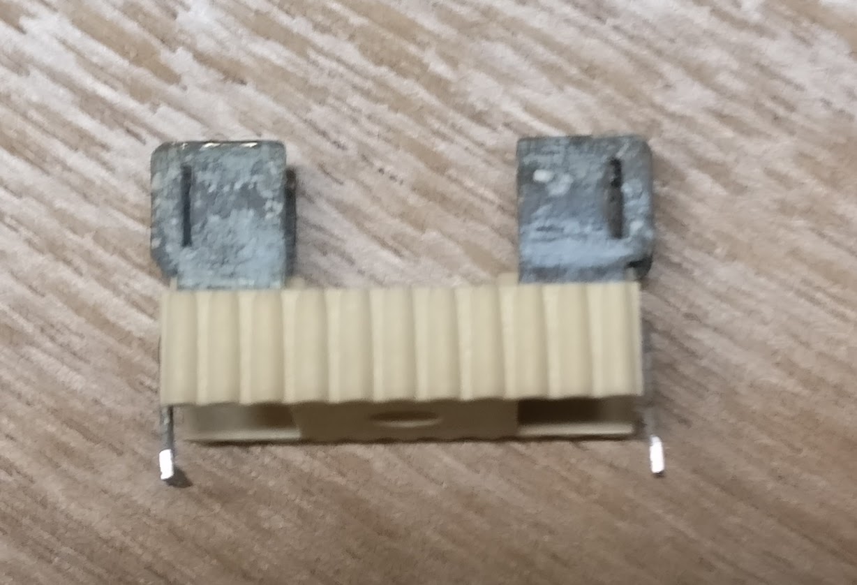

Sorry for the slow reply - work got in the way of tinkering! There was no AC reading at the output but having replaced the 4A fuses, I was suspicious of the fuse holders - they looked rather corroded. I probed them and they weren't passing current across. I ordered some new fuse holders and replaced the old ones (fuzzy picture attached) and hey-presto...it works! AC reading at output and plugged into the speaker it's sounding good!
Problem solved - many many thanks for your help.
