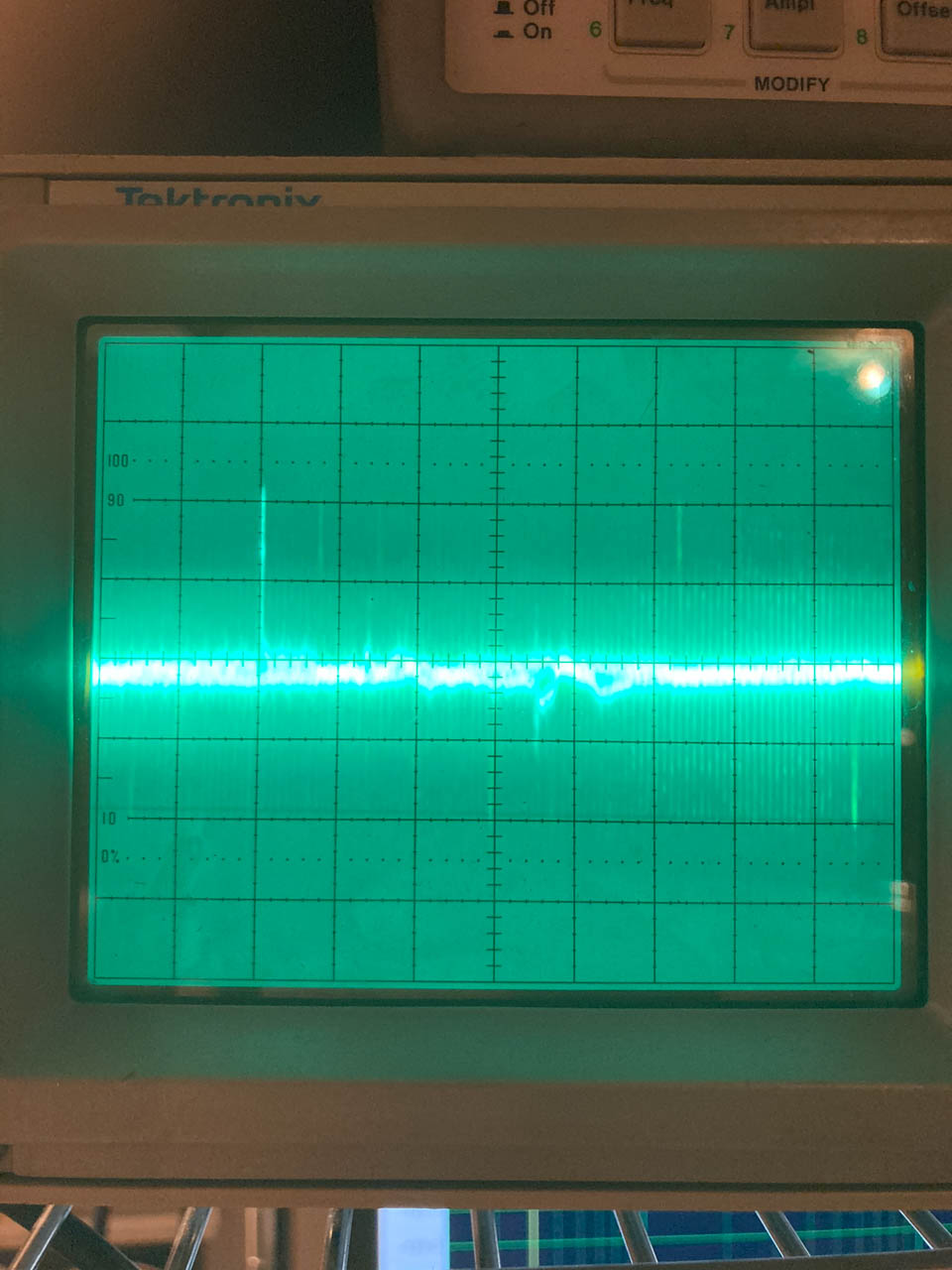

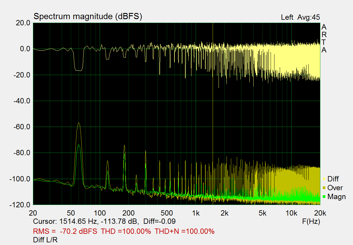

I was able to run a few additional tests.
1) Noise stays on same channel when swapping the input wires, which would lead to the issue not being the pot
2) That said, shorting the input on the problematic side (instead of the pot) eliminates the noise.
3) The noise is visible in this scope picture. There are 4 spikes in the frame, one very 2.5 divs. V/div is 2mV and SEC/div is .5ms.
That said, the picture may not be very useful because I think the CAL knob may have not been correctly set.
4) The sprectrum analyzer picture is an overlay of both channels, with the top plot being the diff. Clearly once channel is much noiser than the other.
Lastly, I put an L-pad of about 12dB on the HP output it was dead silent and still have more than enough volume through a 2/3rds of the pot, so that may be what I'll end up doing... I still would really want to solve this in case I ever use more sensitive speakers.

Very cool. Now you know where the issue is *not*, and that's golden knowledge. It's *not* anything about wiring or ground loops, or any other "external" source of trouble. So it's time to look into the "internal" wiring of the PCB. Good job troubleshooting and analysis.
