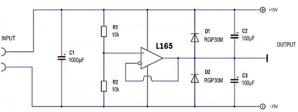

I have now spent nearly 4 days trying figure out a persisting problem with this L165 virtual earth circuit! No matter what i did, both the +/- voltages are quite assymetrical giving +11.84 & -12.08 or thereabout.
I even removed R3 & R4 as it was on an other variation of this circuit & it got worse! This particular reg. is a ST brand (Micro Electronics?). I also read elsewhere of d.i.yers experiencing the same problem with this particular device. I even built 3 seperate circuits, still the same problem persists on all of them. Could it be that this particular brand or batch is faulty?
Do any of you guys have any idea or suggestion as to what this problem might be due to or suggest a similar high current feedback amplifier(s), which can source at least 100mA?

Ahh....just remembered something! Since none of the scheamtics show the dc by-pass caps, I too didn't include these in my circuit! Perhaps this is what triggering oscillation thereby causing this problem???

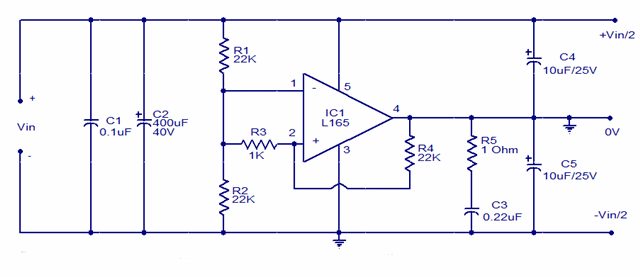

Can anyone spot a fatal mistake in the schmatic on #post 1 ? No prizes given though!

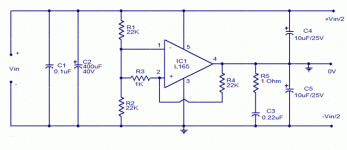

Thanks a lot! I did remove R3 & R4 & just linked these as in fig.2 but It just got worse, with the values shown in Fig.1! I will change these as shown & report back. perhaps these new values might help! It's just can't seem to get it exact on both rails!

I notice the data sheet says -/+6 volts as a minimum and then shows an application using -/+4 volts. It also in two diagrams has the inputs mixed up. Look at your first post and post #3. The + and - inputs are reversed. Post #4 is electrically drawn correctly but I don't know if the pin numbers are correct
The unity gain follower uses a 1k resistor between the inputs (which is technique to reduce the available gain) and this points to stability issues. You could alter the circuit to do the same with two resistors and then add a small (say 47pf) cap across the "feedback" to kill any tendency to oscillate.

Why not add a small pot in series with your reference between R1 and R2 of 100 to 500 ohms and connect the wiper to pin 1. Bypass it with a cap for noise reduction then adjust for the output you want. The output voltage is going to be determined by how well matched the reference resistors are. If they are not perfect there will be an offset. This way you can adjust the offset out.

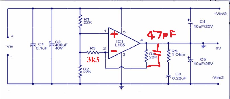

Transistormarkj, the circuit on #3 doesn't work & blowing fuses! I actually built this twice but with the same results both times! There are in fact 3-4 variations of this on the net! Only the #1 circuit works with the + rail 11.84v & the - at 12.08v from 24v supplied from 4 x 18640 batt. & through a buck booster. Tried with the dc caps too still no improvement. The voltages are constant but this annoying assymmetry! The resistors are matched of course! Yes, I did notice the wrong pin orientation & corrected it. I actually got the specs from ST Micro Electronic pages.

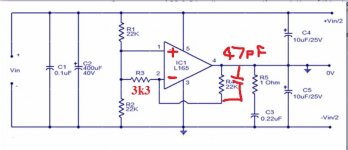

A vast improvement! 🙂 with the changes...now reading +11.84 & -11.91!! Thank you...thank you..it helped a lot! but does this still mean high dc offset?
Unequal supplies have no effect on (for example) opamp circuitry. If you have +16 and -6 or -18 and +5 the DC offset of the circuitry is essentially unchanged.
The fact that the results have improved/altered possibly points to the original circuit oscillating. A scope check would really be needed to confirm that but the modified circuit should prevent any possibility of that happening. The values aren't critical. Also the 1 ohm and 0.22uf isn't strictly necessary or lets say if you want it then I would also add the same to the other rail too. Maybe increase the 1 ohm too.

Thank you indeed for the the link. I've now tested the circuit with various values of R3 which gave the following figures;
Resistor value +V -V
3k3........+11.84 - 11.91
4k7........+12.00 - 12.06
10k........+12.04 - 12.06
Higher the R3, better the symmetry
Higher the R3, increase in output voltages!

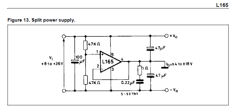

Thanks for your timely advice again! I will try the BUF634 as you've recommended. The only confusion is that on TI data... the splitter resistors are 10k, while "Tangent" design has used 220k! Why the difference & significance? Perhaps lesser current o/p with "Tangent's?

The resistors, well 20K total is 1.5ma at 30 volts, comparable with the IC consumption. No reason not to go higher... its something you would have to try. Go to high and the input bias current will alter (pull down) the voltage at the junction of the two resistors. I'd try 100K or 22K and see how it perform.
