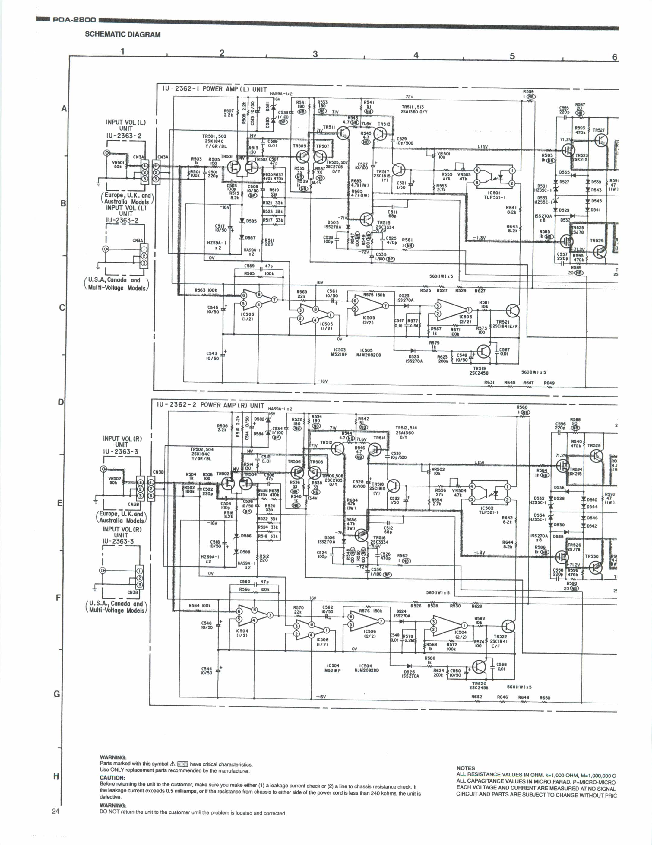

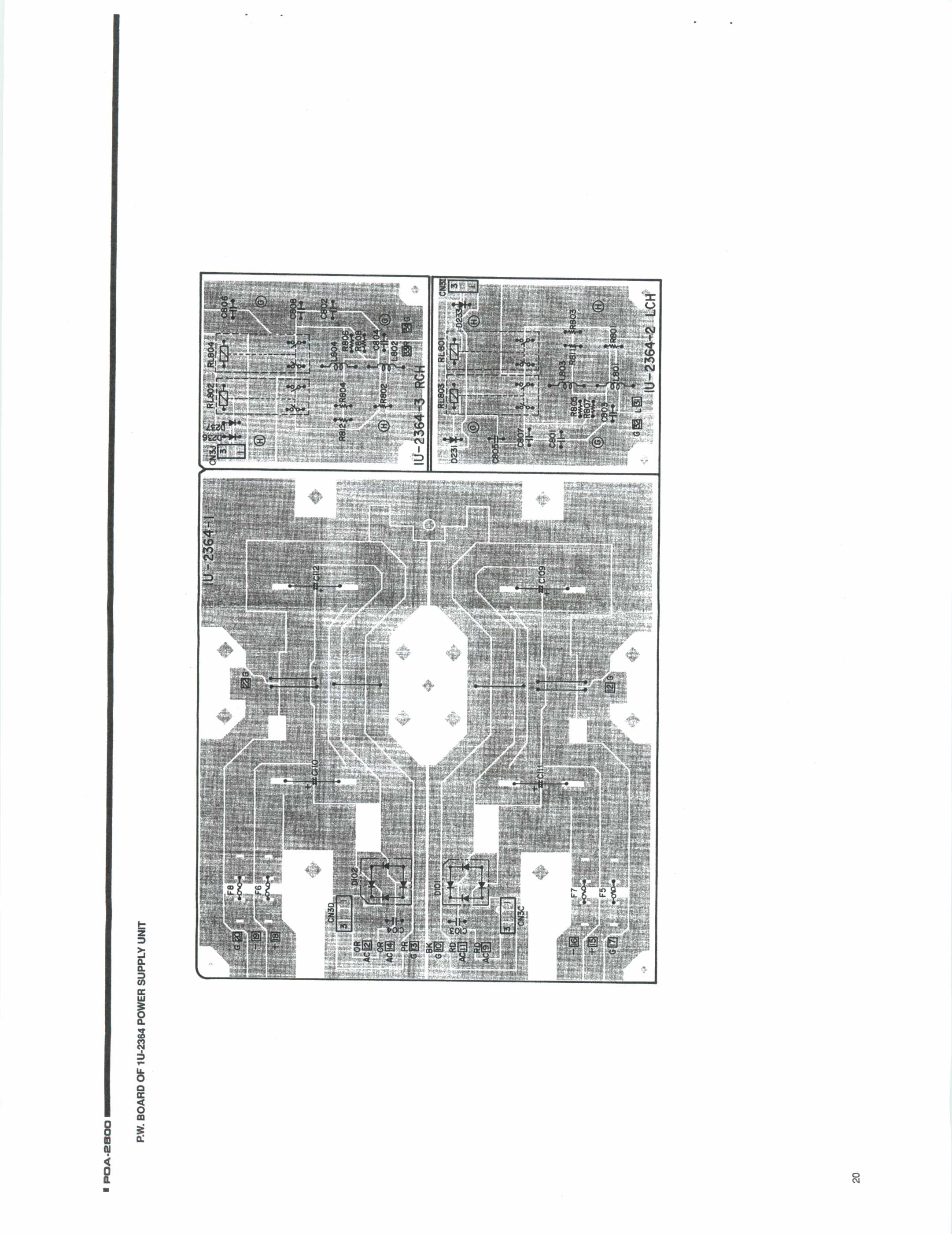

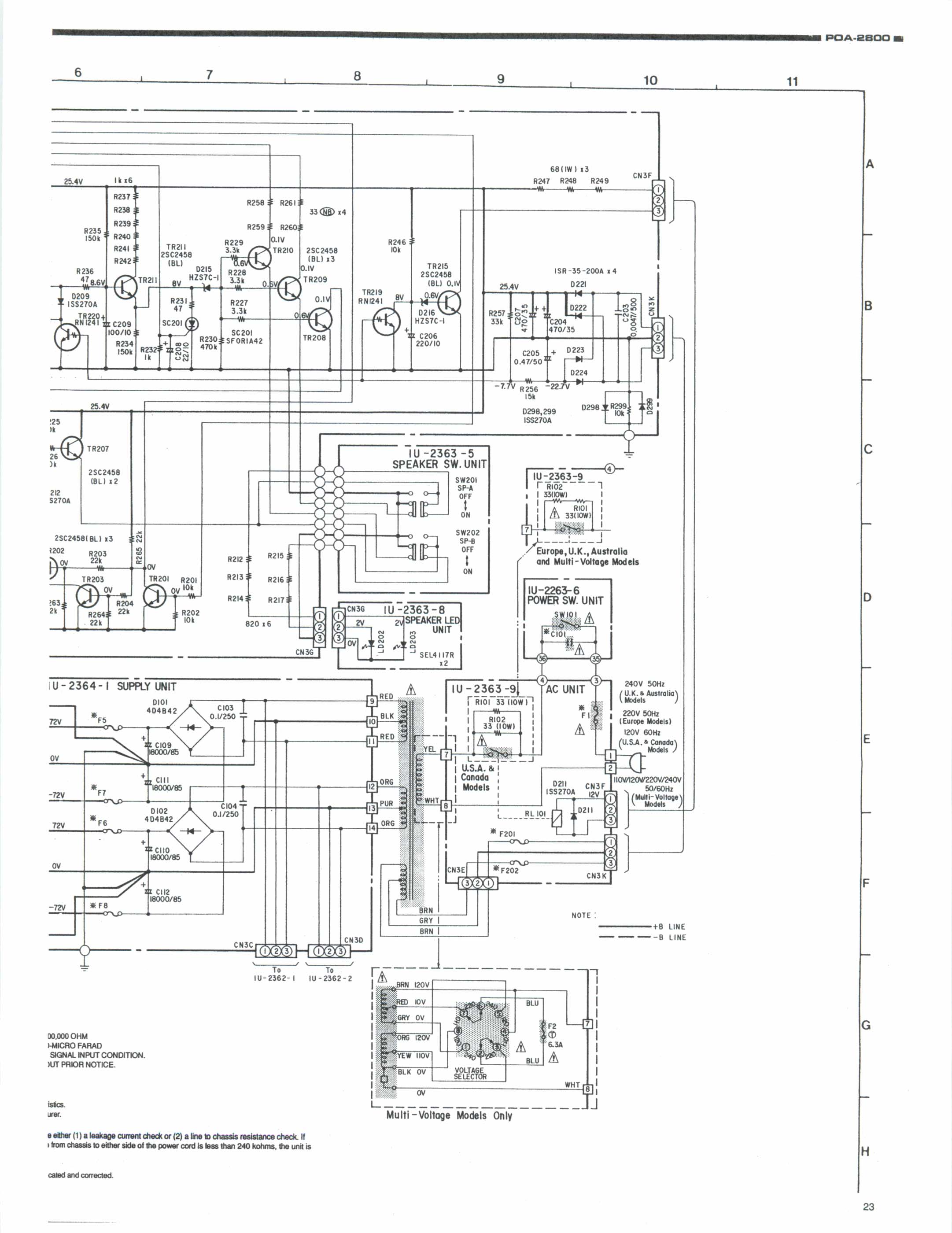

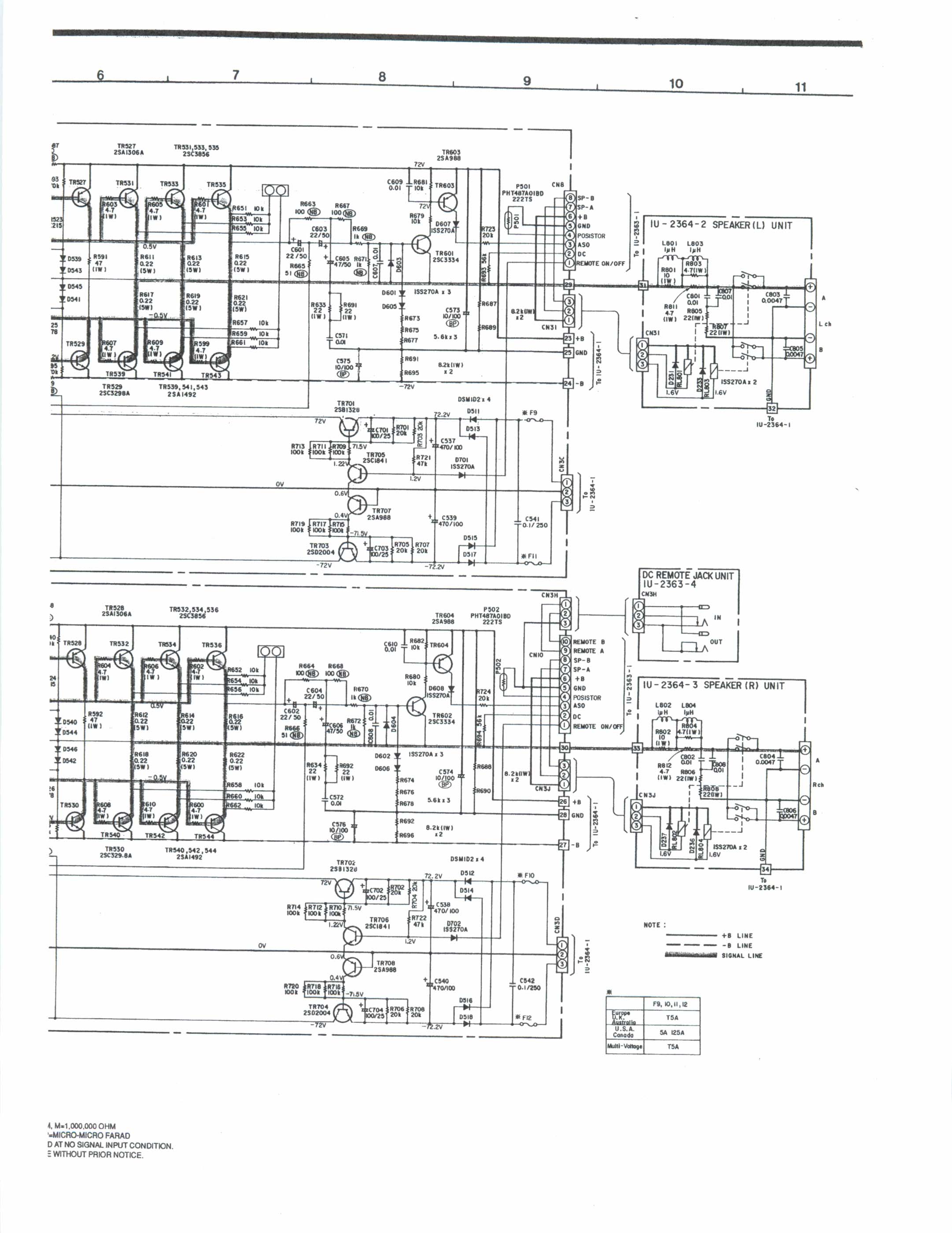

It was too tempting, so I went ahead and swapped the board, but unfortunately, still got the same high DC offset. I attached the schematic in case your interested in having a look at any of it, but I wouldn't know if any of the other misc parts the two channels have in common could cause this result.

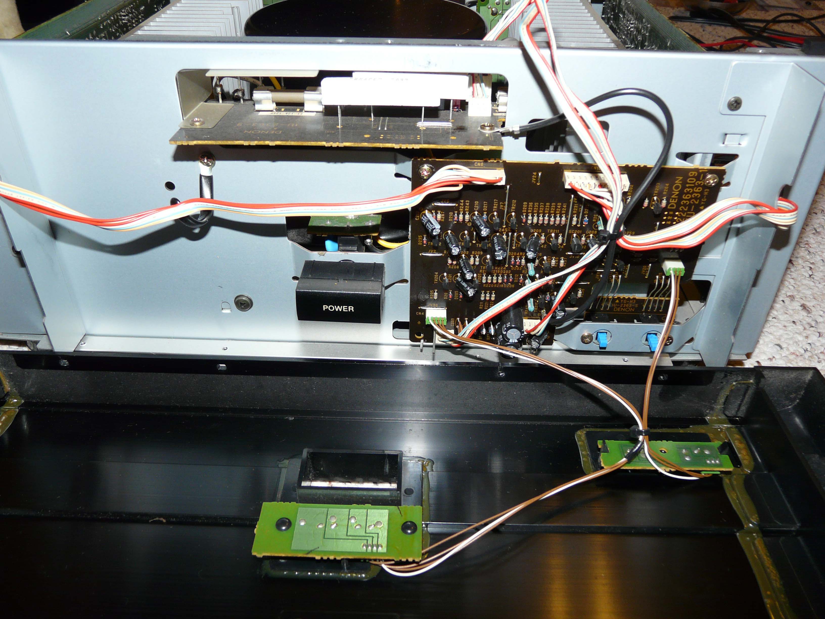

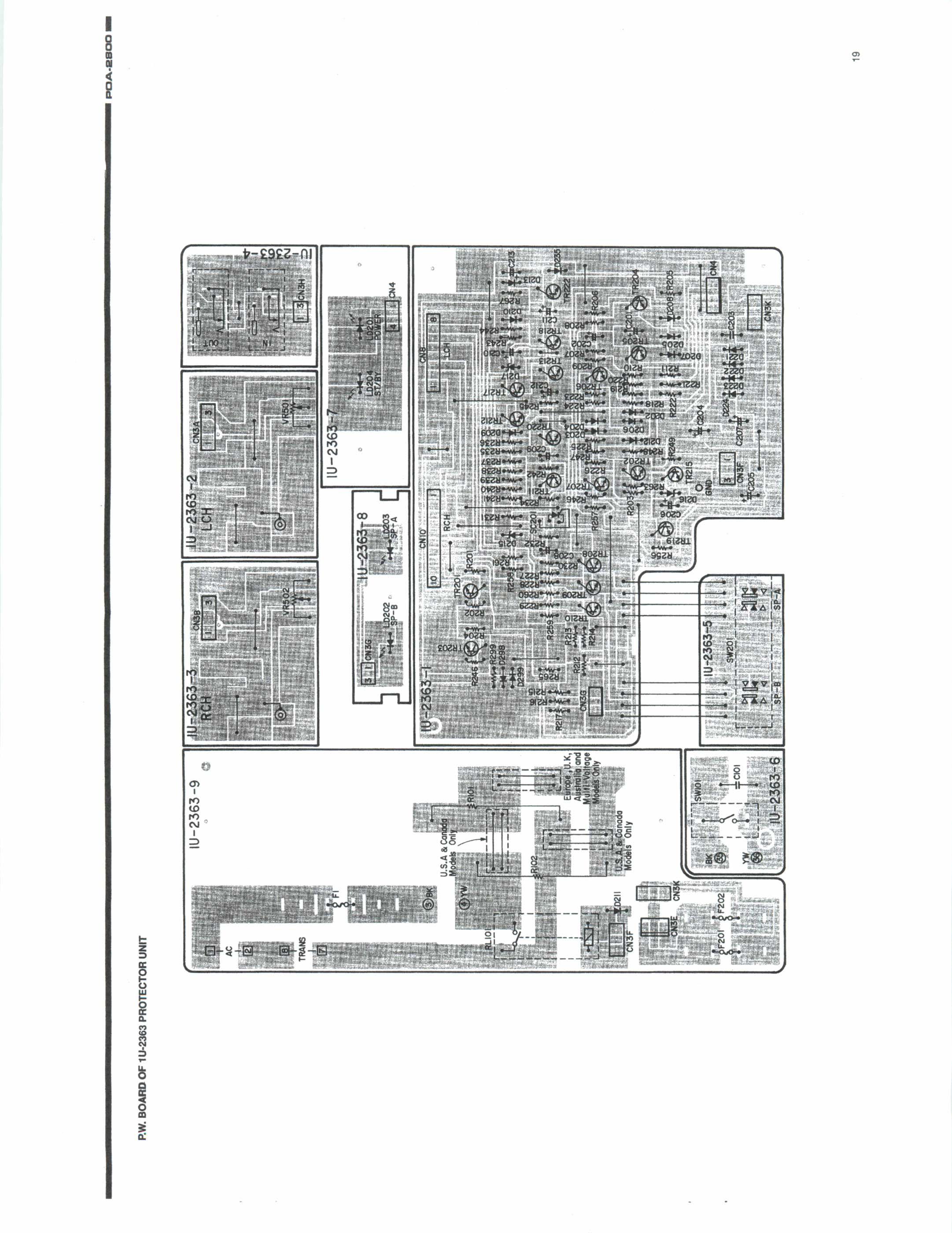

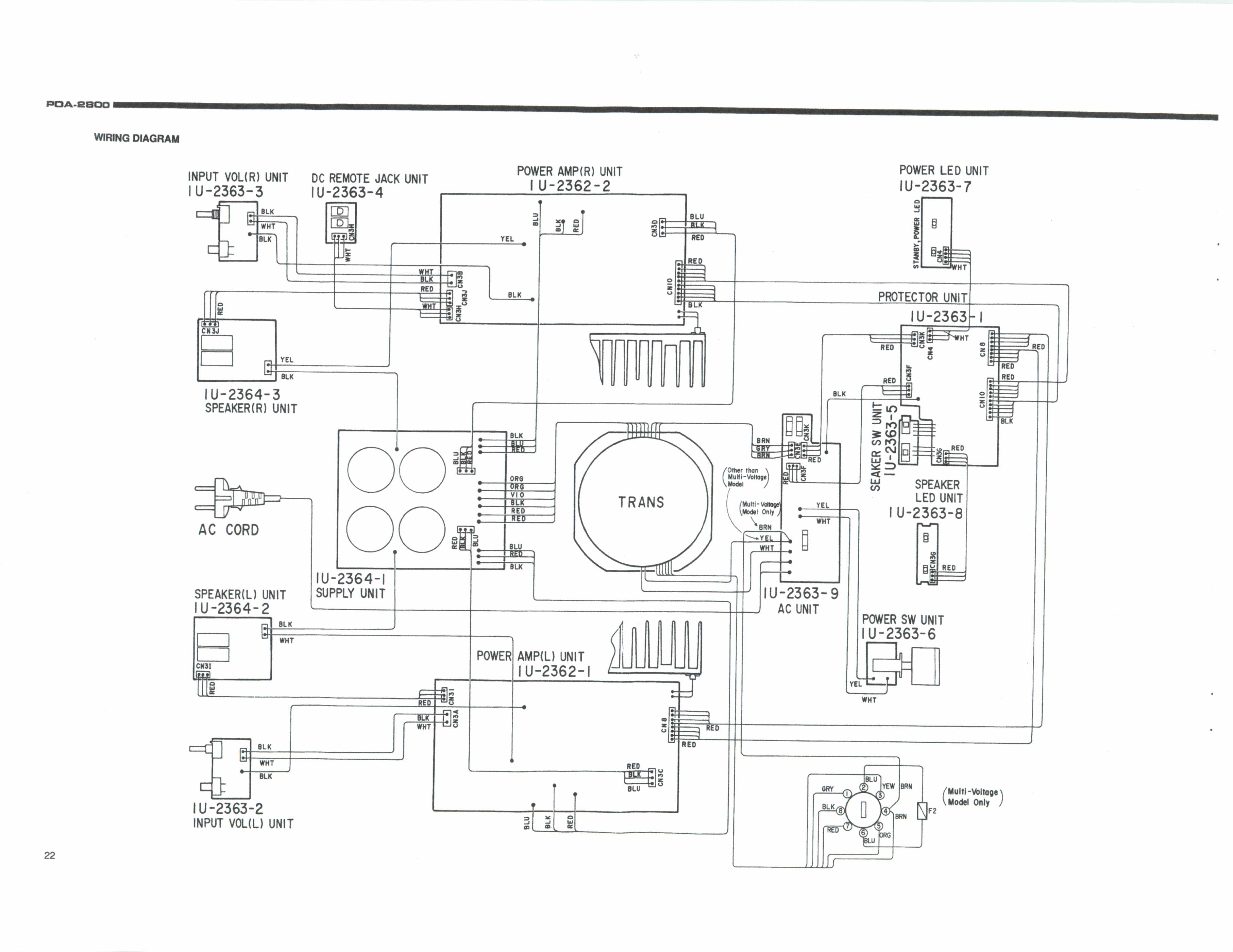

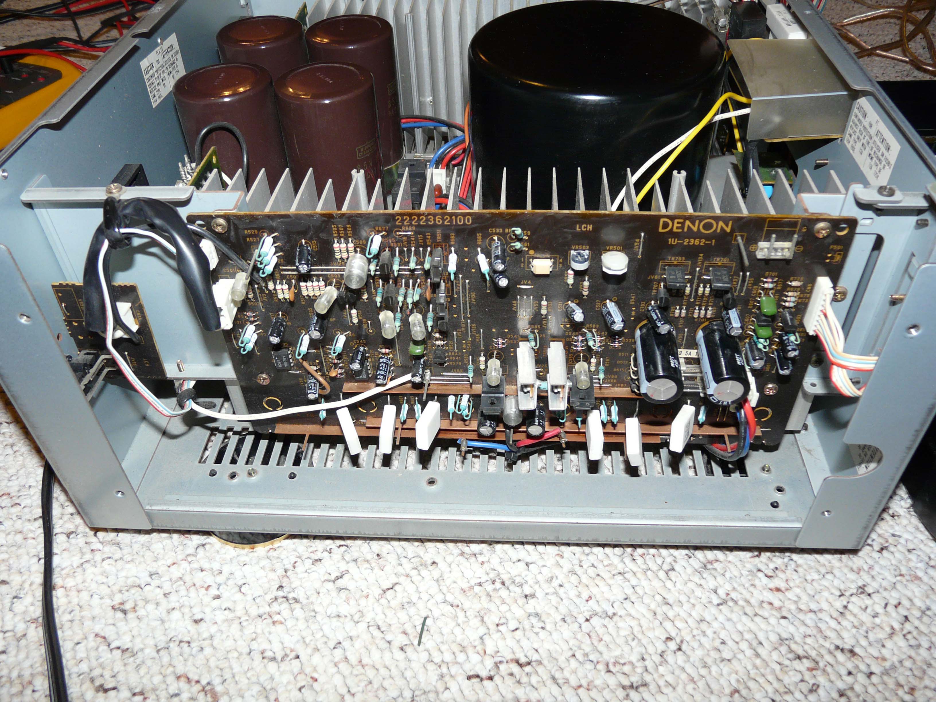

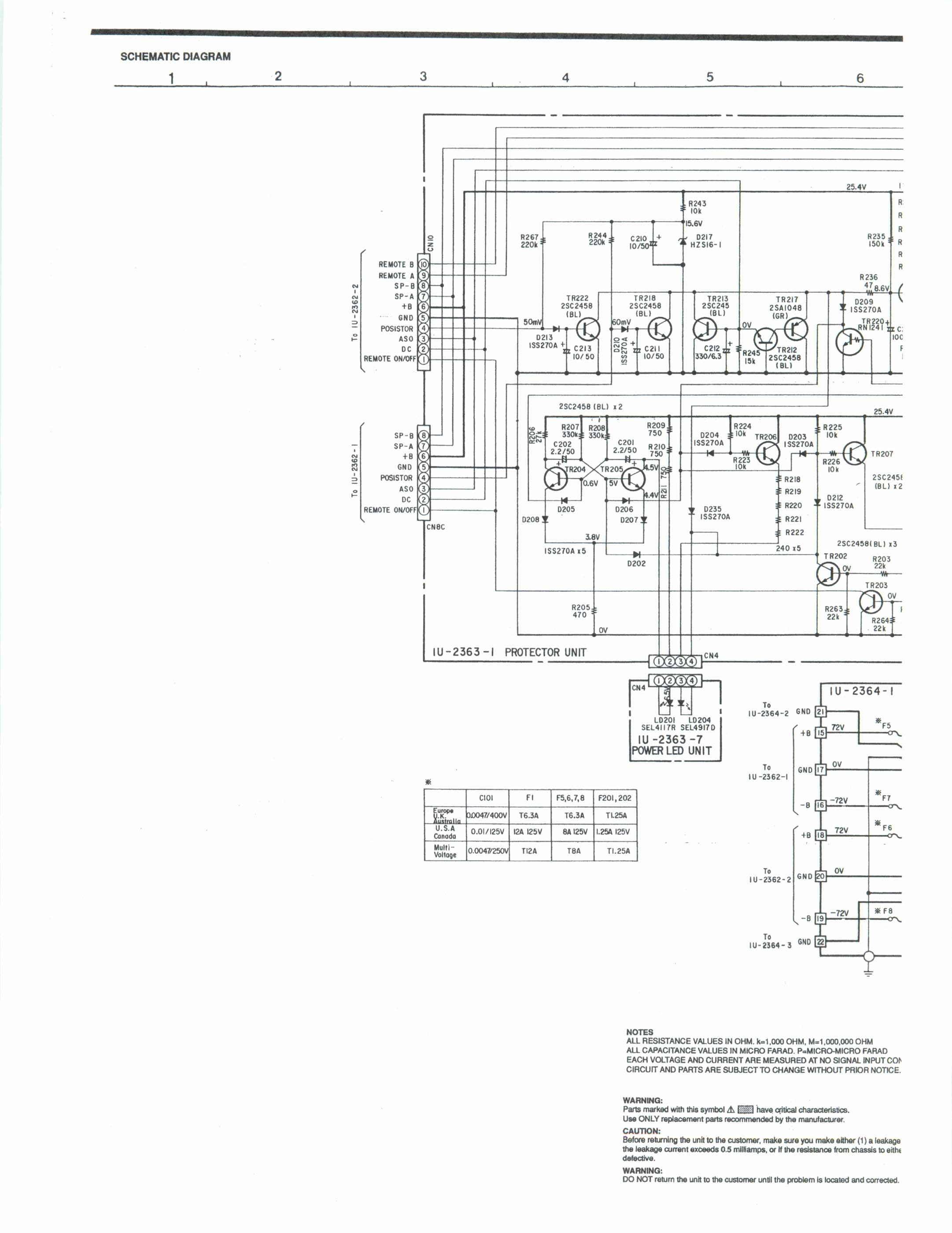

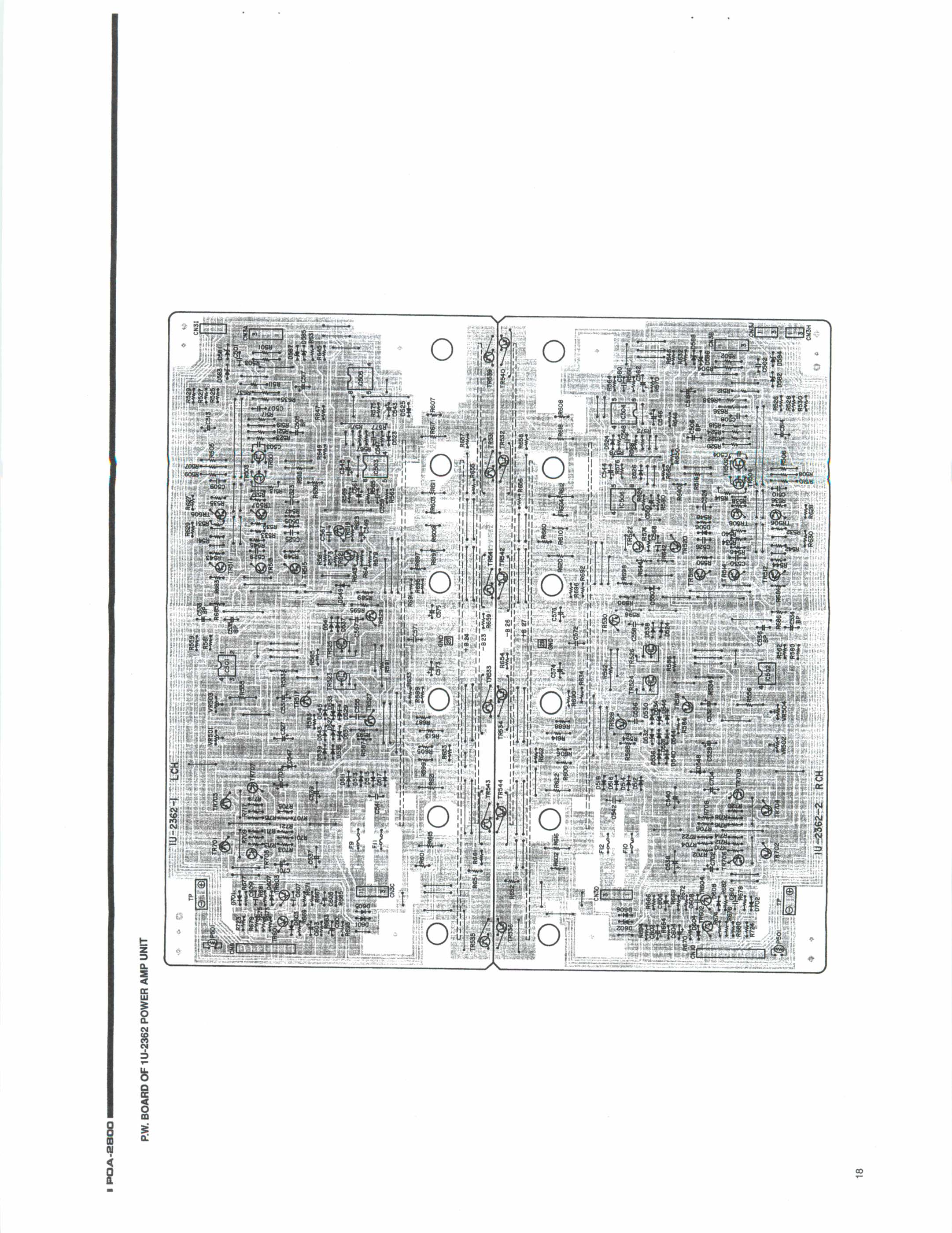

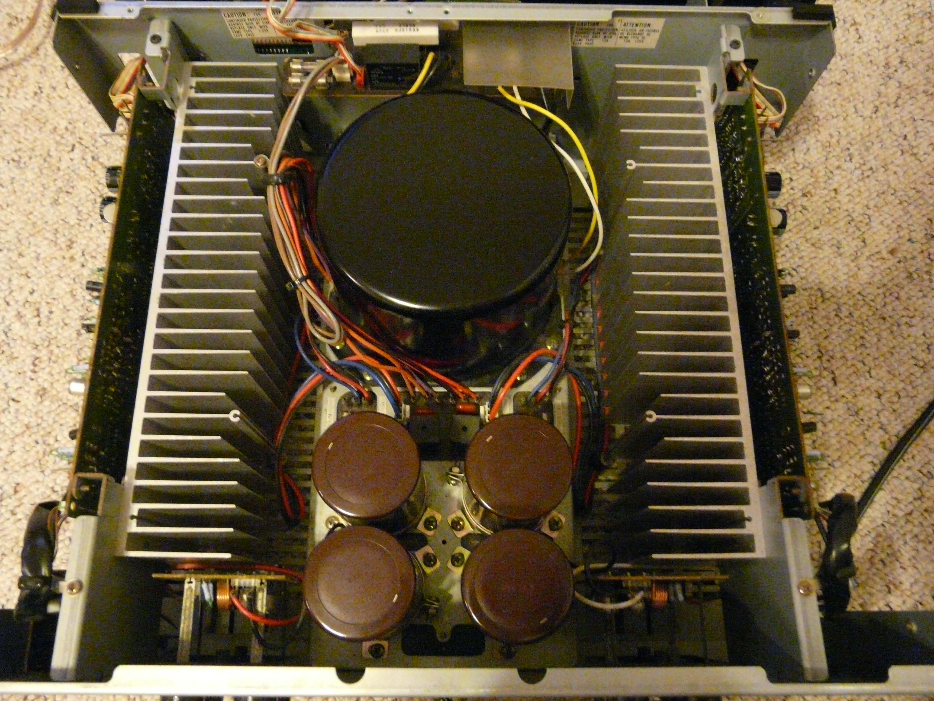

Oh, here are some pics of the amp. The first shows the board I swapped. Sorry about all the pics, just thought I would make it easy for anyone to dig as deep as they might want. Please let me know if anything else looks like a good candidate to easily swap. Thanks.
I woke up this morning and re-checked both channels. The DC offset strangely appears identical on both channels. They both start at about 6.4V then both climb to 6.97 after a minute. I wonder if both channels could possibly have the same issue that is causing identical DC offset? BTW, in the 1st pic (above), I only swapped that larger board.

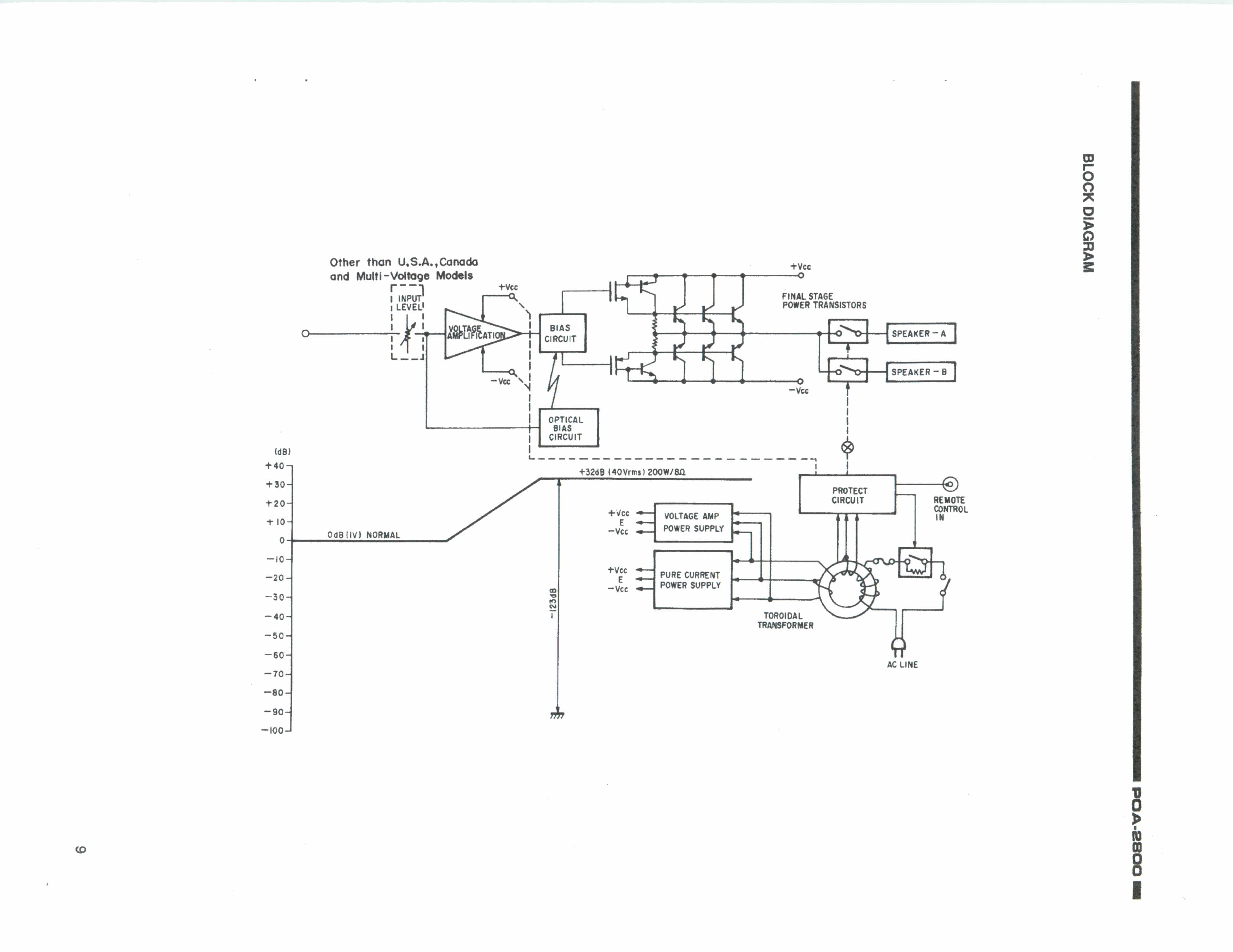

the +/-72V rails might be switched off. these feed the diff amps and such for both channels. they are controlled by the REMOTE ON/OFF signal from TR203. check the DC remote jack. there's a plug with an intrtnal switch contact. if the contact is oxidized, it might turn off the +/-72V rails
unclejed613, you got it !!
I first swapped the tiny board that contains the DC remote jack and oddly it still did not work. Then I tried supplying 12v and then the DC offset dropped to a reasonable level (25mV and 60mV). Not perfect, but in the realm of functional. Even after I removed the 12V signal, the DC offset remained low. As you predicted, the contacts were oxidized. I think the reason it did not immediately work when I swaped the board is because both boards were oxidized, but never gave me an issue with the other POA2800.
Looking back, it turned out to be a minor problem....but knowing where to look...priceless. Thank you for taking the time to explain! These Denon units sound great and it would be a shame to trash one. I can check the bias next but I don't think that is going to get the DC offset any better? Maybe it's good enough?

check all your grounds and ground traces (and any ground screws that tie the caps to the chassis from the board)before assuming it's the caps. a flaky ground going to the amp input can cause a lot of offset problems. a bad cap is more likely to cause hum in the output (if it's dried out or open). or overheating of the bridge rectifier (if it's leaky). the power amp stages are much like op amps, so if you had uneven rail voltages (such as +75 and -60), it still won't cause offset, as long as the input stage maintains it's ground reference.

Thanks again unclejed613, It took a good bit of digging, but it was a ground, as you suspected. This time it's rock solid!! Previously, it looked to be fixed but was not consistent and I excused that since I believed the DC input contact was still not perfectly clean. Now it works without fail.

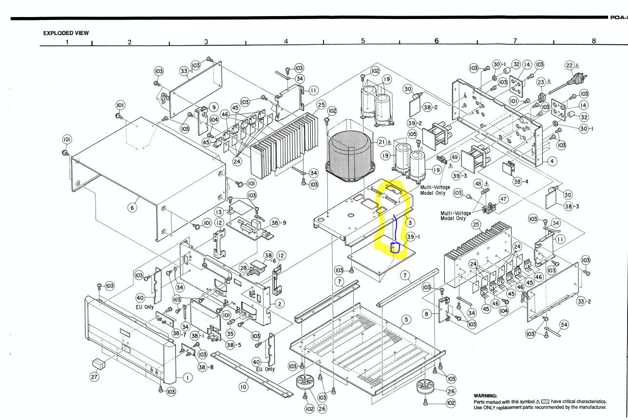

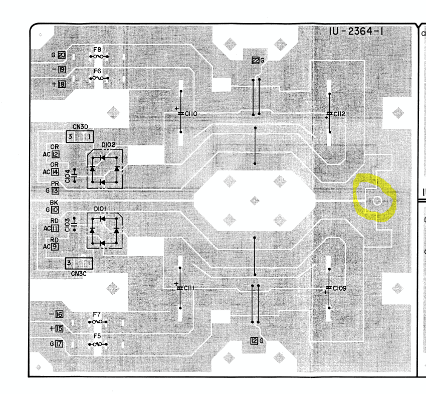

Hi Folks! Thanks Chris and Uncle Jed. Just had the same issue with a POA 2800. between 3 and 7 Volts on the speakers, both channels with the same offset. There is a tiny screw attaching the power supply psb at the rear. It's accessible after removing the bottom plate. It was removed, cleaned and reinstalled FIRMLY. All wonderfull now. Strange that the offset did not trigger the protection cct.

The first POA-2800 I bought back in the day had some 'floating' hum related issues and DC offset which was caused by a poor chassis ground/earth. Hard to believe, but all it took was a removal/clean tightening of this particular screw:
It's the common 'star' ground to the chassis.
