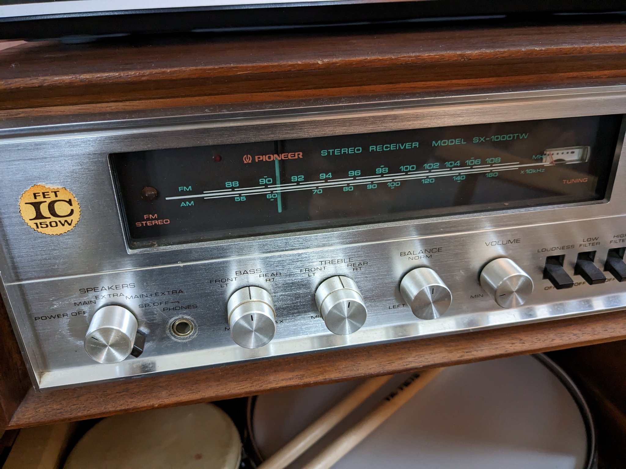

I think I'll start another thread for doing a bit of work on this:
It works and sounds good, but has never been worked on, and is about 50 years old (the original owner told me he bought it in Taiwan on his way home from his tour in Vietnam). There's a lot of hum on the headphone output, which I'd like to see if there's something to be done about.
Yep, a new thread 🙂
Service manual is here:
https://www.hifiengine.com/manual_library/pioneer/sx-1000tw.shtml
It looks really old the way its all written but it should be fixable.
