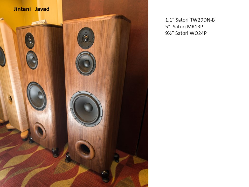

If you are thinking of SB Satori designs, I'd suggest the "Jintanis" - crossover by Jeff Bagby. [/url]
Based upon one picture of the Jintani, the Satori driver set looks like:
1.1" Satori TW29DN-B
5" Satori MR13P
9½” Satori WO24P
You will also find crossovers for the 5" Satori MR13P with the:
--- the SB26STCN dome tweeter which has a smaller motor diameter for shorter C-to-C
--- the SB21SDC with a smaller diameter dome for wider high frequency polar response
