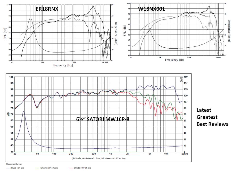

+1 for adding a 10" ported woofer to your Idunn
I suspect your Idunn with a sealed port will sound close to the Jensen ER top box. The box is narrow enough to already push the baffle step compensation Xover circuits into the Idunn Xover, and this will simplify the woofer Xover. Because room size and placement has a large effect on bass Xover tuning, gaining some education in Xover design could offer better sound than building the baseline(generic) Jensen ER woofer circuit.
Adding a 10" ported or TL woofer will allow you to audition the 3-way bass extension at a fraction of the cost of a totally new speaker. If this size 3-way fits your home, you should consider the latest, greatest, SATORI MW16P-8(see curves) as a future update. There are several DIY Xovers for the Satori, and more to come.
PERHAPS, the best question to ask is "what 10" woofer the DIY BrainTrust would recommend for the Idunn?". The Seas CA26RFX used in Troels Jenzen, or ????
Very similar cone surface area:
W18NX001 Effective Piston Area 126 cm2
SATORI MW16P-8 Effective Piston Area 119 cm2
6½” SATORI MW16P-8 ~ $175
