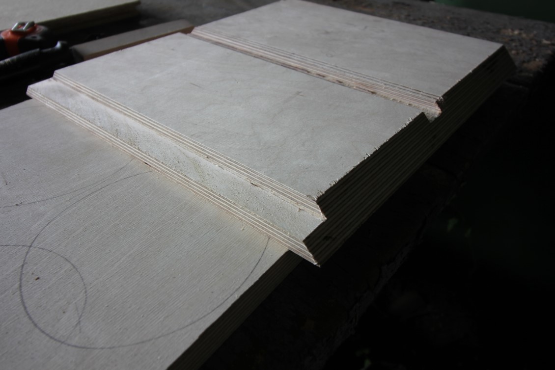

Hello everyone! So I have started to build Troels's SBA-941 (SBA-941). I have cabinets almost done and now I'm ready to order drivers and crossover parts.
Now the hard part is to decide how far up I want to go with crossover and driver options (SBA-941).
What are your opinions on how big improvements there are when moving to better caps etc? This is my first diy build so I have no idea how big differences in sound we are talking here because price goes up quite steep with these upgrades. I have the cash to layout for these if it's significant improvement.
1. SBA 941 - 3-Way Classic - TW29RN-B - Alumen Z - Silver Z + Drivers 1654 €
2. SBA 941 - 3-Way Classic - TW29BN-B - Beryllium - Alumen Z - Silver Z + Drivers 2079 € (+425 € to base version)
3. SBA 941 - 3-Way Classic - TW29BN-B - Beryllium - Ultimate version + Drivers 2659 € (+1005 € to base version)
Second question is what kind of equipment I should be looking to get most out of these. I'm aiming for music first but I'm also going to get surround channels for movies/tv. Currently I'm thinking of getting some AVR with preouts and suitable amp for SBA941.
And question number two leads us to my next build project. Any recommendations for center? For surrounds I'm probably going with some commercial speakers.

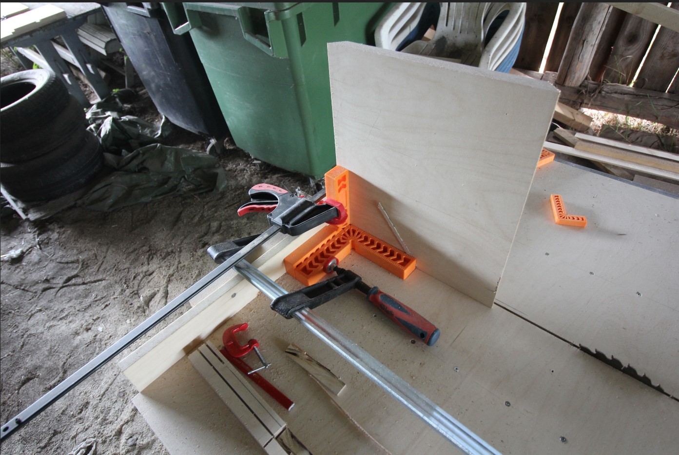

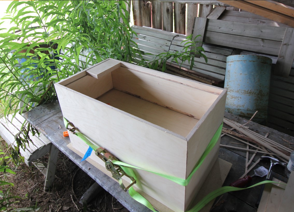

Here's few photos of the project. Project started with building guide for the saw and last photo is first dry fitting before gluing.
I'll add more when I have time to get some photos.

Seems to me the basic kit is more than adequate. If anything, use better damping in the cabinet, the white damping cloth Gravesen applies isn't very effective. And the bracing as suggested in the kit description could be bettered, he certainly cuts too much wood away at places.
As a civil engineer I noticed the same with Troels' cut outs. There are some cut outs that are too big and take much away from bracing. I left more material to center bracing.

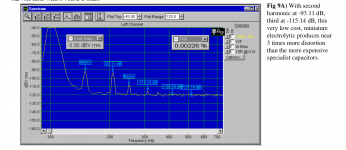

I'd suggest to start with the basic level, and than try if / how you like some of the upgrades later. There are a number of posts in this thread about THD measurements of capacitors and snakeoil gibberish. I have to say that THD is way too low to be audible for basically any capacitor out there, and snake oil is just that. Nevertheless, there are clearly audible differences between different caps. And I have more than once experienced expensive snake oil caps to result on worse sound than a good no-nonsense cap.
