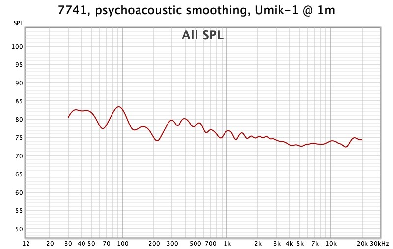

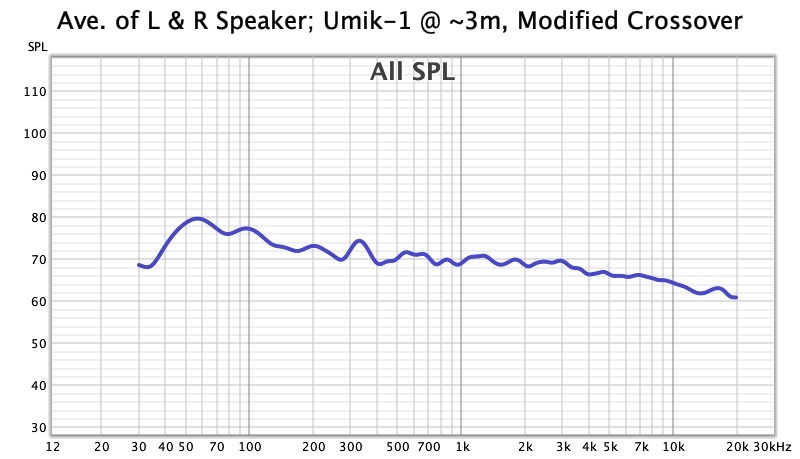

I did not achieve the flat frequency response that Troels designed for this product in my room/ listening environment. Therefore, I can only comment on the modified speaker I ended up with.
When I first powered on the Ekta’s, I thought they sounded good overall but a little edgy on some recordings. I shared my SPL measurements with Troels thinking I might NOT have assembled the crossovers right. He was sure that I assembled them wrong. He made a number of suggestions but there is a limit to what you can do from afar. It is very difficult to match acoustic metrology remotely - different rooms, microphones, measuring procedures, ears, etc. A flat anechoic response doesn’t necessarily stay flat in a furnished room. In the end, I couldn’t explain the difference between “as designed” vs. “as built”. I’m not a huge fan of a ruler flat frequency response anyway. I then chatted with @AllenB about what could be done and he suggested a minor adjustment to the mid-range crossover based on my preferences. I’m more than happy with the results of this change. See SPL graph.

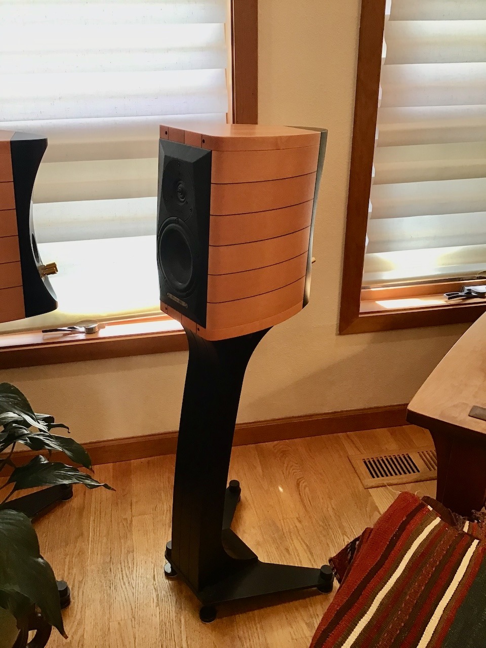

I’ll compare the modified 3-way Ekta 7741’s to my current 2-way speakers, the Sonus Faber Cremona Auditor M’s, doing my best audio reviewer imitation.
The 7741’s are the same height and width as the 6+1 Auditor M’s but instead of a stand, it’s a cabinet with the center filled-in with two 7” mid-woofers. Clearly, you would expect the 7741’s to have more impactful bass and they do. A lot more.
The lowest region of the SPL graphs looks quite similar between the Auditor and the Ekta’s - low 40’s. However, the Ekta’s have much more content in the 60 – 200 Hz region. Two songs that highlight the difference would be the opening bass guitar notes on Macy Gray’s Annabelle and the drum backbeat anchoring Plant & Krauss’ Polly Come Home. The Auditors just can’t reproduce that sound realistically. Some may counter that ANY speaker larger than a 6+1 would show a similar improvement in bass. I wouldn’t disagree.

Are the Ekta’s better than the Auditor’s in every way? No. The Auditors look better. The 2-way on a stand visually takes up less space. As an amateur furniture maker, I’m a fan of Sonus Faber cabinet making and so are the many others who copy Sonus Faber’s lute design. The second difference, which may or may not be a positive, is that the Auditors have a warmer presentation that is more tolerant of recording quality – some might say more musical.

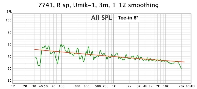

![R sp, 3m, 1_12 smoothing.jpg R sp, 3m, 1_12 smoothing.jpg](https://www.diyaudio.com/community/data/attachments/1229/1229737-9912d3222e99a82e4d0bb884c47ba286.jpg)

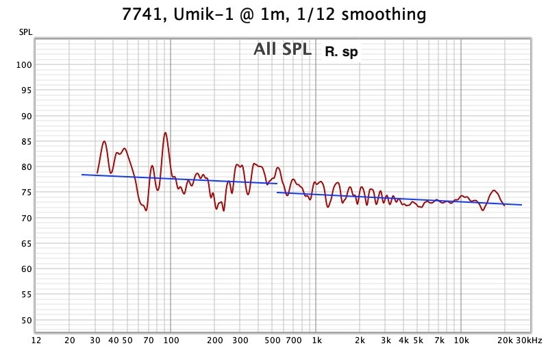

![1m 1_12 smoothing.jpg 1m 1_12 smoothing.jpg](https://www.diyaudio.com/community/data/attachments/1229/1229713-51633fce5c26babb9251117a046323ec.jpg)

Do you have a picture of you Auditor M that you can share?

I realized that I didn't provide the most useful SPL graph for DIYers. People aren't interested in how my listening room measures as much as the response of the speakers from a normalized distance (1m). So here it is - SPL @ 1m. Of course, the room is still causing havoc in the bass region.
