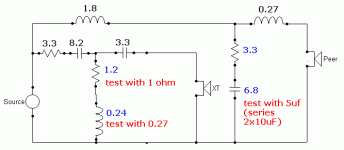

It is quite difficult because to describe things you use a language used by audiophiles, while actually you may mean different things. This is what you need to know:
1) Your 3 other drivers are fullrange, they are indeed sound different than this speaker. Two resistors 3.3 + 4.7 ohm in series with the tweeter really ROB the sensitivity of the tweeter (not my recommendation). This is a speaker for high power solid state amp, not 10 watt amp like yours. Your 10-Watt amp may have not low enough output impedance and the sound will usually became dull, lifeless.
2) You can reduce the series resistance (the 3.3 and 4.7) to get more treble. But that will usually change the design and the sound should become even worse! If you change the resistors in the tweeter network, you usually will have to also change the woofer network.
3) No "setting-in" required from the woofer. It sounds bad because of bad crossover. And your other systems (such as amplifier) might not be able to help, or simply not suitable.
4) Ups. I'm 100% sure that the dull sound come from the notch on the woofer

The original design does have 3.3 and 4.7 in series with the tweeter. This takes away too many sensitivity out of the tweeter.
The original design uses notch filter around 800-900Hz on the woofer. This kills the woofer dynamics (make it sound dull and lifeless).

No I haven't built the speaker. But those 2 points I made are true. Resistor in series with the tweeter will kill the tweeter dynamic. Putting one in front of the filter is a good idea. The other one near the tweeter is dictated by the design (usually to match with the woofer). If the second resistor cannot be avoided, usually it can still be put before the second capacitor. But this is not important 😎
There are two ways to avoid the dynamics-killer notch filter on the woofer.
1) First, you add more filter. So become 3rd order, with first filter (inductor) be big enough to pull down the response around 800-900Hz.
2) IF the effect of resonance/peak cannot be tamed with the first approach, there is a way to make a "smart" notch filter. But I'm not going to discuss this one.
I can make a working 3-way speaker using drivers with NO data at all, only by listening, because I know what happen when I increase or reduce component values.
I can give you a hint how to modify the crossover, but the problem is you have to tweak and listen it by yourself
Here is a modified crossover using components from your old crossover. You can test it for one channel without buying new components, only rearrange the components.
In the above crossover:
1) I have removed 4.7 ohm in series with the tweeter. This will elevate the treble response. This is what you want. The 0.27 inductor has been changed to 0.24. This will reduce the peak/resonance from the tweeter.
2) I have removed the notch filter from the woofer. This will improve the dynamics of the woofer, close to dynamic quality of a fullrange driver. This is also what you want.
3) These mods should not change the overall group delay. Of course you need to tweak it to get precise similar performance. But it is close. If you can rely on your ears, you can find it.

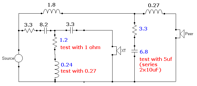

troels design
the tweeter is a 3rd order filter
the woofer is a 2nd order filter with a band or notch filter:
thanks i see that you tried to develop a filter which could be easily build with the parts i have. i guess you are trying to get the resistors out of serie with the speaker., also like you said, you are making it into a 3rd filter for the woofer.
what is actually the crossover frequency ?

when drivers are mounted flat on the baffle with no tweeter offset, its often done that way to get some delay on the tweeter
well, you could try to just leave out the zobel on woofer, and keep the notch filter
not that I like notches either
or just try and adjust the zobel
then you might get away with 12db on tweeter
I never needed more than 12db on the XT25, with tweeter offset
but its very 'sensitive' to changes
especially the resistor value in series with paralel inductor is exstemely important to get right
What matters is the acoustical slope, not electrical. Driver natural roll-off might be first order in nature. So when you cross the driver near its natural roll-off, you need only 2nd order of electrical slope to get 3rd order of acoustical slope.
No you cannot. Midwoofers like this have peak before roll-off at around 4-5kHz. The "zobel" is the second low pass filter. Without this, the peak around 4-5kHz cannot be tamed. Unless you create a new zobel around that frequency. Not the one at 800-900Hz
