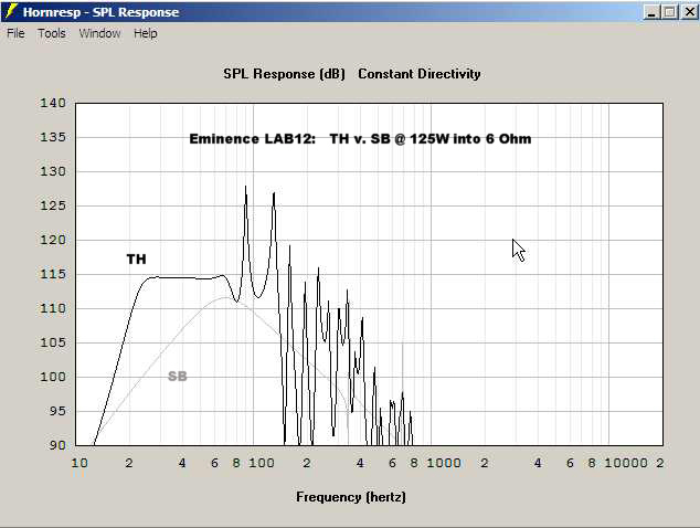

Hi MedPed,
"...the single fold tap horn...will it be a relatively simple project... Do they have a certain characteristic to their sounds that I should consider..."
I would consider it a simple entry-level project. In this simple form it's one more board than a sealed box, what could go wrong :).
The only "must have test equipment" is something like a Radio Shack SPL meter. You'll need that for any subwoofer project during the integration phase anyway, and it would make it easy to find out at what levels you are usually listening, and what levels you never want to get to.
This single fold TH is not designed to go below 20Hz, but will get to 20Hz with some authority. As with any ported (vented) box it will need a high-pass filter to prevent excessive cone movement below the point where the cabinet unloads.
As to what a sub sounds like (OK I can hear the knifes being sharpened in the background): after applying the correct filters to a properly designed sub used within its normal output range there should not be as great a difference to other similarly well designed and applied subs as people seem to make it sound. The big advantage of a tapped horn over the sealed box is the total dynamic range, the lower compression at high output levels, the lower power required to reach a given SPL (take a look at the attached graph), but if you ever use that range/level, that's the question. It sure is nice to have some dynamic reserve though. In general people seem to like the effortlessness of the tapped horn when handling large dynamic changes. There are conflicting reports as to the need for delay (for the main speaker signal) something to try. Take a look at Erik's (Volvotreter) web site for more information: Tapped Horns .
I'll attach a quick graph comparing the LAB12 driver in the single fold tapped horn (TH) and a V_net=75L sealed box (SB). Both driven w/ 125W into 6_Ohm, which brings the peak excursion to ~~Xmax (which is the safe limit that should not be exceeded; Xmech or Xlim is the mechanical limit the exceeding of which will likely lead to driver damage).
"...subwoofers - one beneath each of my bookshelf that I use as my mains..."
As your mains seem to be somewhat limited in their low end this approach would probably work. See: filters, phasing, level matching, multiple amplifier...all kinds of ways to get from here to there, all easier with sealed boxes. OK, now we have two sealed boxes for the range extension of your mains, and a TH to add some oomph (technical term). 2 ea. JBL GTO1214 SB (budget) and 1 ea. LAB12 TH.
"...this being my first sub, it will likely have enough shortcomings..."
Not necessarily.
Best of luck,
