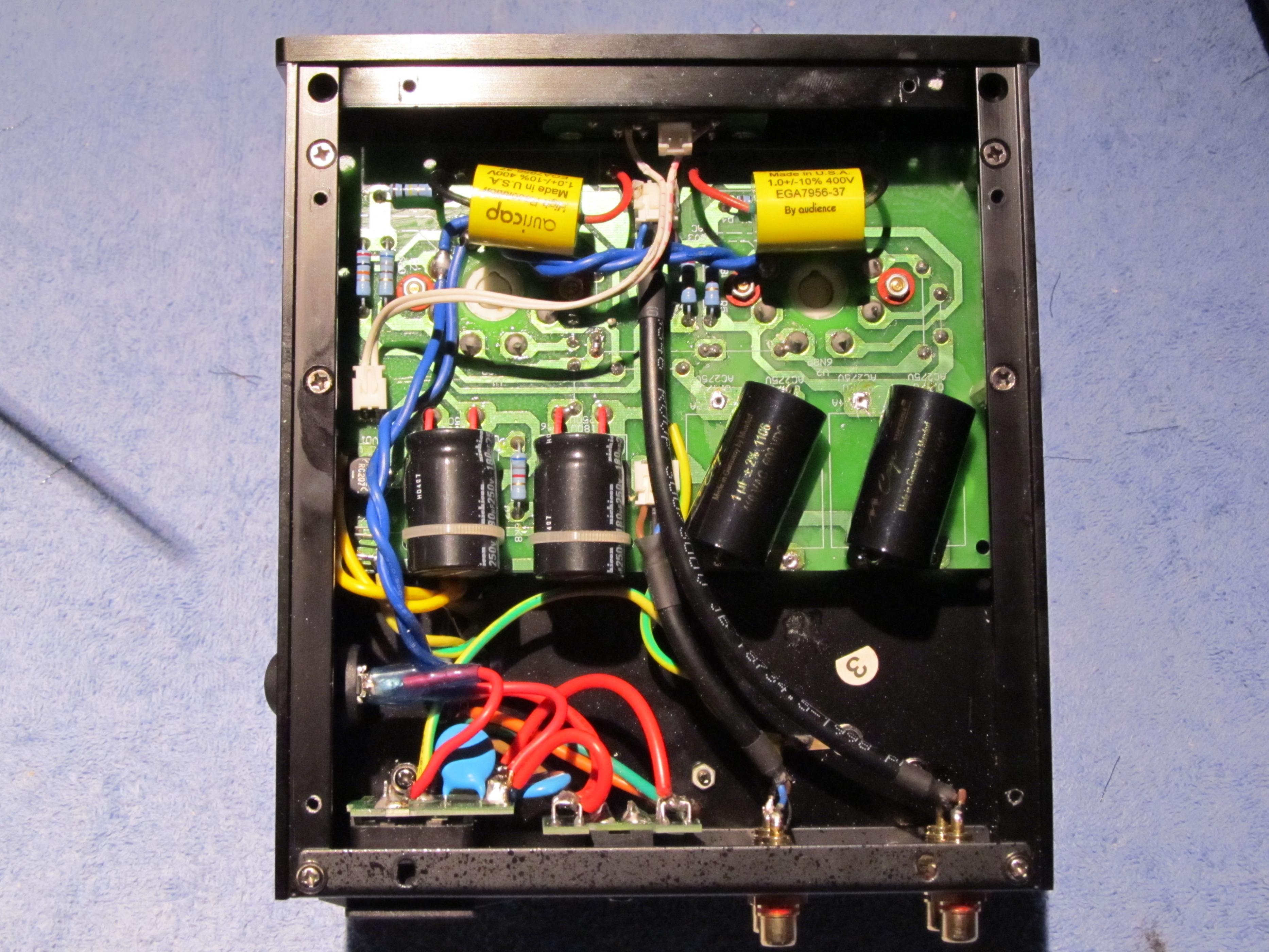

However, if you would like to test the sonics of a particular cap - buy a Yaqin CD3 tube buffer.
The CD3 is some version of a cathode follower, with a pair of 6sn7 tubes.
There are coupling caps on the input and output - that are very easy to change.
The caps in it are rated at 275v and I used 1uF.
As a coupling cap, I've found the Mundorf M-Cap Supremes make the sonics sound thick and forward.
M-Cap Supremes seem to be very good at filtering harshness from a digital source.
I've also tried Auricaps - which I'd say have a very natural sound,
but the music sounds further back than the Mundorf's.
IMO, AuriCap's and an M Caps Supremes seem to complement each other well.
Also, I'd say as a cap breaks in, its sonics seem to get more transparent.
One thing of note, film caps are non polarized.
However, the outside of the foil should be connected to the low Z side of the circuit,
so that the outside acts like a shield.
Here is the bottom view of the Yaqin CD3 tube buffer.
Original AuriCaps coupling the input - Mundorf M-Cap Supreme's on the output.
Not sure if I put them in with the correct orientation,
But they made a huge improvement to the original MKP's.
The unit is now very good at removing digital glare.
There are coupling caps on the input and output - that are very easy to change. The caps in it are rated at 275v and I used 1uF.
As a coupling cap, I've found the Mundorf M-Cap Supremes make the sonics sound thick and forward. M-Cap Supremes seem to be very good at filtering harshness from a digital source. IMO, AuriCap's and an M Caps Supremes seem to complement each other well.

Your suggestion for using a tube buffer I think introduces the possiblity of a number of colorizations. There is the input capacitor; the tube; and the output cap. Each yields its on signature on the sound within the tube buffer. I would agree that the balance you achieved with the caps you recommend, may will yield the results you desire for the "tube buffer," but to evaluate caps for T-Amps in general, I believe, such a tact introduces to many variables to determine the sonics of any one capacitor.
In my system I use a tube pre-amp to feed my T-Amps. The pre-amp, ICs, and speaker cables have all been selected by me to "color" the sound to my liking. Yes, I color the sound for my own day to day listening to soften that digital sound. The T-amps I currently use have the generic caps that came with the units. I used the source directly to the T-Amps, as well as, a tube buffer, but I like the balance of the sound (color) that comes from my tube pre-amp.
Overall, it seems that most users of T-Amps seemed to like tube buffers. The input coupling caps are a step short of tube driven front ends. I found that oil filled caps like the Obbligatos provided that tube sound in an input cap without the tube component.
However, If one did choose to use the tube buffer for T-Amp input cap evaluation, you could just bypass the T-Amp input caps. So, once you settled on the buffer input cap and tube, you could then swap output caps. With the bypassed/eliminated T-Amp input cap you could then home in on the sound of the cap you preferred.
