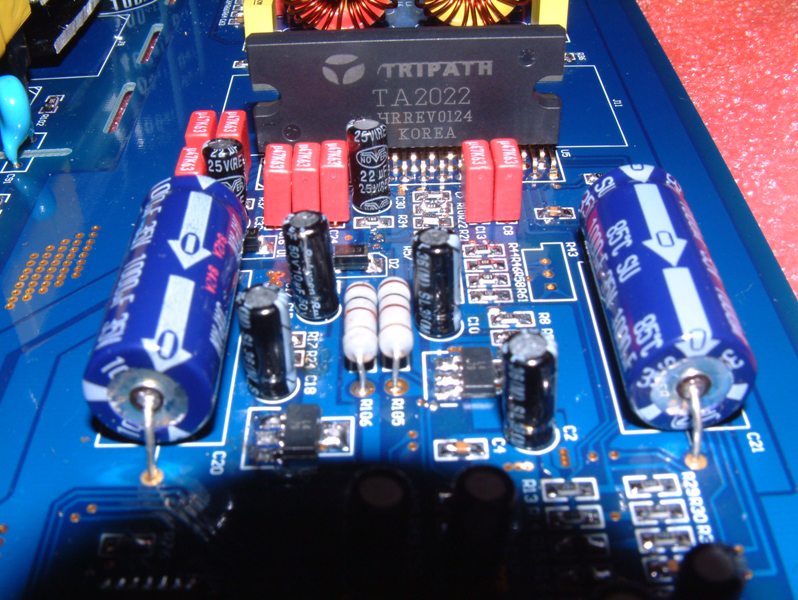

when hiss out like angry cat there are must lots of problems with PCB route.especial in SMPS+CLASS T topic,the background noise should very low,It will larger when parts position or PCB route no right.
Many people (include chinese)feel easy to build a class D or T switch amplifier,but I think "Innocence Abroad “,professional development
engineer never say easy ,try and try ,more and more time revise,sound will better,the demo board out of "hi-fi",only toy.
Our new TA2022+SMPS board debuging!this is first version,there also have low hiss noise now,we have jumped some parts,lower noise still can be heard by high sensitive tweeter.
We have to revise the second version for better parameters.

Why are there 4 output inductors?
I don't think you will ever completely get rid of that little bit of hiss; it's just the nature of these Tripath IC's.
TA2022 Angry cat run away!
I found VN10 is so important for this amp,noise always come from here.EB-TA2022 may not attention to this question,this question isn't linear or switch supply,key point is voltage,PCB route also important,I 'm not draw along with TRIPATH EB-TA2022,We haven't ebay shop,if guys have other question pls send mail to me,my mail:authlxl@gmail.com

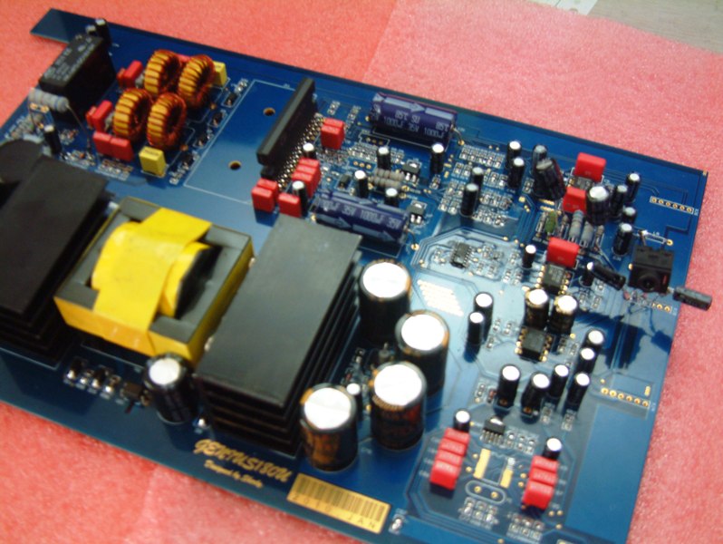

I have finished the first version, found some question and revised it .the second version will debug next weekend,We believe it will work well at that time.
Fixed specification (tested):
POWER OUT:2×100W/4Ω/1%THD+N,2×85W/4Ω/0.1%THD+N
SENSITIVITY:0dB
INPUT IMPEDANCE:10KΩ
POWER SUPPLY:90-265vac 50 OR 60Hz (T4A FUSE INSIDE)
FREQUENCY RESPONSE:20-20KHz ±1dB

I wired it up this board from the OP today and Hooked it up to my iPod intitially just to make sure it worked.
Later I hooked it up to my Decware CSP2. I'm only using a cheap RCA to DIN patch cord right now but this combination makes these little ADS speakers sound quite nice!
I was concerned about background hum but the noise floor is not bad at all. After I get a box for it, and a better RCA jack connection with proper chords, I'll provide a more detailed review but right now this little guy is driving these 4 ohm speakers with authority.
FLAC>MediaMonkey>ASUS STX>Decware CSP2>Tripath TA2022(with 2x24 300W, and 2x6 2.2amp transformers)>ADS L300i

Here is the board built as a power amp (no volume).
This thing is dead quiet.
I must say it sounds quite sweet driven by a Decware CSP2 into a couple of ADS 300e speakers.
