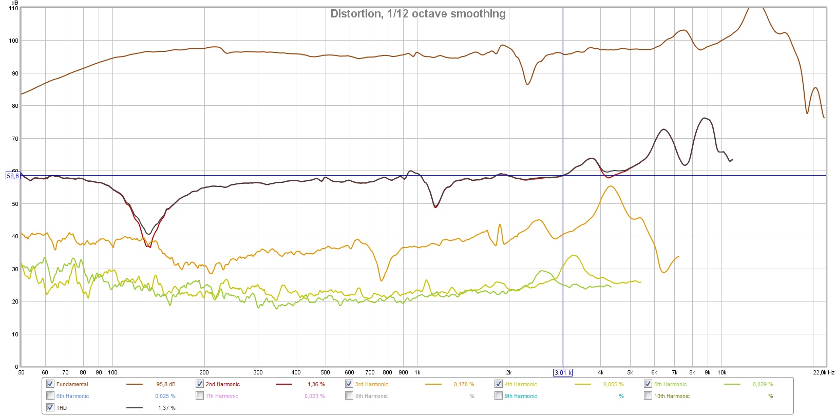

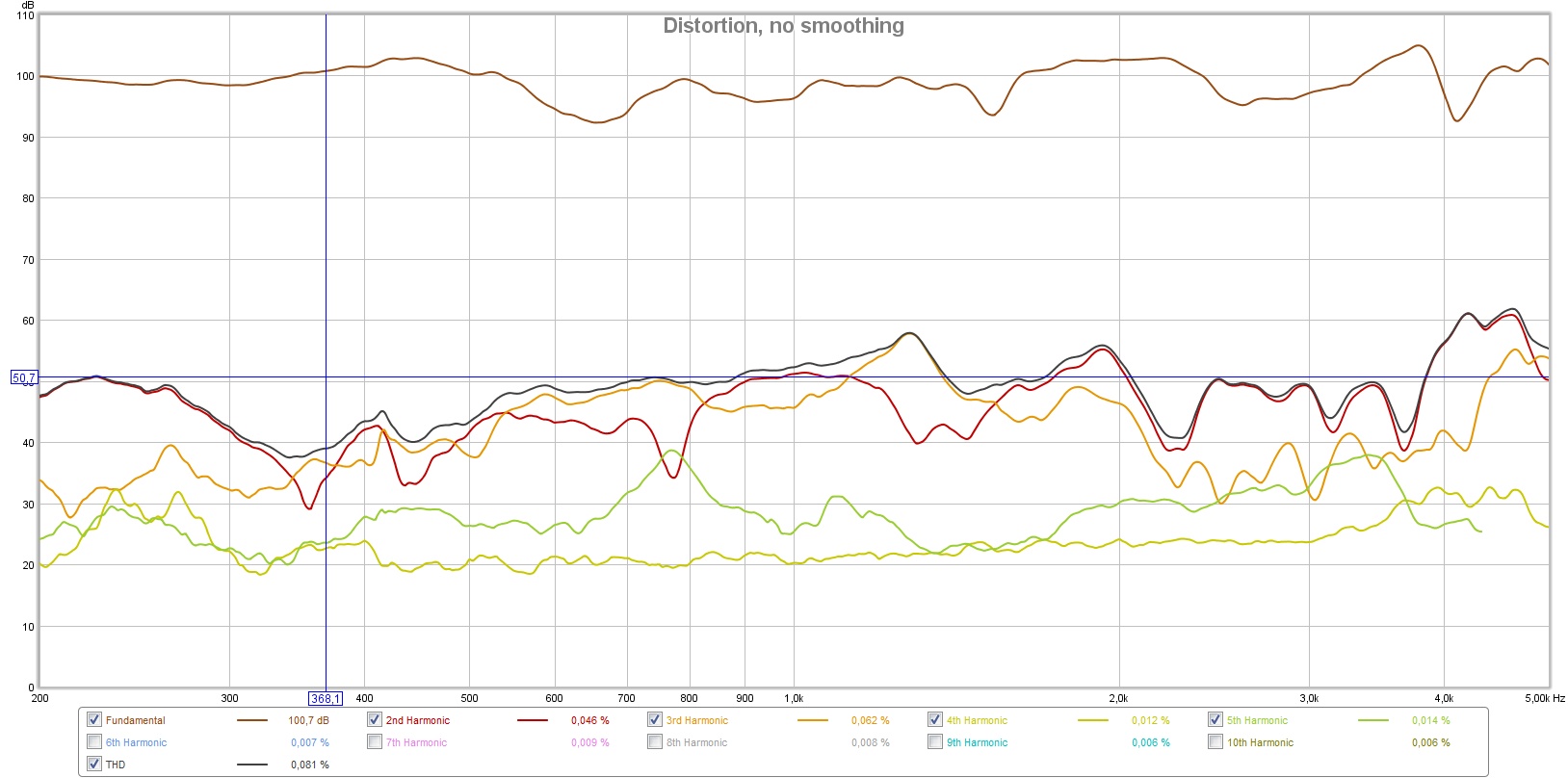

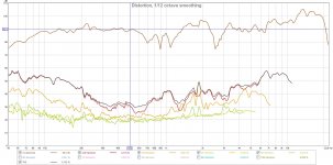

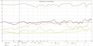

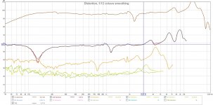

Last year, I casually measured speaker distortion after adding digitally generated positive H2 (Blue), negative H2 (Red), No H2 (Green). 2 way speaker crossed around 850Hz, tweeter is connected in negative polarity. I don't remember why it is showing only 100Hz-5.85Khz.

Just based on that distortion graph I would go with the blue line. More distortion at lower frequencies where positive going second harmonic will add some "forward projection" and a more vivid character, and less distortion in the very sensitive mid and upper midrange where distortion usually just sound "distorted", muddied and with less resolution or a sharp unnatural "definition" depending on the bell modes and break up of the loudspeaker cone.
100% agreed. Now I only add positive H2 (Blue) for woofers, no H2 for tweeter. 🙂

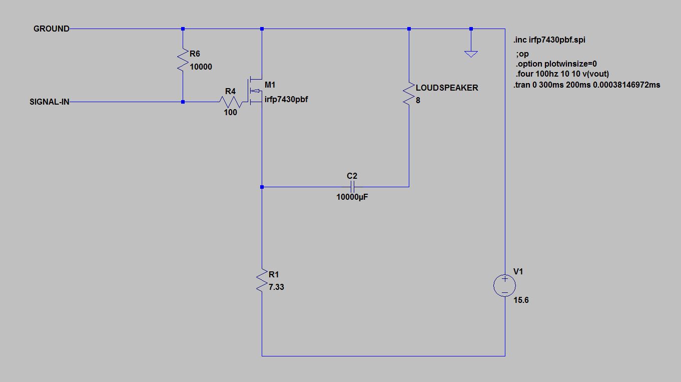

Some thinking and a large transformer core based choke led to this schematic.
15 kg transformer core choke.
7 parts makes for a fast and easy point to point build.
A simple prototype is enough to get a sense of the potential performance and some measurements.

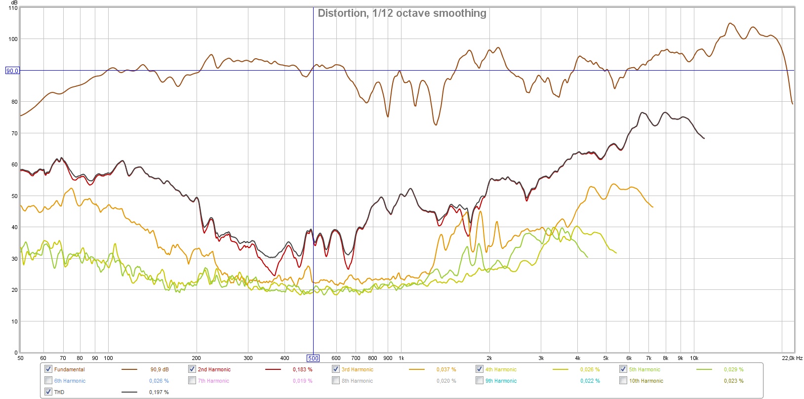

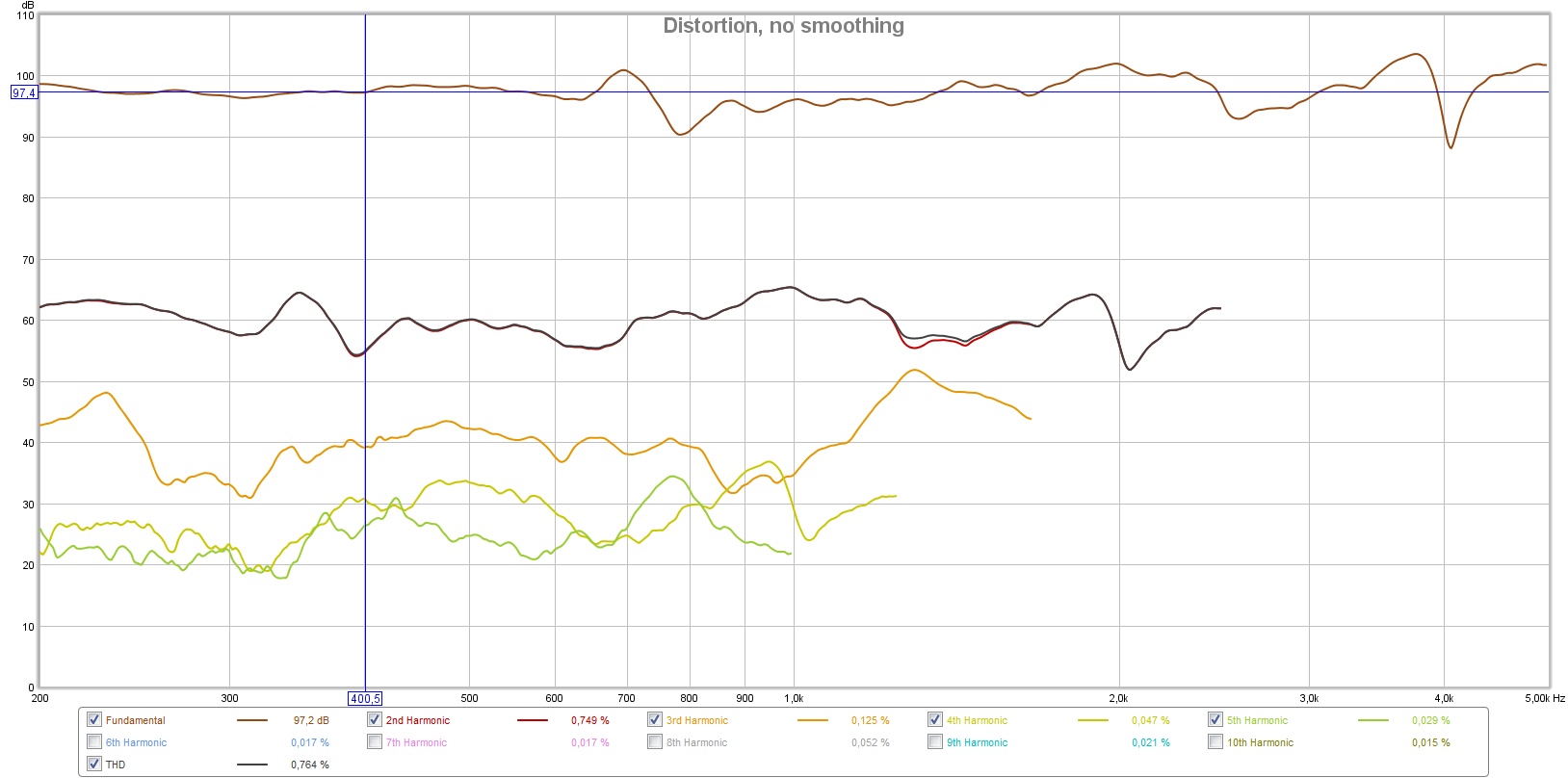

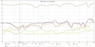

Here is the measured response and THD through a Dayton Audio PS95-8 in a closed box.
I don´t have many enough of IRFP7430 to get a closely matched pairs at the moment, so I have to accept 30 mV DC offset over the choke.

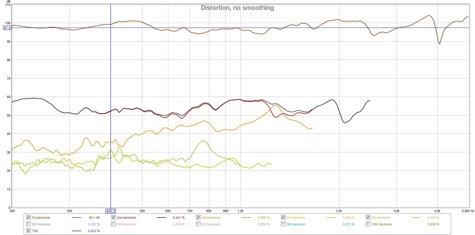

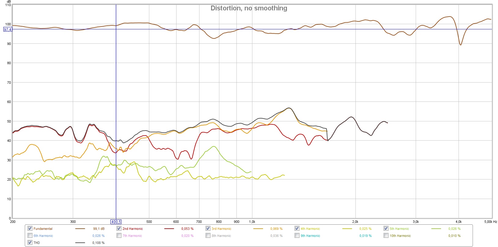

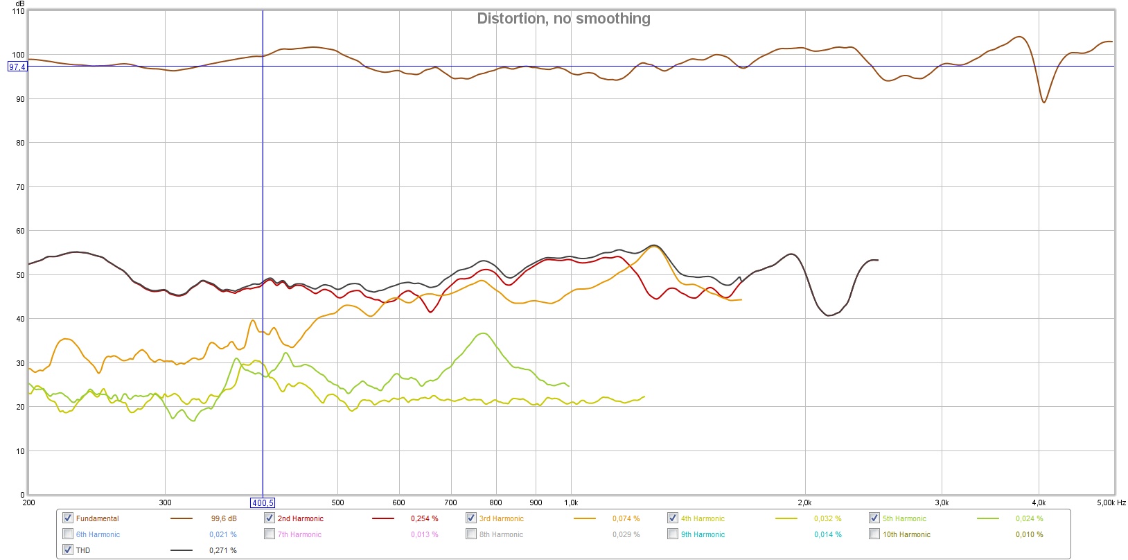

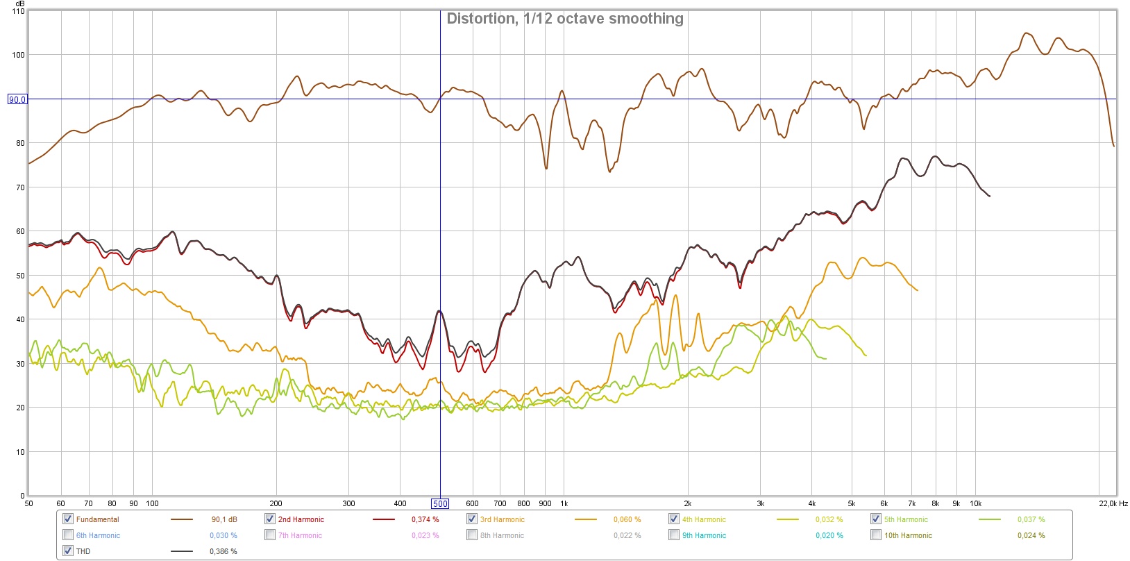

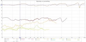

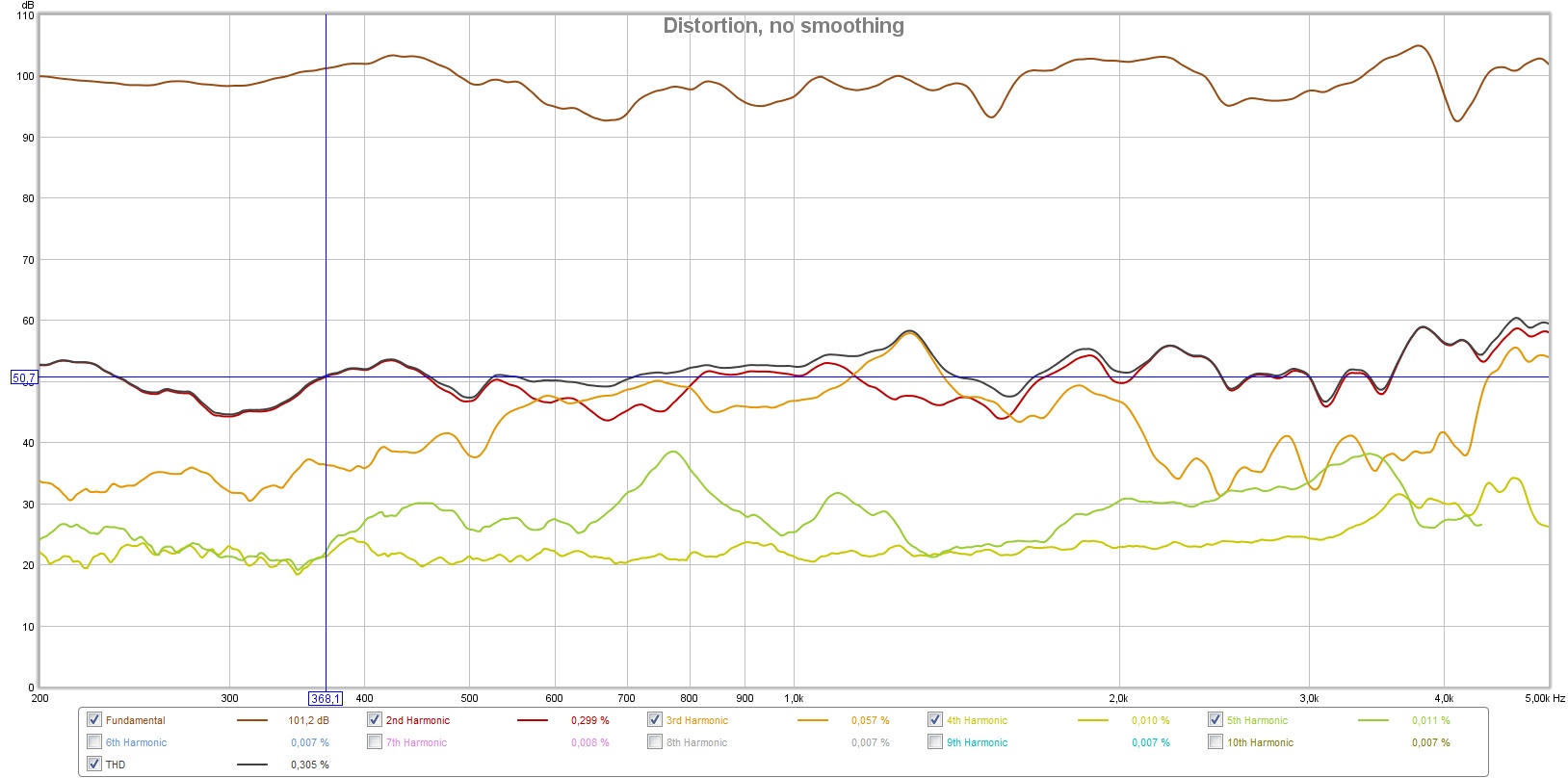

Here is a distortion measurement of the amp driving a cheap car audio 10 inch driver in a HROAR bandpass box. 0,623% THD at 40 Hz 101,7 dB at one meter.
I think it is a quite impressive performance considering that you seldom use simple single stage class A amps to drive car audio drivers and subwoofers.
It is not often you go shopping for a 5 volt powersupply when building amps, but it is enough for 2 watts into 8 ohms.

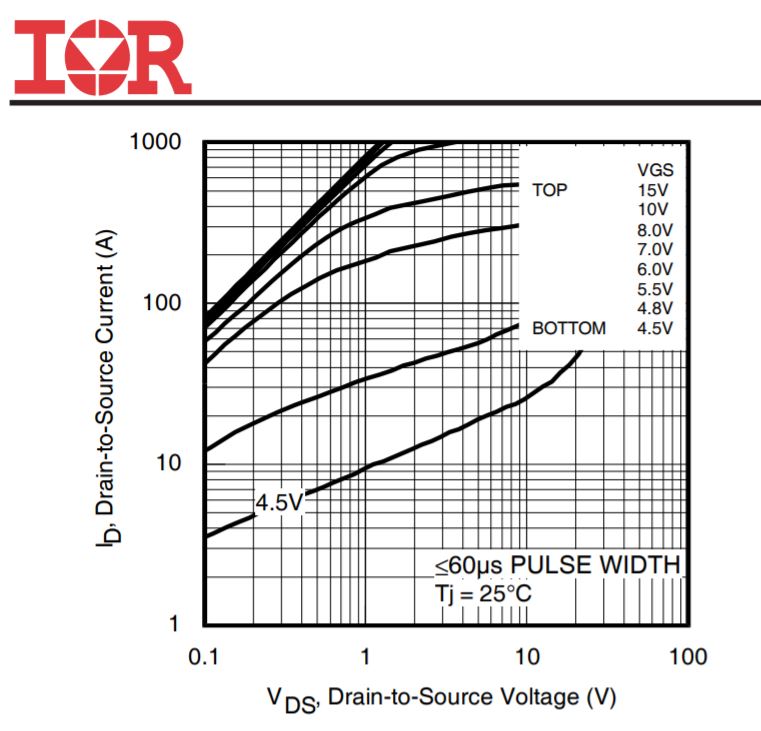

With a high transconductance device like the IRFP7430 or IRFPS3810 you get a quite different character compared to an IRFP240 or IRFP9140 (P-channel).
I have tested several different Mosfets in this or reasonably similar layouts recently, and the IRFP7430 gives a very powerful and punchy character full of organic "life" and a very vivid and "forward" presentation. This is the way I prefer to voice my amp, but I don´t think it suits everybody.
Choosing the right device for you takes some hands on experimenting and testing. Any TO-247 device with a Vgs between 3 volts and 6 volts for 1 - 3 ampere through it will be technically suitable for this kind of amp. One must adjust the voltage over the amp to get the intended quiescent current.
It needs a adjustable regulated power supply. A Mean Well LRS-75-5 switched power supply seems quite suitable and cheap.

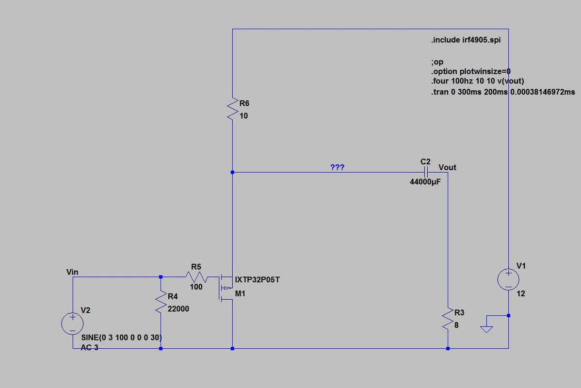

Here is a simulation of the amp with a pair of IRFP240 Mosfets. Low transconductance and non-triody.
Quite nice simulated performance with almost 15 volt output from a 5,3 volt power supply.
