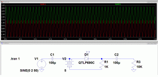

Just for fun: how do you call V(n003), the green trace ? It's taken at the right of the led, atop of R1.
V1 is a pure AC source of 2Vp-p, V2 is a 5V battery.
You have the exact same sine atop of V1 and R3 btw... (red trace)
