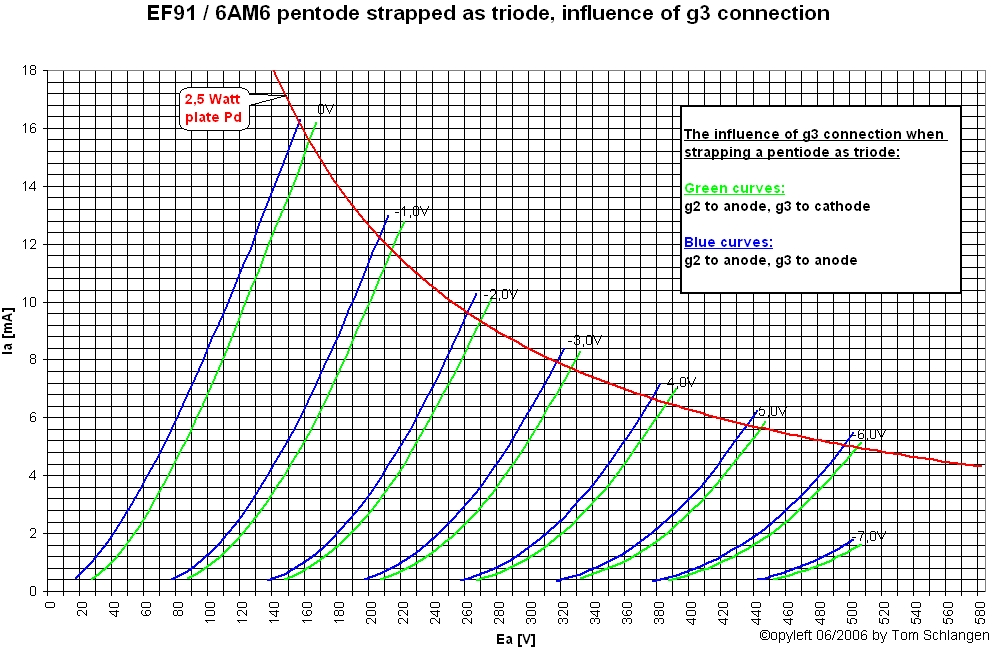

In phono and line level preamps, I've seen triode-wired pentodes wired up with the suppressor grid tied to the cathode or the suppressor grid tied to the plate (along with the screen grid).
I can't seem to find a discussion of why you'd choose one over the other. I've seen that power output pentodes or beam tubes like EL34, 6L6GC, etc. are always wired with the suppressor grid to the cathode. But 5879, EF86, etc. are often wired with the suppressor to the plate, along with the screen grid.
Can anyone explain the differences, advantages, disadvantages of the two? Are there situations where one might be preferred over the other?

This topic was discussed here. They remind us that g3 is there to deal with secondary emission from the anode, especially when the anode is at a lower voltage than g2, and stop secondaries from going to g2. If g2 and the anode are connected together, then it doesn't really matter which electrode catches the secondary electrons. So the original purpose of g3 has gone.
It is usually a fairly open grid, with little effect on the electron stream, so it doesn't matter too much for small signal valves. For power valves there is the complication that g3 is not designed to dissipate any power so it ought not to be used for catching electrons, so connect it to the cathode.

the difference of g3 connection when triode-strapping a pentode or BPT will be nothing else but a horizontal shift of the curves, see attachment below, which is from my ETF06 lecture on triode-strapping pentodes and BPTs. You can get the very same effect just by changing the g1 bias voltage a little bit.
The g3 dissipation argument is void, since it doesn't consider the true area ratios of anode, surpressor and screen. As an approximation, just divide the allowed anode dissipation by the anode/g3 area ratio and you will see how low the power load of the g3 will be when strapping it to the anode. IOW, you just don't need to care 🙂

As you can see, curves are not gust shifted. Less uniform control structure causes less smooth transfer function, that you can see analyzing harmonics.
Please note how small the change is. The difference in anode current when changing g3 connection is well within manufacturing tolerances of the same tube, connected the same way. Hence transfer function change and harmonic spectrum change also will be in the same range as expected by manufacturing tolerances. For all practical purposes, it is just a minor anode current shift (caused by the g3 area added to the effective anode area at the same potential).
If you have made systematic analysis of transfer functions and harmonics in this context under discussion and still think otherwise, please publish your results and explain their relevance compared to changes caused just by manufacturing tolerances. I would be most happy to learn more about it and I have no problem being corrected.

If you look closely at the righthand side of the graph, it shows that curves are just slightly steeper, in other words, more transconductance. However, for 99% of all pentodes the difference is truly minimal. One that comes to mind where the difference is a few % is the 12Zh1L 'universal' pentode (RL12P2000 clone IIRC?).
