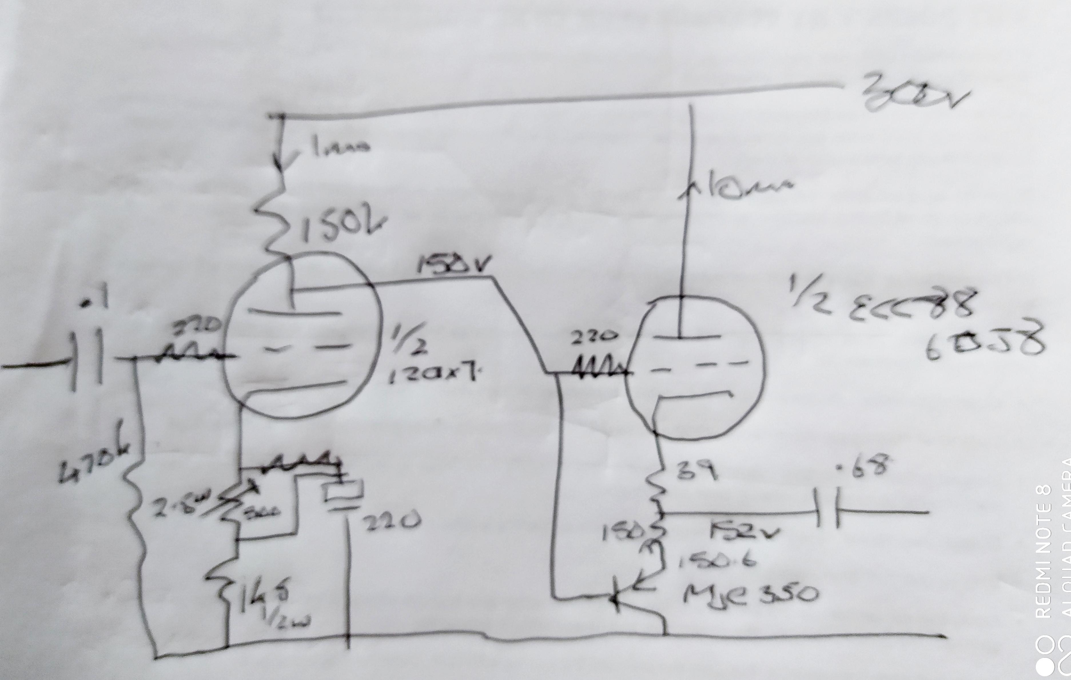

I am in the middle of designing and building a parallel 6L6GC SE amp but would value opinions on whether to use a 12ax7 as a conventional voltage amp with cathode follower output or to use a Mullard M8100 pentode (aka EF95 6AK5, 6P1) only (no separate cathode follower.)

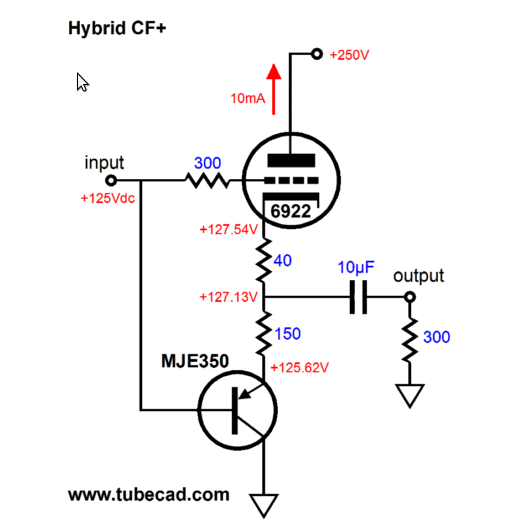

Hybid CF
I've only have 12AX7 and M8100 in my box of bits but can always buy a different (higher current) triode for the CF. (eg 6N1, 6DJ8, ECC88, ).
What about a hybrid CF from https://www.tubecad.com/2011/08/blog0212.htm

Or you can try the ECC83 as anode resistor loaded dc coupled to another half cathode follower - you will eliminate one signal coupling cap which is absolutely unnecessary.

Transistor in the cathode acts like a CCS?
By the way I would add protection diode, anode to grid of second tbe and cathode to cathode. For protection of the tube when turning on.

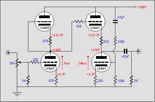

If you will buy ECC88s I would use simple gain stage or simple one SRPP as it will do the job quite nice, no need for bigger complexities.
I thought of the first picture only when you will want to use the 12ax7s.

I am not qualified to say whether its acting as a ccs or not. The tubecad blog doesn't say so. The distortion spectrum is very good compared to an 'ordinary' CF.
"The test was 1Vpk a@ 1kHz into 300 ohms. Yes, the hybrid CF+ offers lower distortion, a lower Zo, and higher gain (a closer approximation to to true unity gain). Yet the hybrid CF+ has no less a single-ended sonic signature, as the above graph reveals."
Not acting as a ccs. More like a push-pull totem pole arrangement. Notice that the signal goes to the base of the transistor, so the current is variable with the signal rather than constant.
