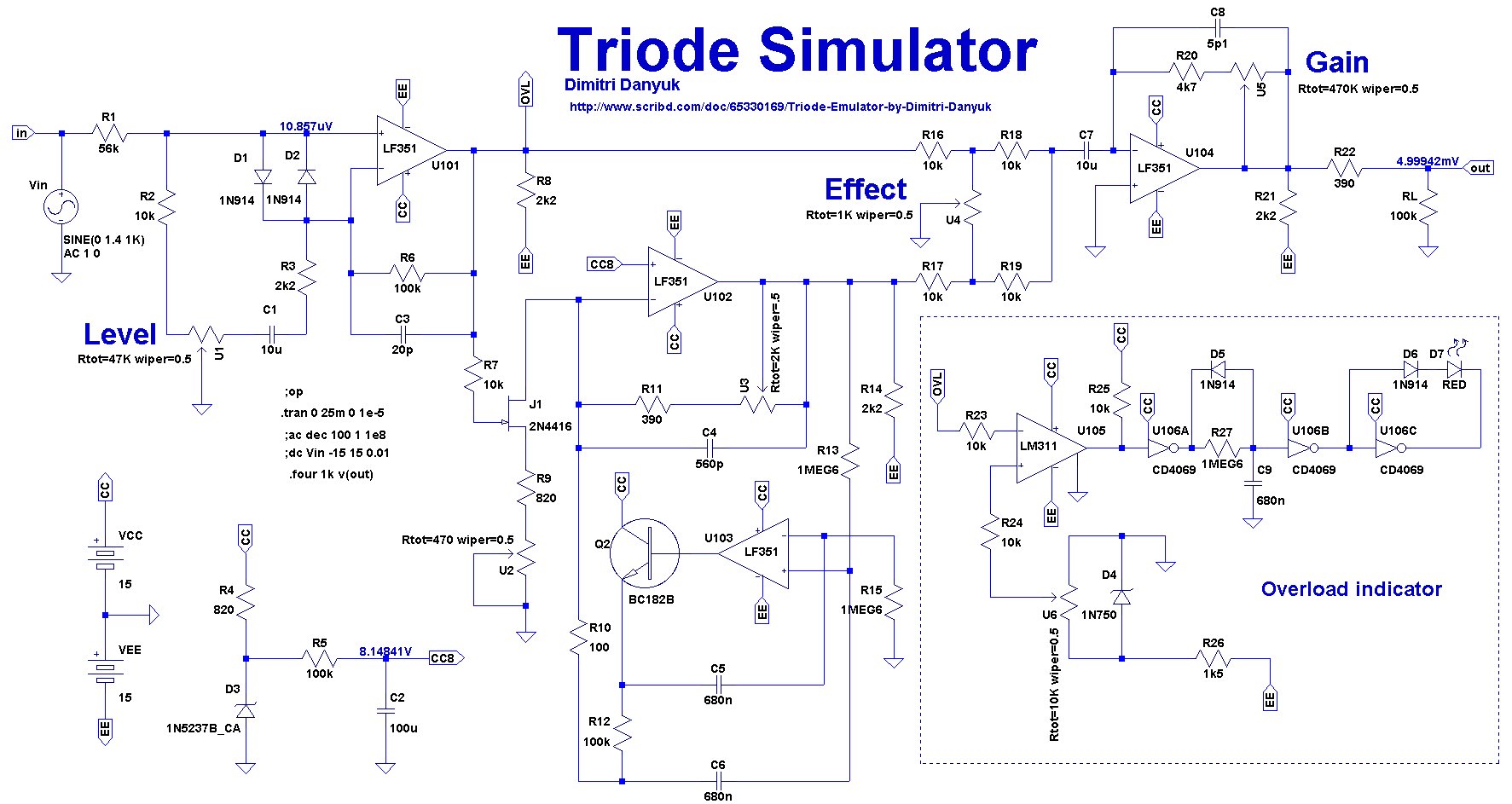

In my travels on the information super highway, I came across this gem. It emulates a triode using silicon, with nary a piece of glass in sight.
Triode Emulator by Dimitri Danyuk
I was in two minds on where to post this thread. The silicon guys might ignore it and the tube/valve guys might regard it as heresy.
Nevertheless, it has attracted very little attention and I was wondering why. It seems like such a good piece of research. I mean, it was accepted by theAudio Engineering Society for their 2004 convention. It has only been mentioned in passing on this forum.

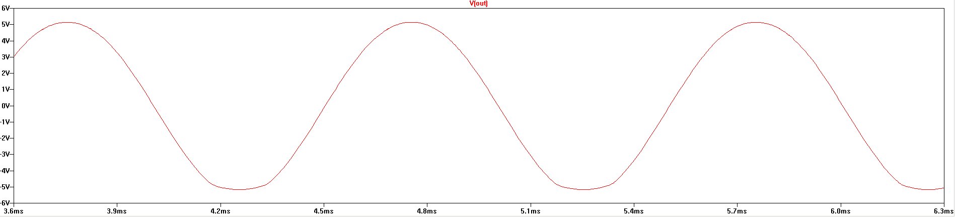

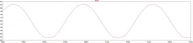

I have run the circuit in LTspice and it works as advertised. The clipping behavior resembles that of a valve amp.
Any thoughts?

It is not as bad as it looks - Dimitri explains it very nicely in his article. Click on the title in my post and all will be revealed. 😉
U101 is an inverting amplifier with adjustable gain. The output feeds into an overload indicator which is an opamp comparator with some digital logic to make an LED flash when a pre-adjusted voltage is exceeded. The FET J1 is where it all happens. The bias current is set by U2. Its non-linear current transfer function is converted to a voltage by U102 and U103. The distorted signal is than added to the normal one by U104.
The input stage is set by the Level control. Effect controls how much of the distorted waveform is added to the non-distorted one. Gain sets the output level. Pretty neat!

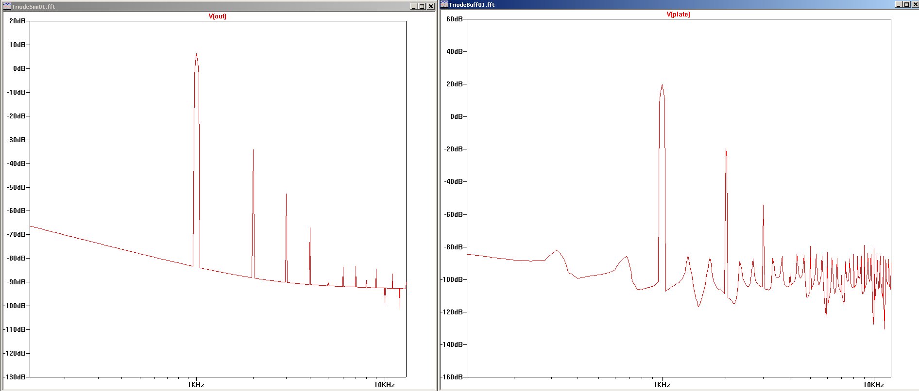

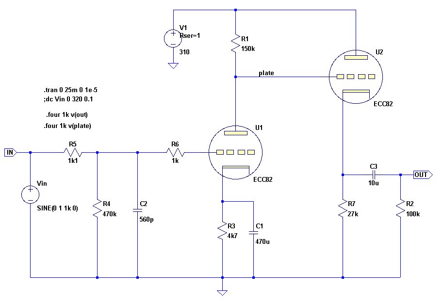

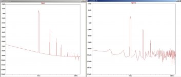

To find out just how similar the distortion is, I ran a SPICE simulation on a simple all valve circuit. The FFT of the Danyuk circuit output voltageis on the left and that of the plate voltage of valve U1 is on the right. Both signals are 1kHz with input voltages tweaked to give about 1% THD. The output voltages are very different but there is more than a passing resemblance. Perhaps not a very scientific comparison but I can't think of a better one right now.

One thing to keep in mind is that small signal triode distortion is very circuit dependent. Many people achieve <0.01 % THD under small signal conditions.
So, what is one trying to emulate? Small signal triode distortion? DHT output tube distortion in SE amplifier?
