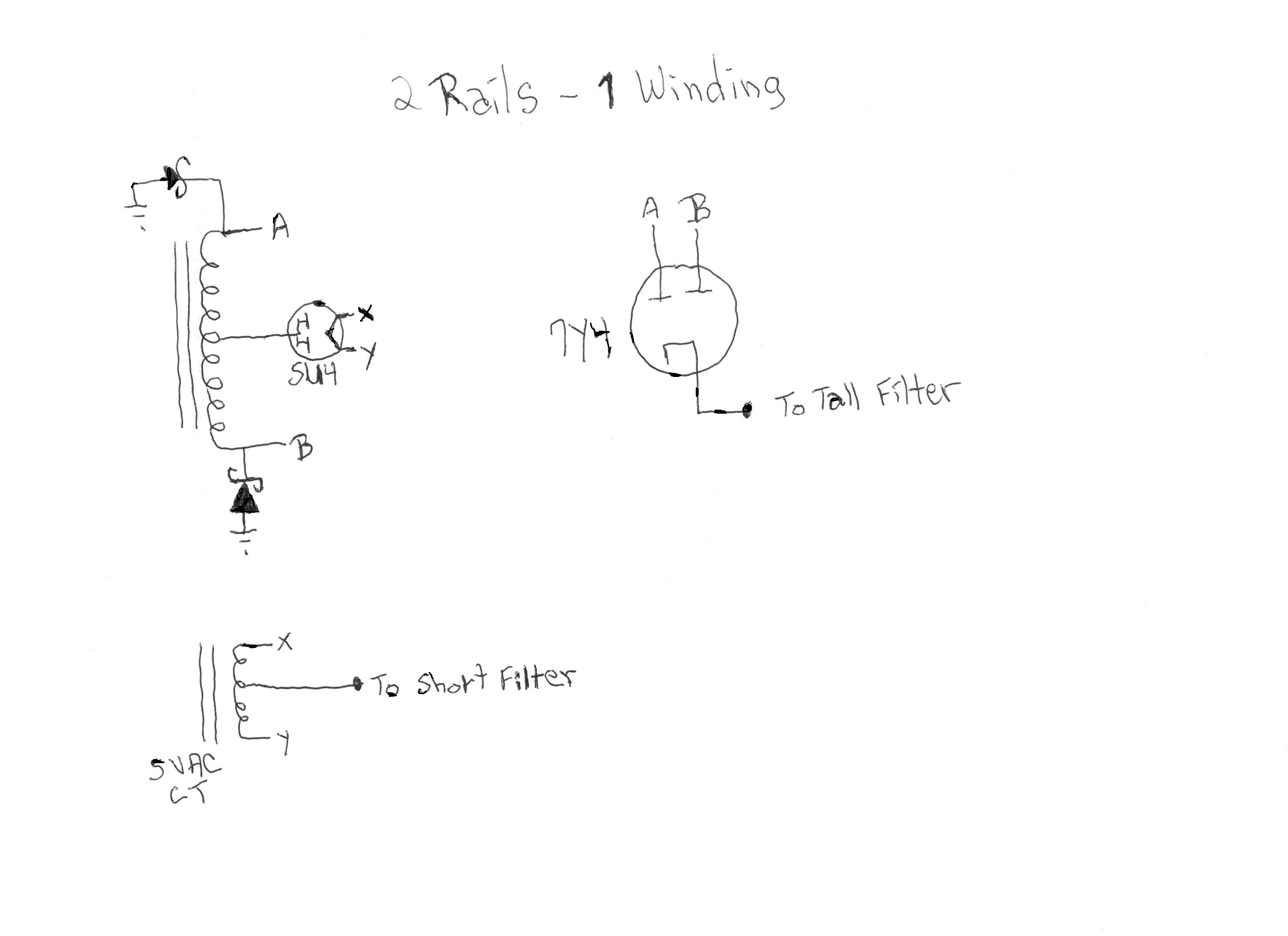

Only the "concertina" and LTP are currently in favor. Search the archives for the rationale. A "concertina" splitter exhibits an insertion loss. Therefore, you must improve your LTP's behavior.
There is no getting around the 1/2 μ gain limit, when only 1 LTP grid is driven. However, you can approach that limit by using large anode load resistors. That, in turn, requires a very "tall" B+ rail voltage. You can use the concept of 2 rails from a single CT winding that I've uploaded to feed the LTP with a "tall" B+ voltage.

Keep the triode section of the 'LR8 as cathode follower grid drivers. You can get the gain either from an LTP made from small signal pentodes (6CB6, or 6SJ7) or use two triode LTP's: 6SL7 up front -> 6SN7 (2nd pre). Cascode 6BQ7s also work as an LTP, but the signal swing is rather limited, as this is a cascode connection, and less useful if you don't have the necesary DC rail.
The third possibility is to keep the 6BH11 as is, and add an independent gain module made from a 6SL7 or 12AX7 with gNFB to get the gain to where you want it, and to reduce the distortion.
Use a triple triode Compactron and you could use two triodes as cascaded gain stages with NFB, and the remaining triode as a cathodyne splitter to drive both sides of the 6BH11 LTP as a balanced-balanced gain stage, thereby doubling the voltage gain.
