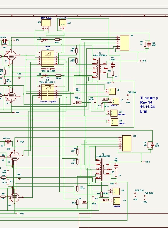

My attempt at adding a switch to change states from Triode to Ultra.
Note switch is a dpst in the Triode position with RL1 closed.
Any comments are welcomed.
