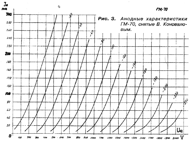

But the GM70 are not very good in my opinion, I tried in practice several points with 6 GM70s in my amp and are not consistent with the model currently used. However they are very consistent with the one provided second.

Well, may by it is a question of matching to some or other characteristics available. I've checked compliance with the characteristics on which I based simulations and it seemed to be quite good. Maybe I should consider more than one model for the specified tube.
