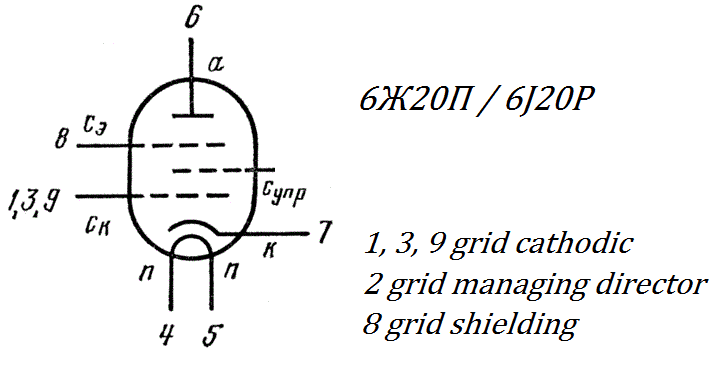

In Russia, this kind of **** in the audio is not used.
Why? kindly elaborate ...i just wanna to know since i have 10 pcs of this tube and trying find out where it can be used...
Can you suggest some good russian tubes that are not so common like 6N8s.6n6p and etc..
can you tell me the analogue of the 6zh20 with european/american tubes?

thanks charm,,,but you did not answer why it can't be use for audio..
Because here is offtopic.thanks charm,,,but you did not answer why it can't be use for audio..
Pentodes with a cathodic grid 6Zh20P, 6Zh21P, 6Zh22P, 6Zh44P of these lamps didn't receive broad distribution. 6Zh44P some time it was applied in UPCh of a sound of TVs of the third class, in the reflex scheme - at first I strengthened sound PCh, then I carried out a role of the LF powerful amplifier. Thereby all path of a sound was executed on one lamp. Ho "capriciousness", characteristic for lamps with a cathodic grid, because of impossibility of full stabilization of the mode the resistor which is switched on in a cathode chain and also
low quality of a sound of such reflex cascade, led to that soon the scheme was replaced on more traditional.
In my opinion I gave at once the answer short and exact. If the lamp was good in audio, all would apply.

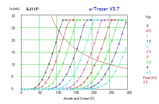

I like the look of 6J11P (6zh11n) in triode:
Yes, I just used it in my 6C33C-B SET as driver and got a good result...i did ARTOSALO'S GYRATOR LOADED 6j11P_E WITH 350V B+ AND PLATE AT 170V.
